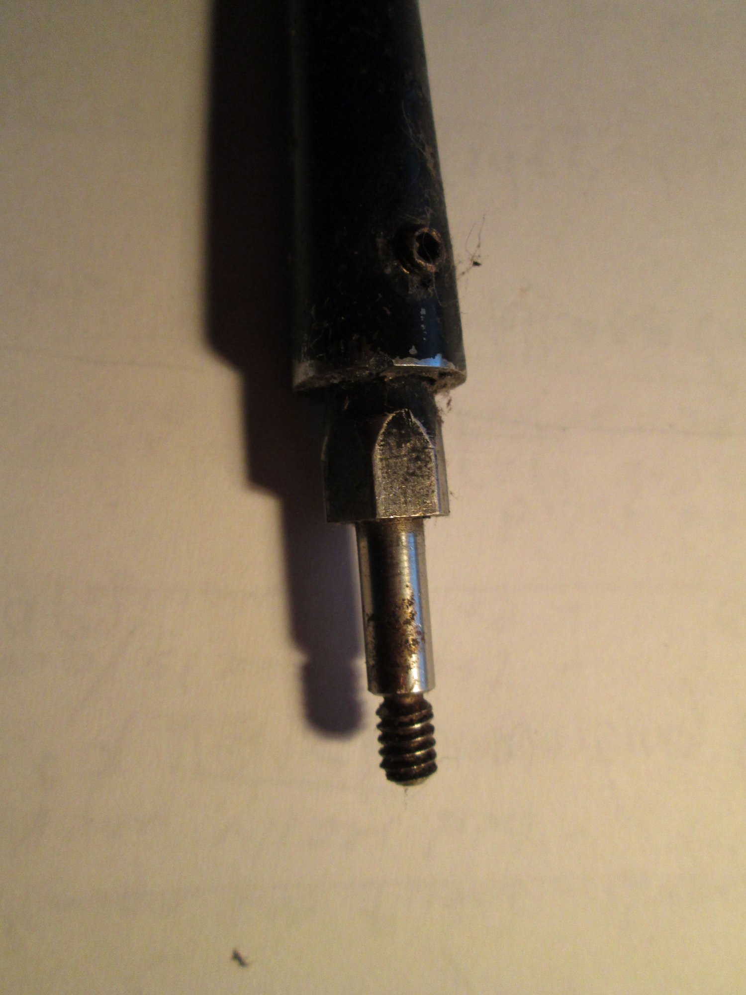

Old Oct 10, 2016 | 08:53 PM
Filthy Beast's Avatar
Filthy Beast
Joined: Mar 2011
Posts: 2,698
From: Taxachusetts
Originally Posted by twofifty
Could you post a picture of the '79 screw-on antenna you're referencing? I've been trying to find out if my antenna is original since I bought my truck and may be the style you're referencing.
Been late getting back home these days and the pictures were taken in the dark..... from my '79 F250 4WD:
Taken in the dark, looking toward the driver's side...antenna off, yes the chrome is shiny...
Looking toward the rear.
Screw in antenna....Yes, that is an allen head.
