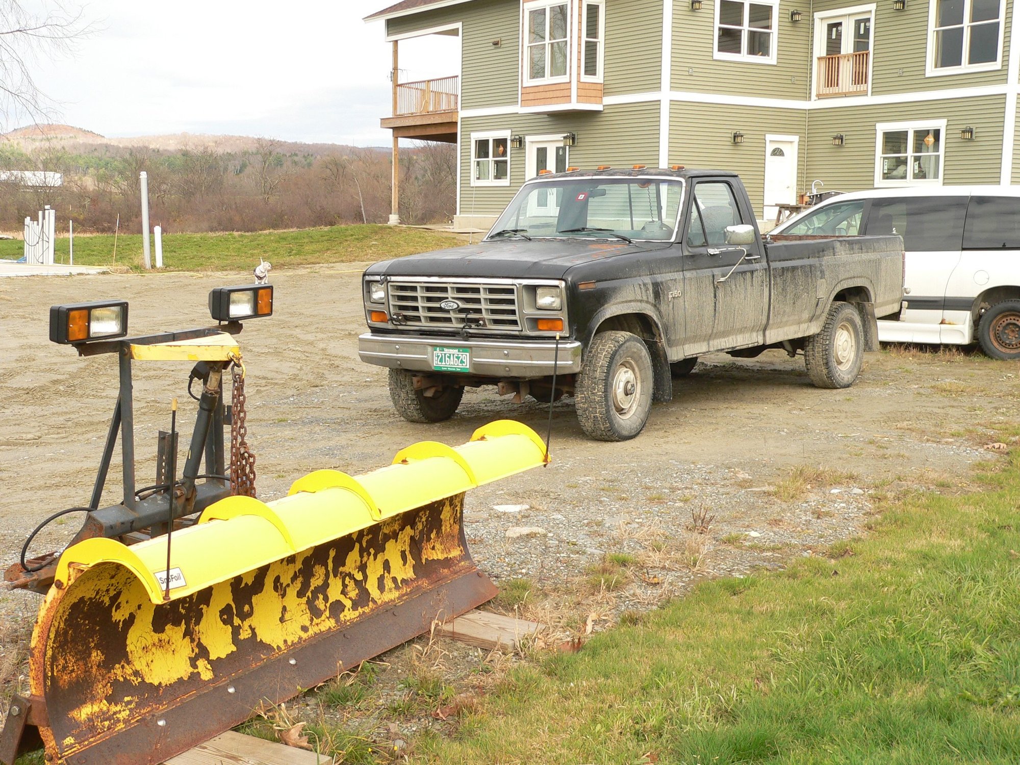

So, my old 1986 f-150 (that I paid $1000 for including a plow) is still running ... a 30 year old daily driver! The straight six ... that is very noisy ... is still running after 3 years (when I bought it, I was not sure it would last the winter), still plows snow and even still passes a safety inspection (not much to look at but solid)!

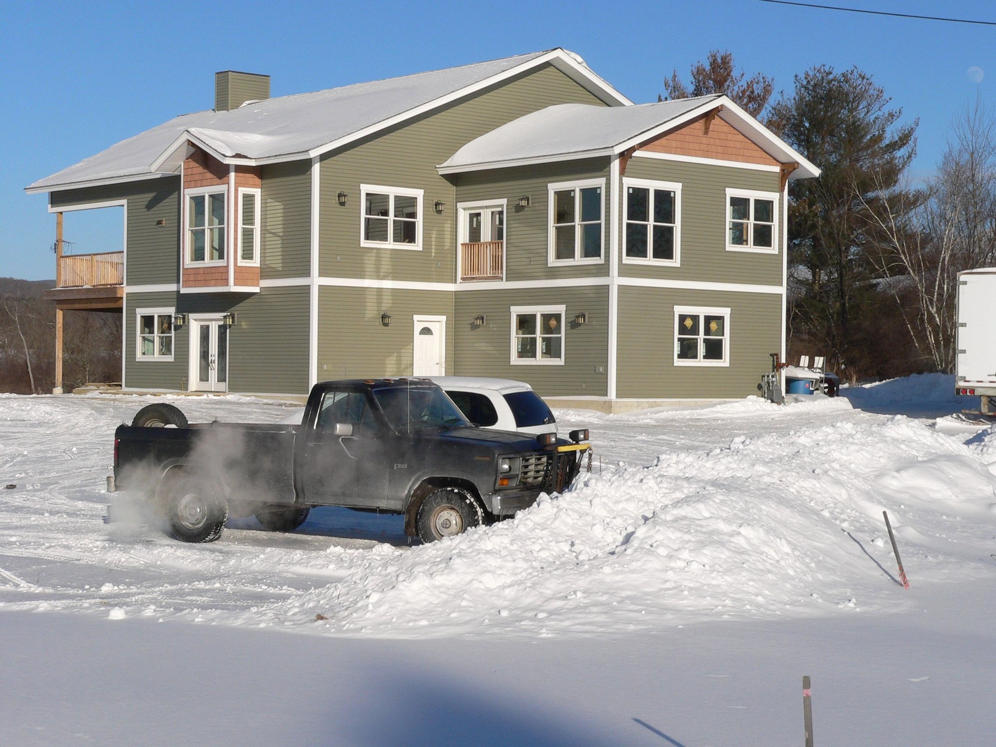

Exactly why I have not changed it ( or the ignition ) yet. I have been fixing things as they need it. I don't want to put money into it for the fun of it. I just want to make sure it is reliable. We did not have much snow last year but the year before I used this old truck at least twice a week for about two hours of plowing ... that's a lot of snow.
I also am planning to finish building my new workshop in the spring. We just got through building the house (hope to finish a lot of the interior work this winter) ... took 3 years.
I have a 3000 sq ft pad of reinforced concrete poured (nature gas line, water and 200 amp power feed already feeding the pad). I ran out of time but this will be the project for next spring / summer.
Thus I want to keep the old truck running .... more important things to put money into than a new one.
Thanks so much again!!!!!
Old Oct 5, 2016 | 06:08 PM
WhatsAChevy?'s Avatar
WhatsAChevy?
Joined: Jul 2015
Posts: 2,239
From: Northeast Ohio USA
Sharp house, sharp truck and cool plow. We did the same thing a few years ago that you are doing now. Bought the land, leveled it ourselves and built the house. All while trying to keep the vehicles alive! A solid year with mud for a 2 acre yard with four dogs....what a mess. And BTW, i have a recently purchased plow that was fitted for a (cough) chevy that needs to be fitted to my 84...lol. Hang in there ! It does get better, much better. I'll never take on a car/truck payment again.
