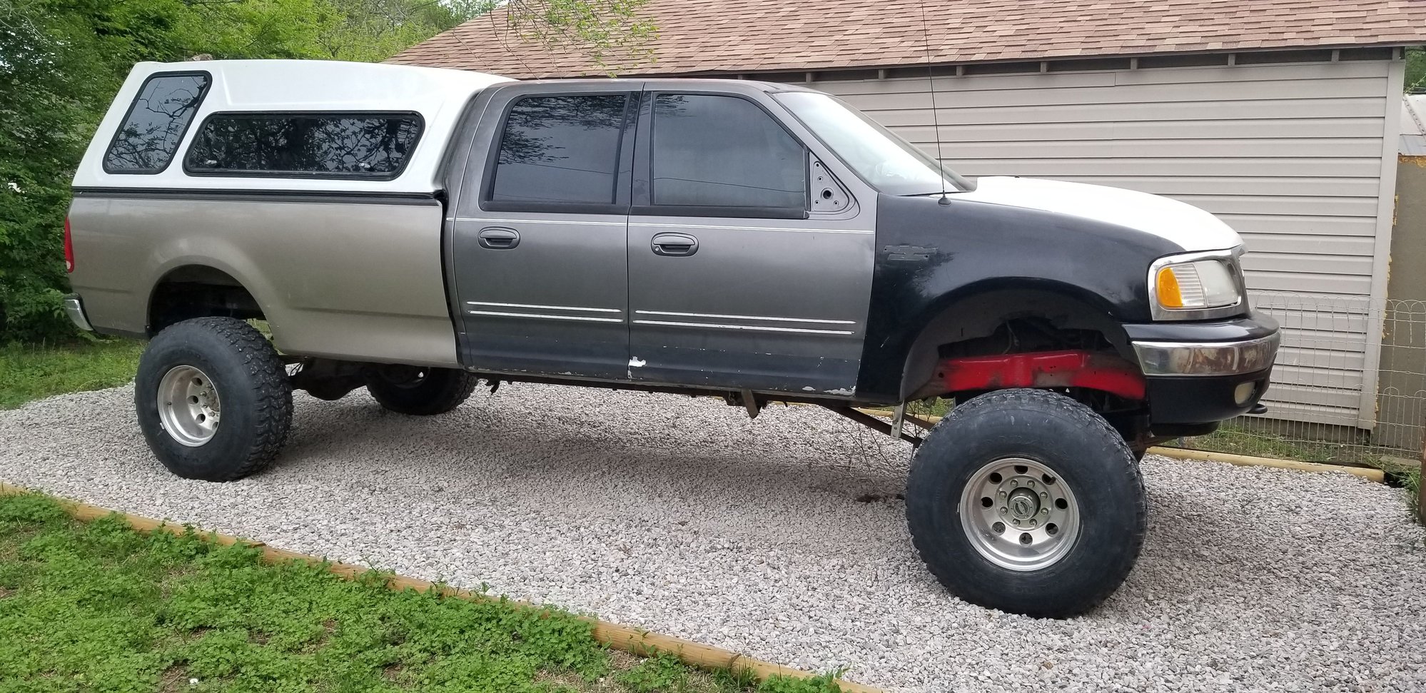

Old May 6, 2018 | 07:48 PM
  #82
mybloodisblue's Avatar
mybloodisblue
Joined: Oct 2014
Posts: 154
Likes: 18
So I've been slacking on my truck again ...I've done some small things changed the grill shell and bumper to chrome ones I got leather navigator interior bucket seats and center console front and rear ...and I got a gravel parking spot in my back yard so it is in it's own spot and happy till I get back on it ...which I'm hoping is soon...but I'm currently out of work and projects are not possible

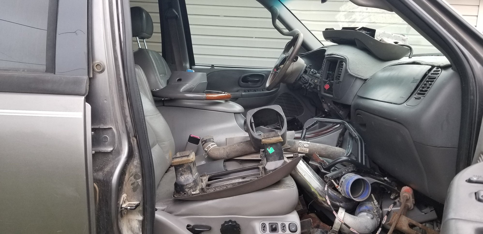

Actually the only progress that I can report is I took the topper off ...emptied the bed out (parts and extra metal) I took a bunch of stuff out of the inside and .
thought I was going to work on it but honestly I still have done nothing ...I could say money/time/kids/wife is the cause . but honestly I dont know why..
I've kinda finished 4 vehicles in the last 6 months and I've repaired both daughter's cars ..I cant say I'm lazy ..I have not lost interest ... sorry for being lame I'll work on it hopefully soon

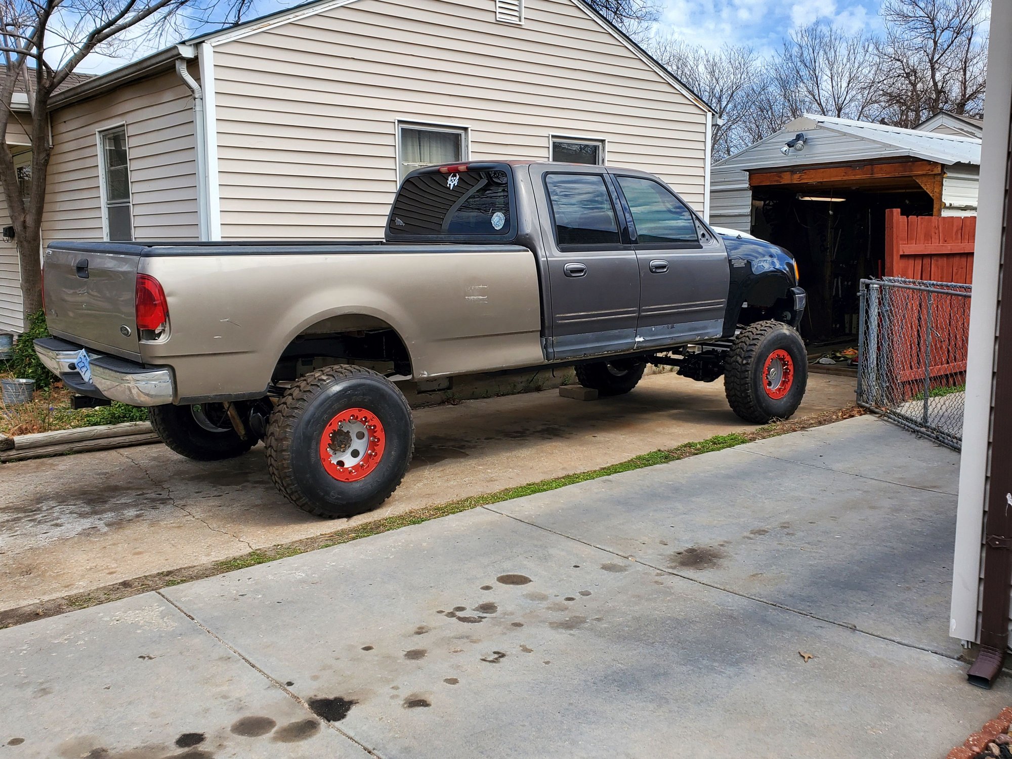

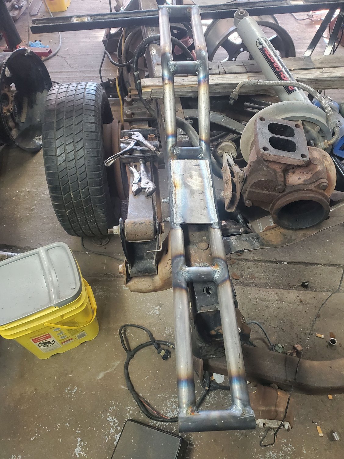

Old Mar 29, 2022 | 07:07 PM
  #87
mybloodisblue
Joined: Oct 2014
Posts: 154
Likes: 18
Just thought I'd update that I have been working on my truck I removed the cab and bed boxed the frame finalized all the leaf spring mounts did high steer and cross steer with 3/4 hiems I got energy suspension body mounts built a new tubular transmission crossmember I got custom hummer beadlock wheels and new 37 inch military tires and got the cab back on yesterday and bed back on today (bed is not bolted down ) so I can get to the fuel tank easier I am working on the truck full time currently (everyday) so I will upload more pictures ...my plans this week are fuel lines rear shock mounts and radiator upper mounts maybe intercooler
