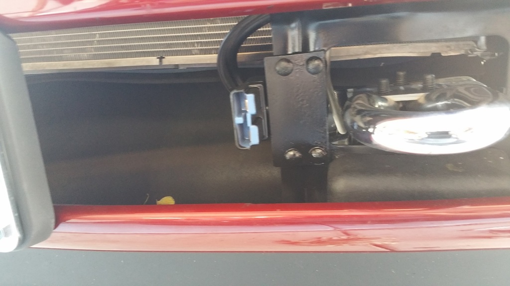

Back to the bumper and mounted the bracket and plug with the 1" carriage bolts.

Test the connection and verify we have power.
