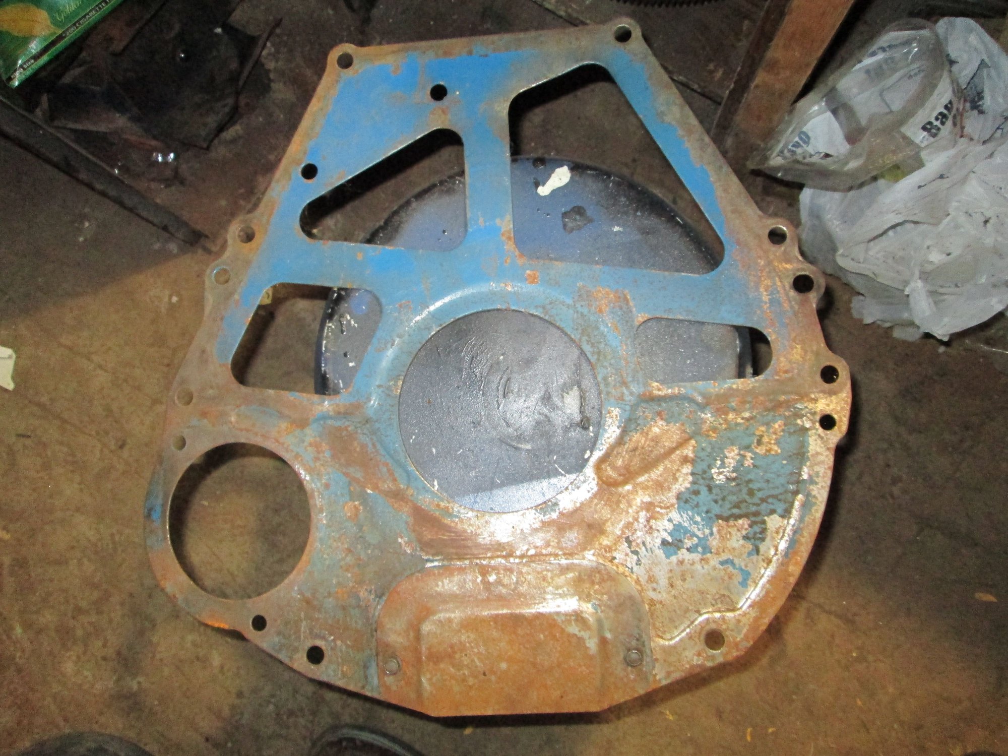

Robbie58;
A dumb question: You did put the block to bell metal separator plate on, yes? It looks like this:
351M/400 block to auto trans separator plate.
Rbeck204 (Rich),
The same dumb question from me to you also....pardon my asking....just trying to get the facts.....
Old Sep 23, 2016 | 07:34 PM
Rbeck204's Avatar
Rbeck204
Joined: Nov 2013
Posts: 150
From: Sacramento
Yeah, I put the block spacer on. Keep the suggestions coming. No such thing as a dumb question.
