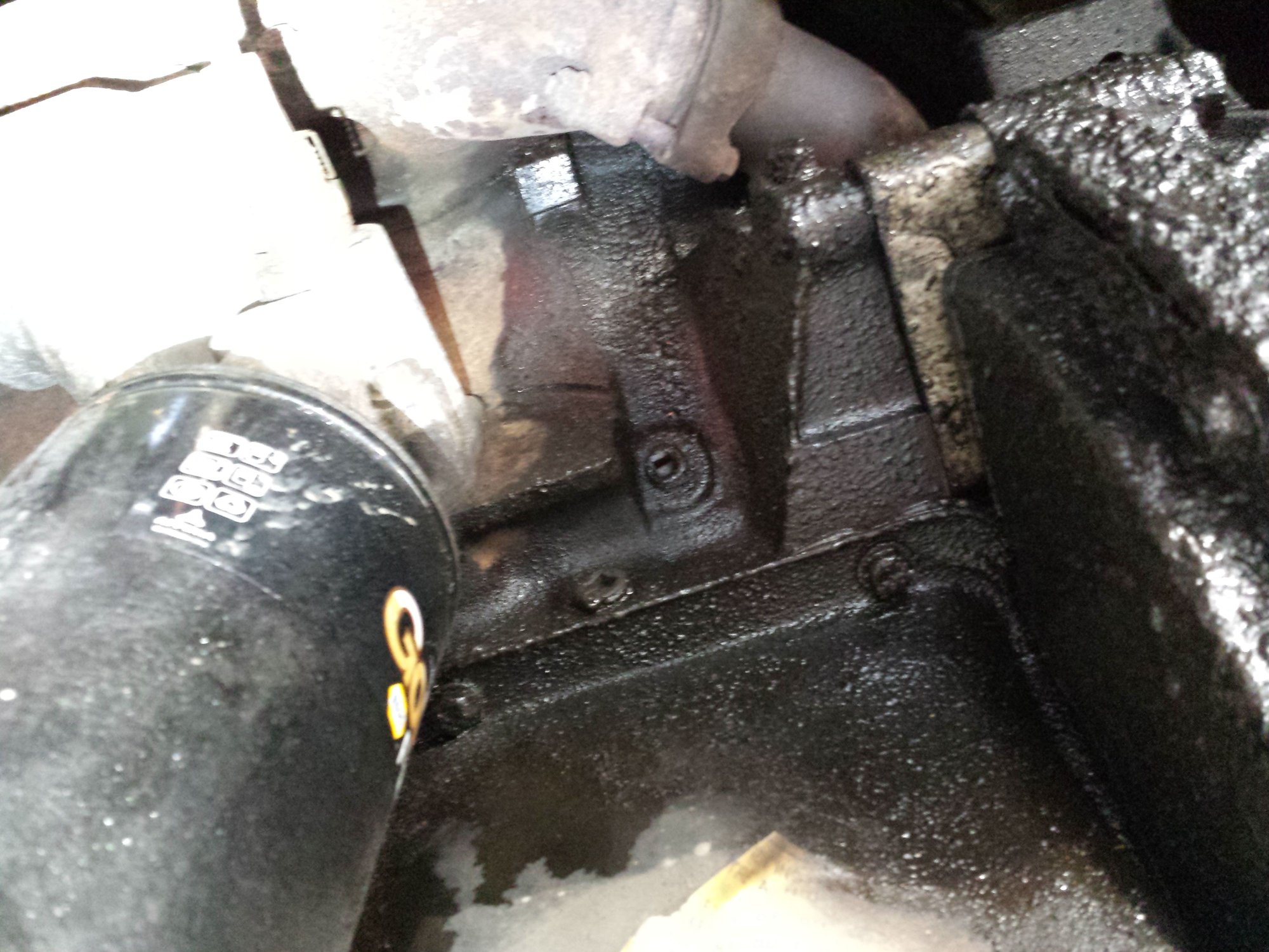

So I went down to see the truck today. Wow is it clean. ****ty part - Phone died in the middle of my inspection, but I'll cut to the chase. Like I said, no rust on the truck it was very clean, except there seemed to be quite a bit of oil around the oil pan and as well as possibly dripping down from the rear passenger side of the engine. Here were the pics i got
driver's side/ rear of the oil pan
driver side/back side of the oil pan, (for orientation sake - see oil filter in the center/bottom of the pic)
passenger side
drivers side, oil filter, pan etc
