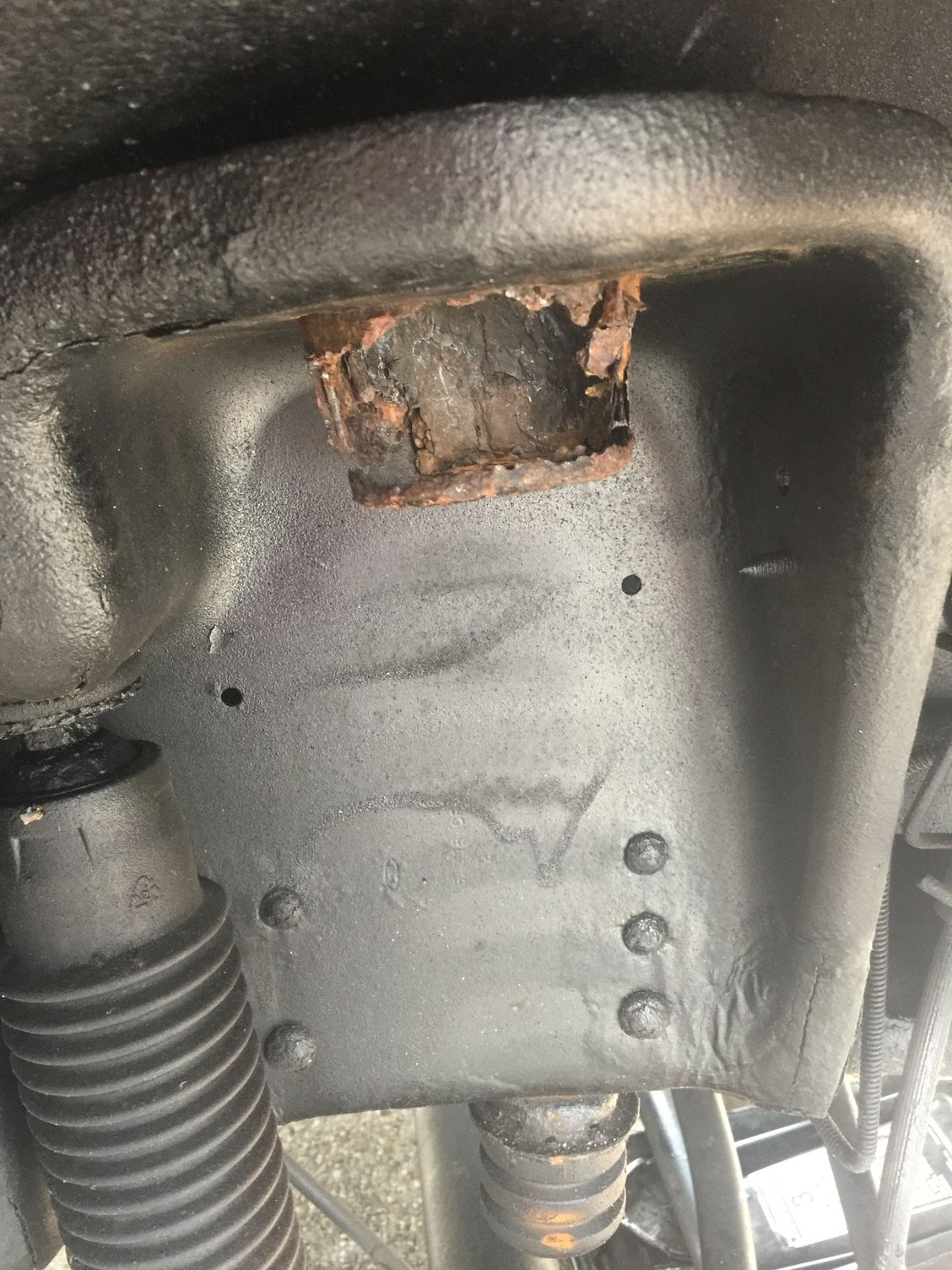

I was replacing shocks and adding a leveling kit this evening and ran into a hiccup.
When I pulled the coils on my 2005 F250 Diesel the top insert just crumbled. Anyone know what this is? Does it come as a piece in the coil bucket? Best place to buy one?

Ouch, looks like it was initially a separate piece but then in was welded to the whole assembly. This is an old post but a good pic of what you're looking for. 2005-2012 F250 coil buckets with spring isolators - Pirate4x4.Com : 4x4 and Off-Road Forum

These rust pics still surprise me, I've lived just outside of Phoenix AZ my whole life. People here fake rust on their old rat rod because it's just not available.
