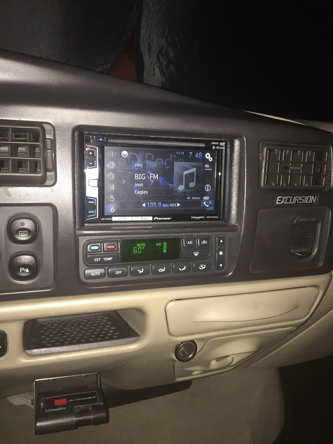

I'm in the process of installing a pioneer double din. I'm down to the parking brake wire. I've searched around but only found confusing threads on this matter. So where do I connect the green parking brake wire on an 2005 Excursion? Thank you

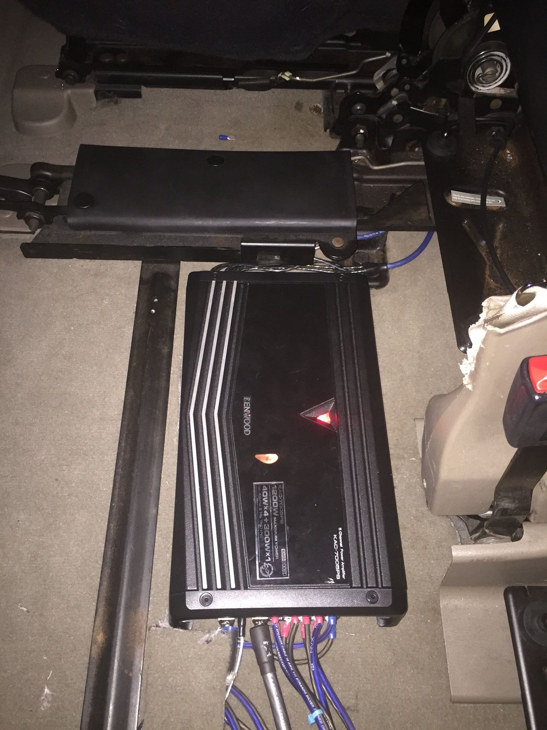

Ok so I grounded the parking brake wire and to my surprise it plays DVDs while in drive. I kept seeing all these threads about how you need a bypass kit for pioneer but for some odd reason I didn't need one.
Now onto my bigger issue. Only my A channel (front speakers) on my amp is working. I'm pretty sure I wired it all correctly. I'm using a Kenwood 5 channel amp. All four door speakers are wired up except the stealthbox sub which is going in tomorrow. Could not having the sub connected cause this?

Ok so I threw in the towel and headed over to a local reputable stereo shop. What a great decision that was. I now have all 4 JL Audio door and 2 rear speakers hooked up along with the Stealthbox, powered with a pioneer double din and Kenwood amp. Wow it sounds amazing. I've never been a sound system guy but I am now. It was well worth the $300 to have them finish it all up.
