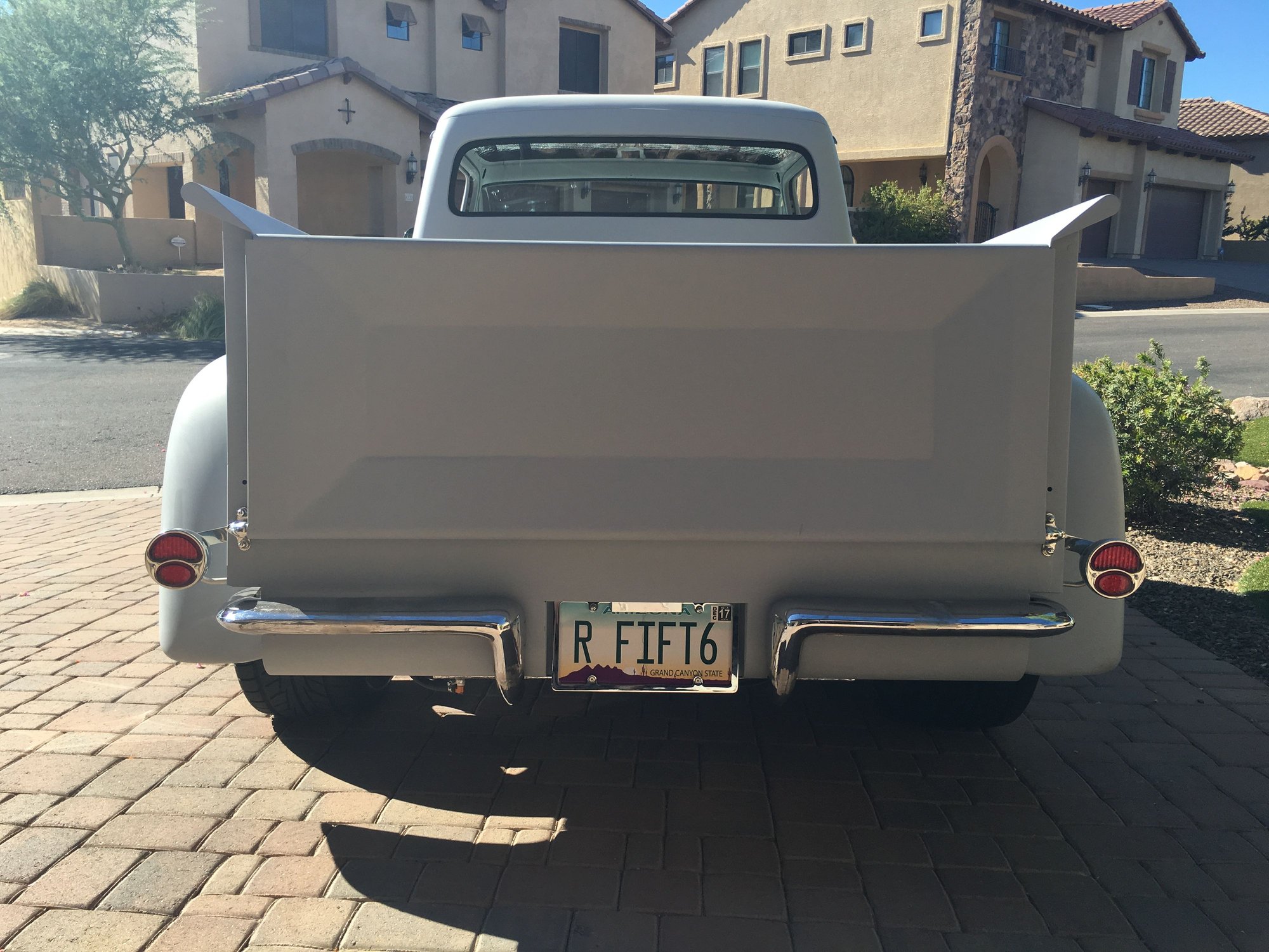

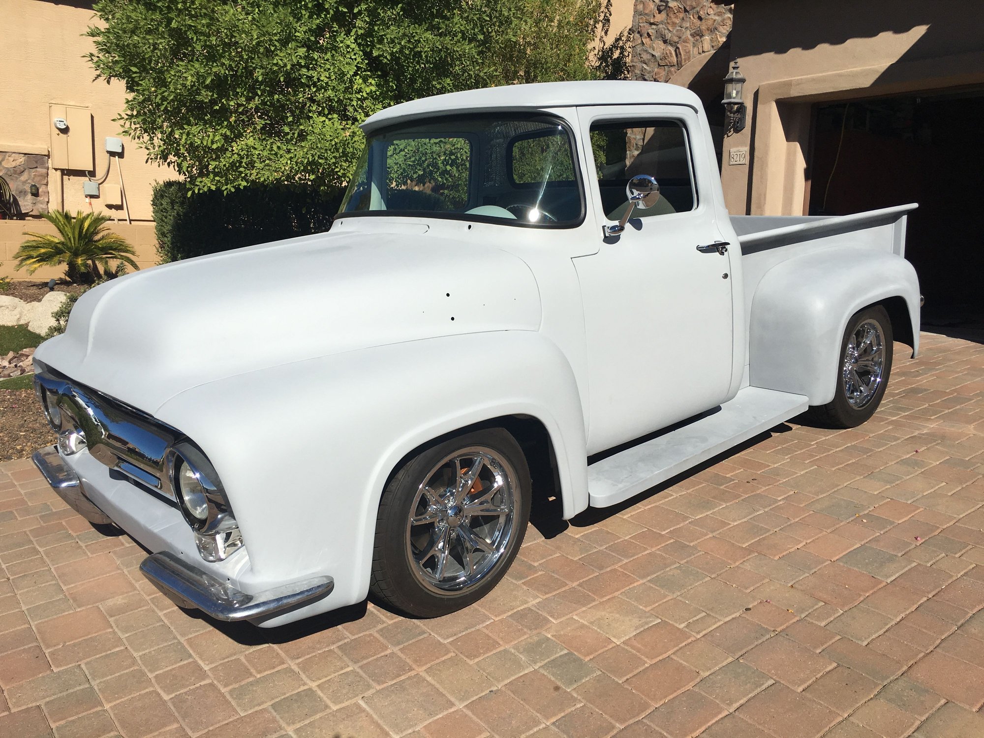

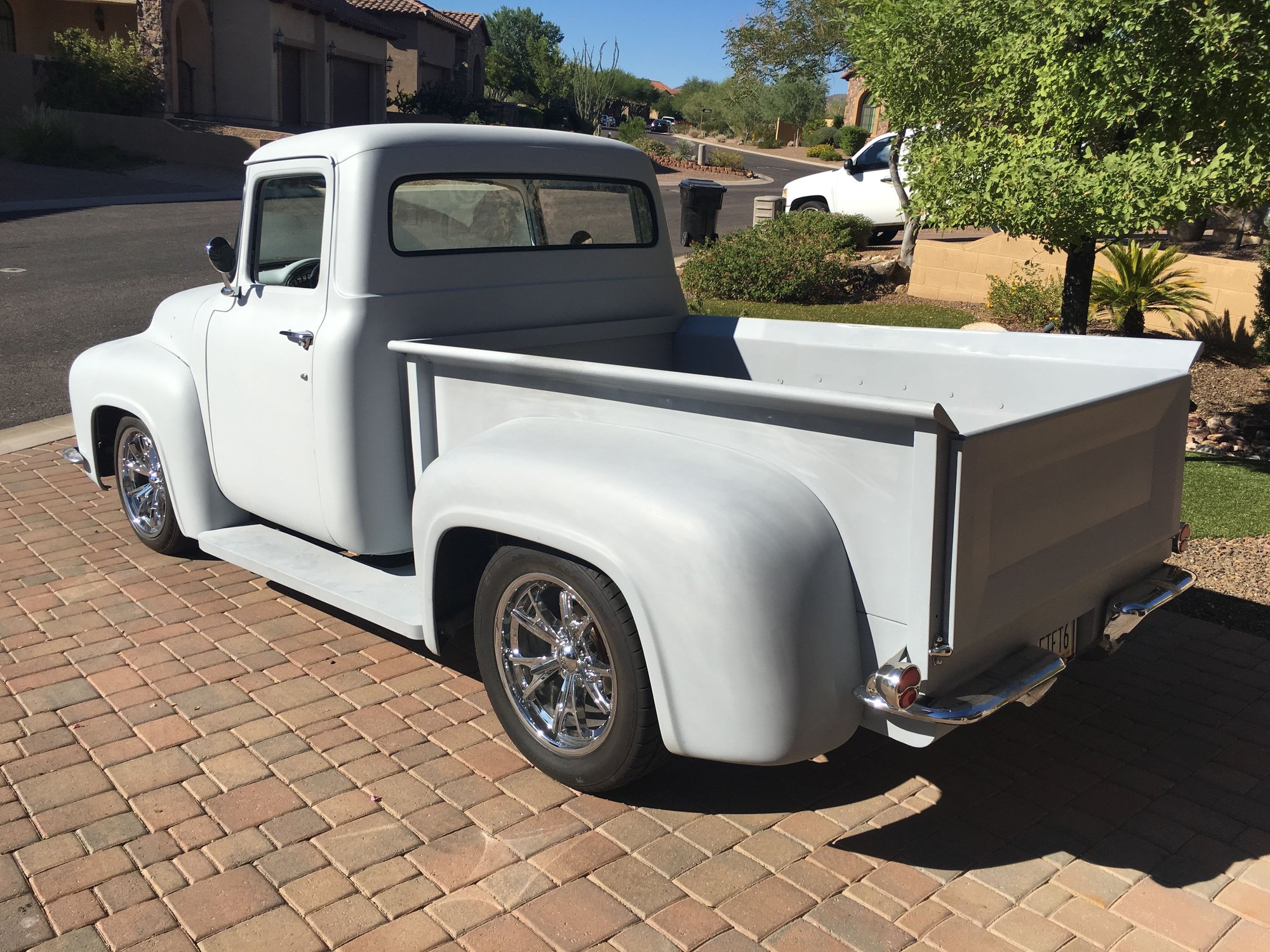

Well, its been a busy last couple months on the truck and finally starting to show! Tailgate done, running boards done, front and rear corvette bumpers done, most of the bodywork done, rusted roof gone, it has insurance, and is drivable. Love it when we all hit these milestones.. first just to get it home, then get it tore down, get it running, then driving..finally starting to see the effort pay off. been a quick 3 years!

is it in primer? what front end? how's it lowered? it's got a nice reasonable stance.

It's all in primer now. Complete Lexus front end in it with custom built mounts for a set of QA-1 coil-overs. With the Lexus ifs and the t bird irs in it it's just the way it sat. Rides unbelievable and handles good too.

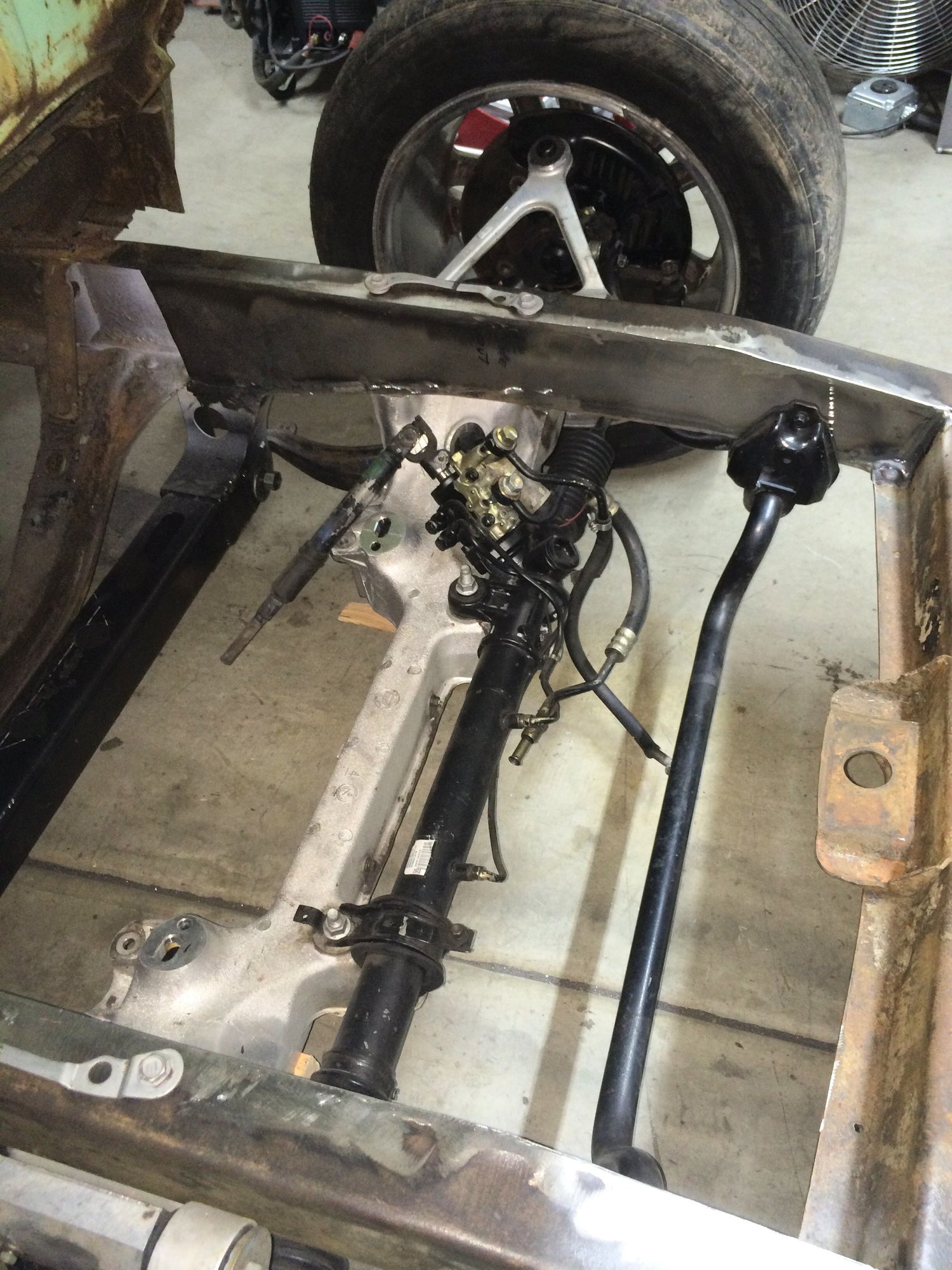

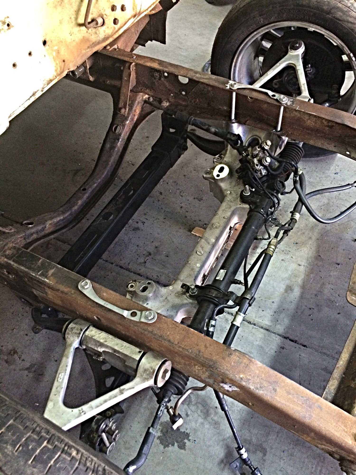

Mine was a 97 Lexus sc400. The 300 is exactly the same so it won't matter which one you find. Goes in exactly like the crown Vic without the width issues. Drill 4 holes in frame, weld in crush tubes, box frame rails, and bolt in. Only thing I had to do was fab a rear trailing arm mount, and build an upper coil over mounting point for the QA-1's . Lower ones were just the stock location on the lower control arms. Pretty cool install. Easy, cheap, 12 inch discs stock, even used the factory steering assembly, and made a hose to go from the Ford pump to the Lexus rack. Factory Lexus sway bar even bolted up to the inside of the frame rails after they were boxed.
After frame was boxed .and sway bar was attached.
Before the crush tubes went in..
Everything mocked up in place
