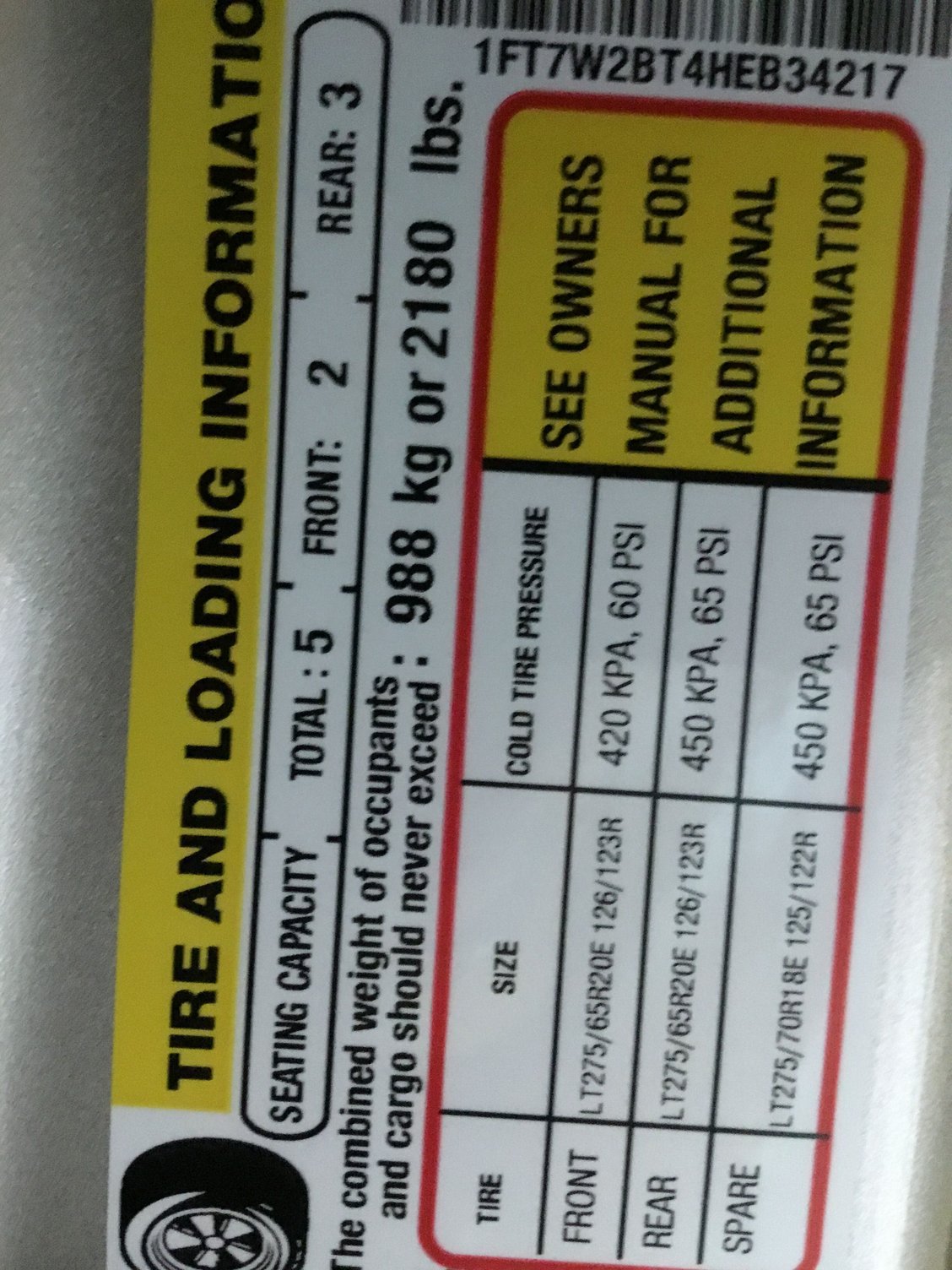

Low rating?
Does not seem like a lot as beastly as this truck is.

Load it until it almost hits the bump stops. Stickers are just a reference.

Well not to be a jerk, but what do people expect with a 10k gvw on the 250? I mean the truck is going to weigh close to 8k pounds. The listed payload is just gvwr minus actual weight.

Seems low. Same gvwr 10,000

You have the gasser. He must have the diesel which is way heavier and reduces payload

Quit frankly, Ford should not have different tire pressures listed.
Anyone can safely run 80 lbs. in their rear tires.
That is really the only difference between the capacities.
Kinda silly.

For fun I looked up ratings for my old 2004 F250, and here's what I found. 8,800 GVWR, and optioned out similar to what mine was (pretty well loaded) that would only leave about 800 lbs for payload. 800 lbs was nothing in that truck, and I don't recall ever consulting a door sticker once while I owned it. However, I think that puts things in perspective when today we're griping about a 2100 lb payload rating in basically the same truck. That certainly puts things in perspective.

The bigger difference is the 440 HP and 925lbs of torque.

Actually tires have different capacities (not just pressure). Depending on wheel and tire type also play in to that, not just tire pressure. Also the Rear axles on the F-250 & F-350 have different weight capacities. With that I would never overload my tires or axle, the GVWR is a bit more flexable.
