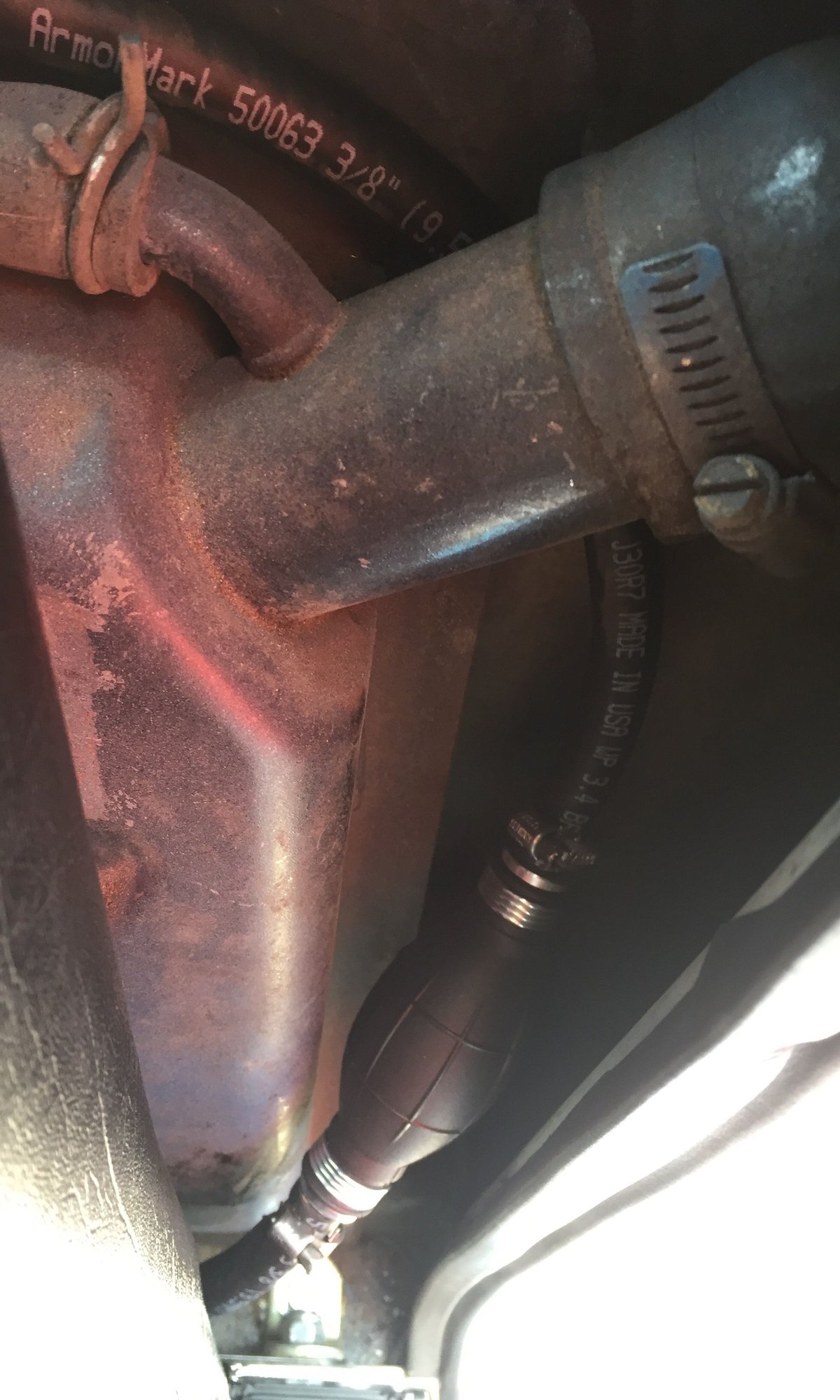

Well, the bulb pump arrived. I am impressed by the quality, as most seem to be pretty sketchy.

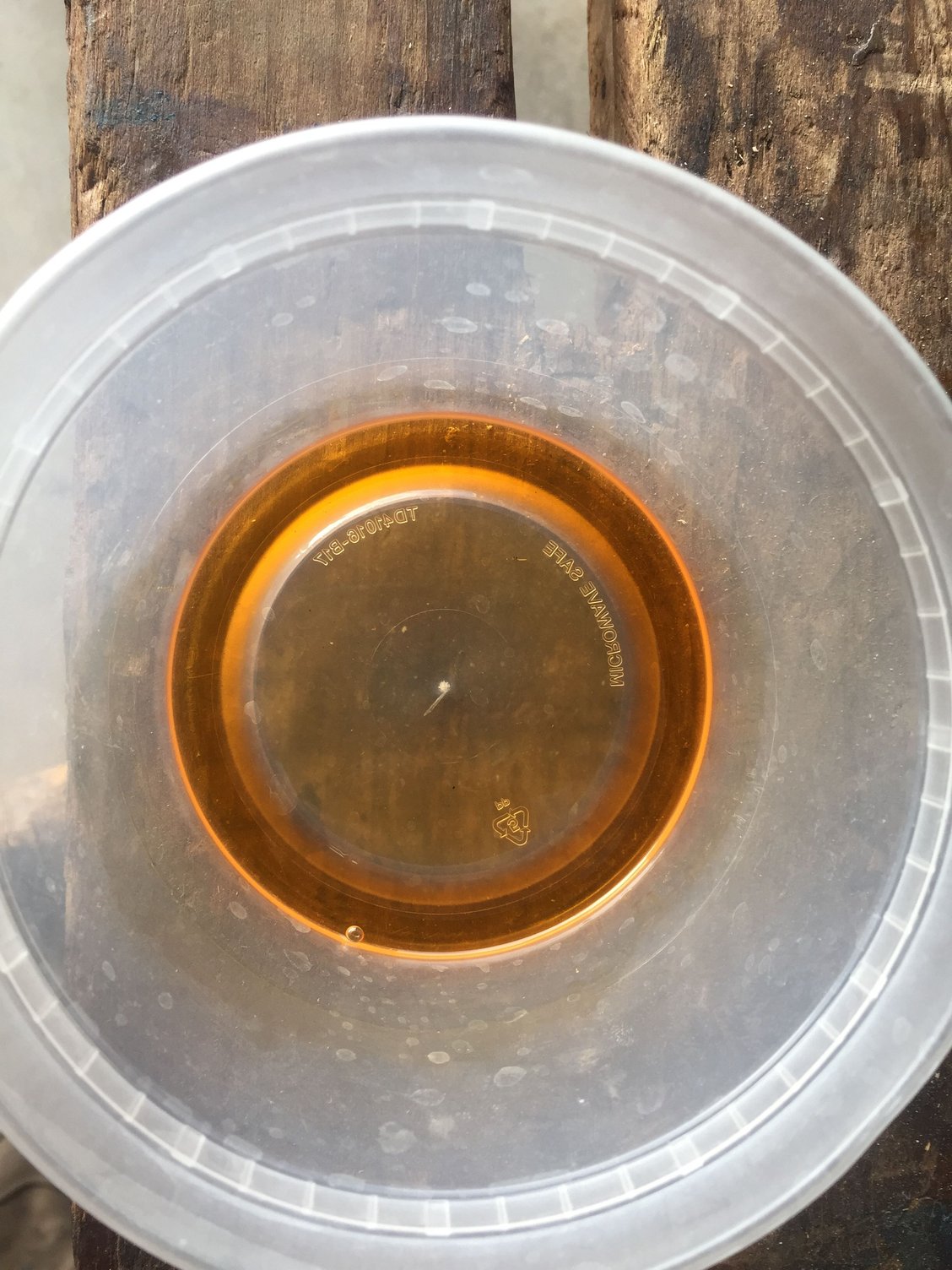

I put a clear container under the fuel line when I cut it open to install the bulb. The fuel that came out looked more like orange drink than gas. I'm guessing I dislodged some blob of Nixon-era varnish.
Once I burn the tank down, I'll try a couple rounds of fuel cleaner.
New filter shows being nearly full, where the old would just be half full. Must be flowing better already.

The tank pickup tubes our non replaceable if you look at yours, and a filter sock on the tip of the pickup tube in the bottom of the tank which can rot away over the yrs.
I seen rusty gas look like what's in the cup.
Orich
