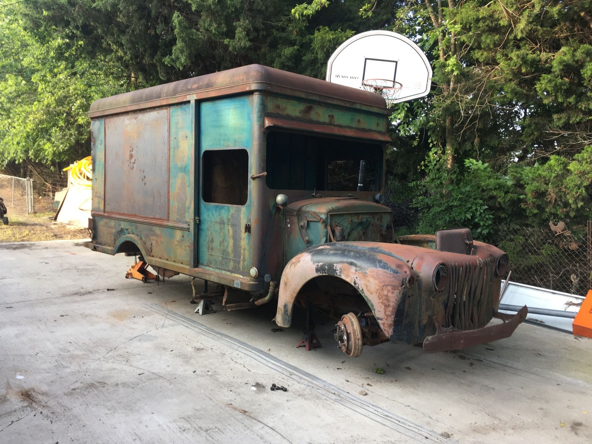

1947 Box

That box truck looks pretty heavy duty for an 8.8. I'd look for a Dana 60 or Dana 70 depending on if it is a 1 ton or 1 1/2 ton based.
Neat truck, thanks for posting pictures. What are your drive train plans for it?

It looks like an REA truck on a 122" tonner chassis. By the looks of the air deflector/hood latch panel, it was originally a six cylinder truck. I would think a Dana 60 would be better than an 8.8". I believe you could use drums off of a '48-'52 F2-F3 on the front and have 8 hole wheels all around. Cool truck!

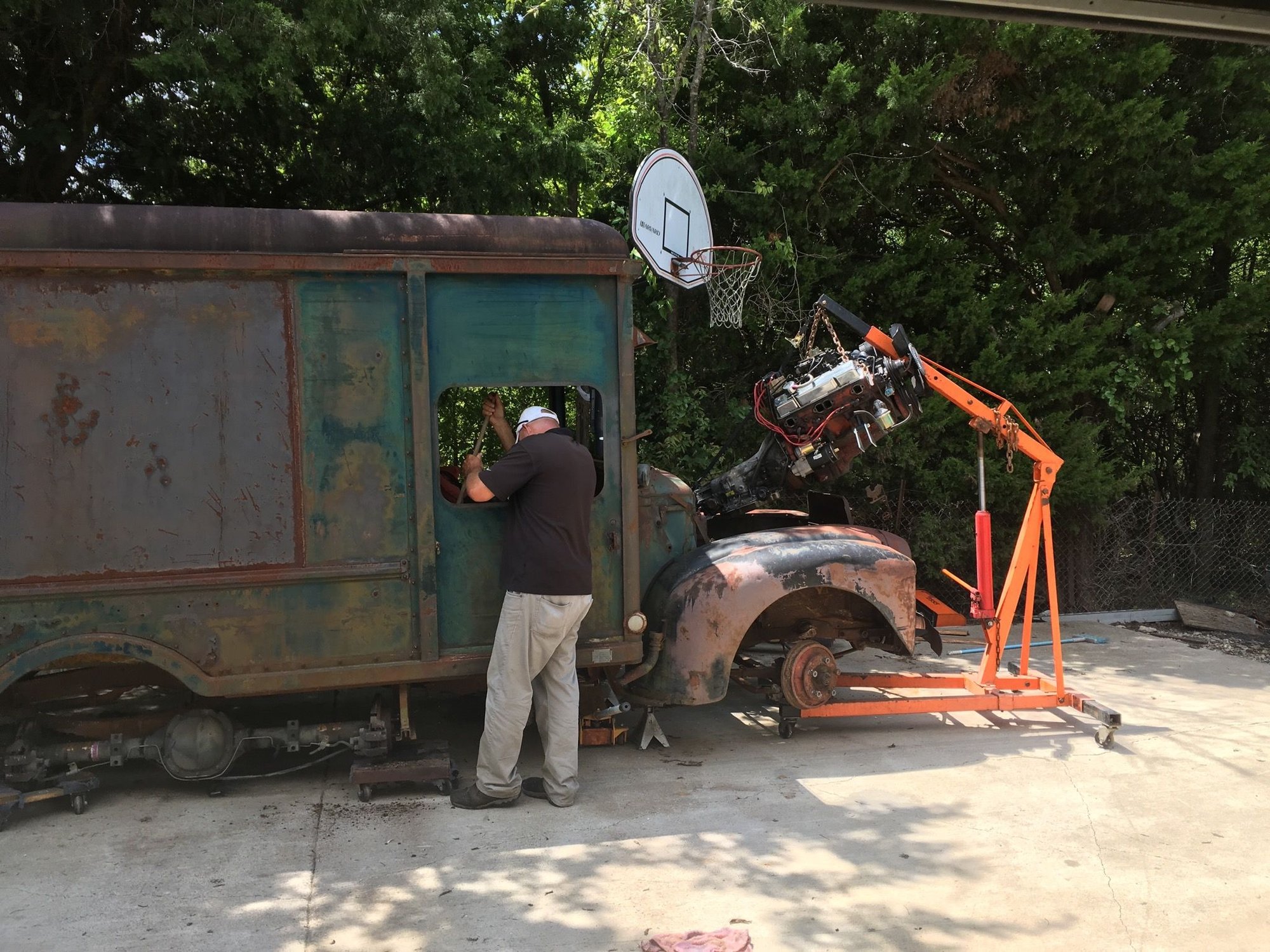

Stu, I believe that it is a tonner. The front drum looks to be too small to be 14" and the rear axle in front of the truck is definitely a tonner axle.

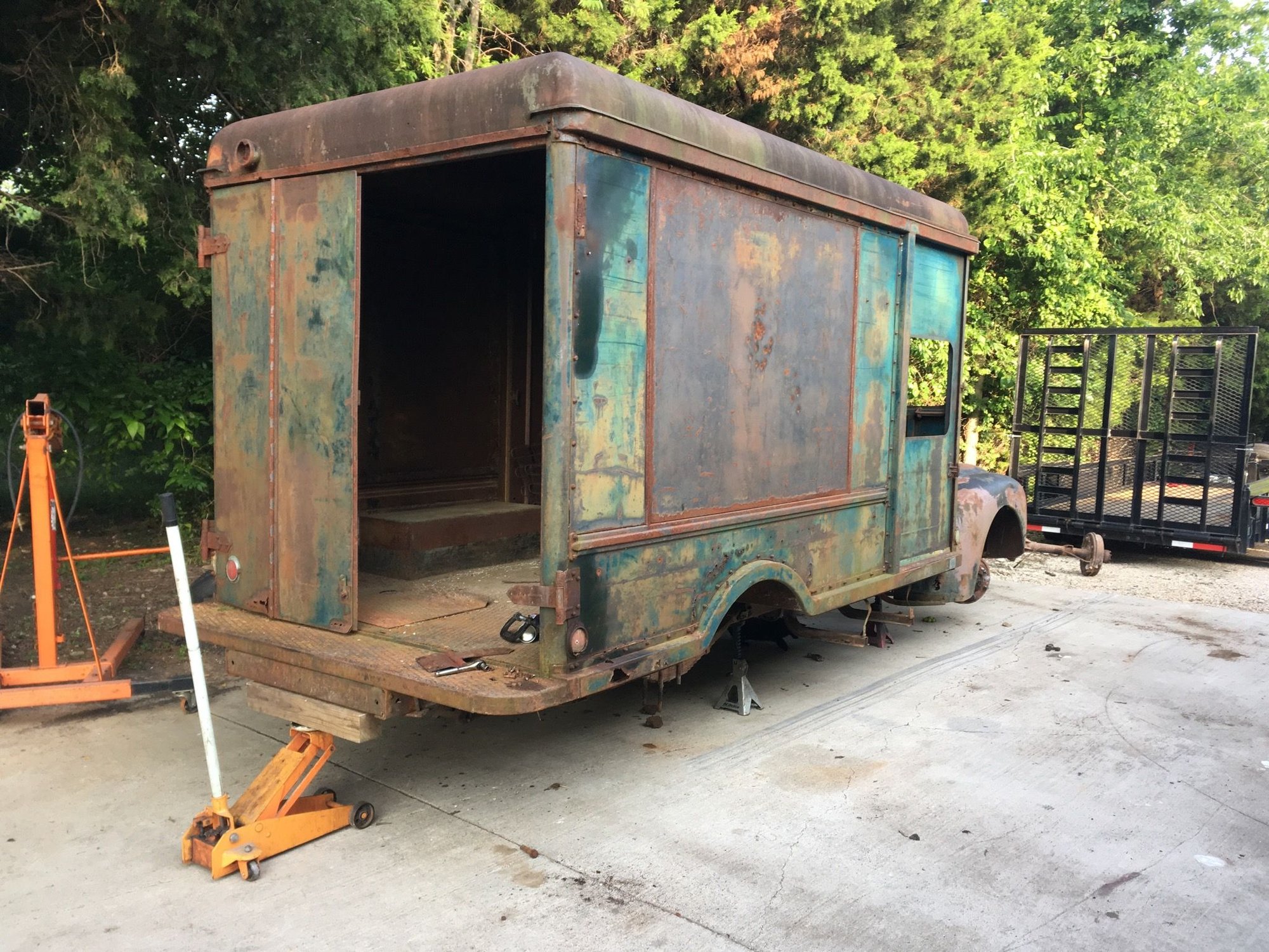

X3 on the REA. Yes I also think tonner, but once again, measure wheelbase axle to axle. Also wheel wells or 'wheel houses' inside the body. There should be 48.5 or 49" between if it's a tonner. If it's less, like 45" it would have been built on a 1 1/2 ton cab/chassis frame... It is a very cool truck.
