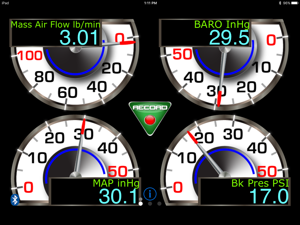

Here's the relationship on my Dashboss between your MAP, EBP, and Baro at both KOEO and idle. As you state, keep in mind the EBP is in hg's of Mg but the conversion is correct when adjusting to psi. 17 psi equals about 34 hg's of Mg and your Baro will change due to your altitude.
Idle.
