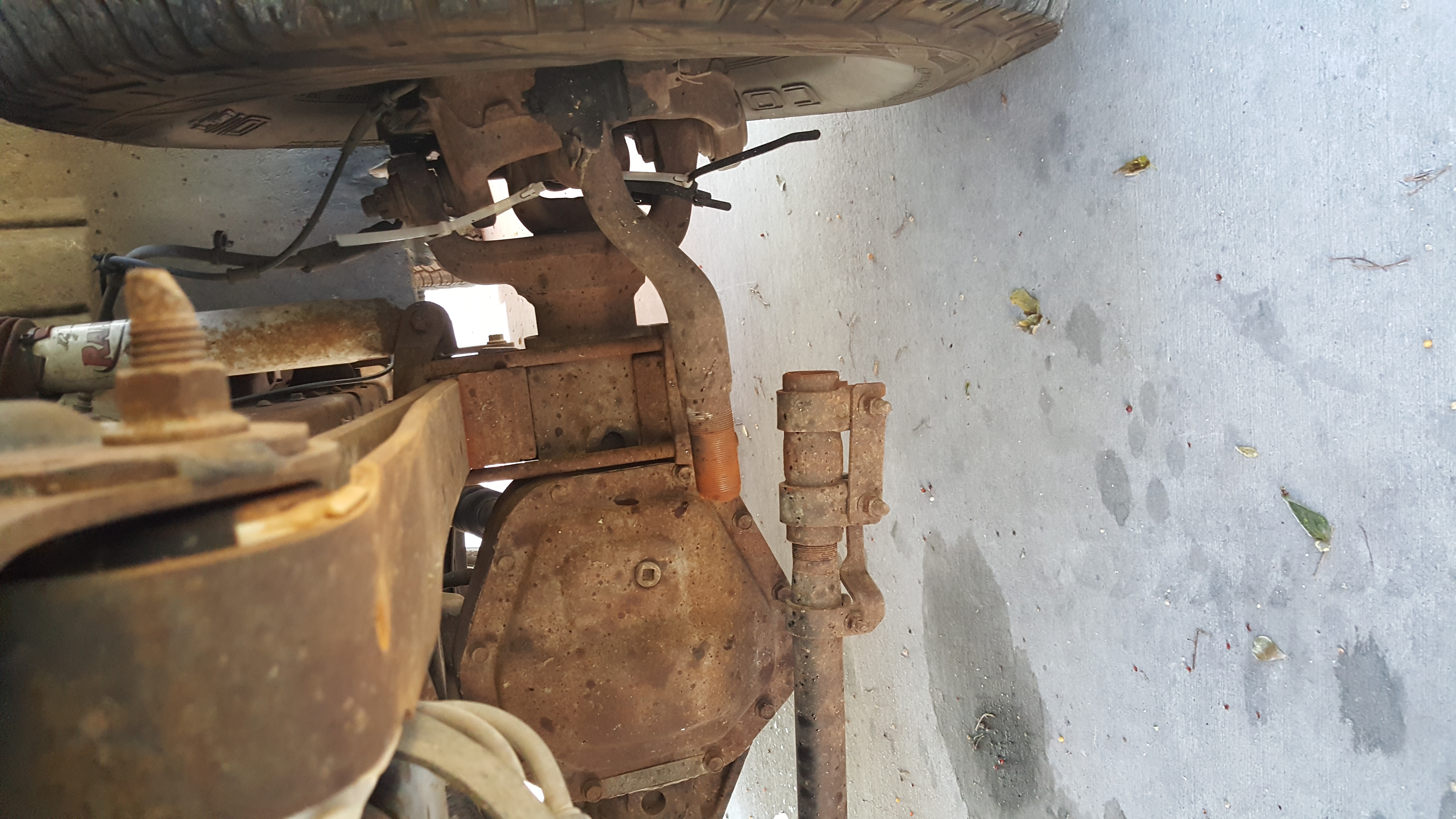

Ok, so I leave the fire station this morning headed home and my steering felt weird. About 1/2 mile from home I hit a bump and my drivers side front wheel started making a screeching noise. I stopped and looked out the window and it appeared fine. I limped home and as I pull in the driveway, I lost all my steering. I look under the truck and this is what I found.Name:  20160828_083121.jpg

I'd say you need to, at a minimum, replace the left outer tie rod end and the adjusting sleeve. It would probably be a really good idea to replace the right outer tie rod as well and at least check the inner tie rod (drag link). Whichever way you choose to do it, you'll need an alignment afterwards. I would not just put it back together. It already came apart once . . .

So friend/mechanic one finally responded and he said the same thing. So for now, given the lack of funds.....I'm on my way for to the parts store for the left tie rod end and an adjustment sleeve. How does this even happen? It feels like the threads just slipped past each other. 210,000 miles of vibrations wore them down maybe? Thanks for the help brother. This forum is awesome!

My guess the adjusting sleeve wasn't tightened to specs.

Very likely. I have had numerous problems with that it the past. Shop monkeys were doing it wrongn after the alignment. I caught many of them putting the pinch bolts 180deg from the slit in the sleeve. Well, that will only pull the sleeve open as you tighten the bolts. Make sure that they put the 2 bolts at the same position as the split in the adjusting sleeve. This will pull the split closed as the bolts are tightened. Insist on this. Do not take no for an answer.

The camber is set by sleeves that the upper ball joints sit in. Camber is non-adjustable so don't let a shop snow you and tell you that they adjusted it. A toe is all he should need. You can easily center the wheel yourself with the drag link adjusting sleeve (between the pitman arm and the right knuckle). There are adjustable camber sleeves that you can buy if you want to but it requires removing the upper ball joint to install them.
Adjustment sleeve bolts: 41 ft-lbs
Tie rod end heim joint nut: 67 ft-lbs

Quick update. We replaced the tie rod end and the adjustment sleeve. Hopefully I can replace the seals, u joints and spindle this week. Then i will get a good adjustment done. Oh yeah and front shocks too. Thanks everyone for all your help. Any suggestions on good shocks, for a decent price. Ranch 9000's are what's on it now. Thanks again and God Bless!
