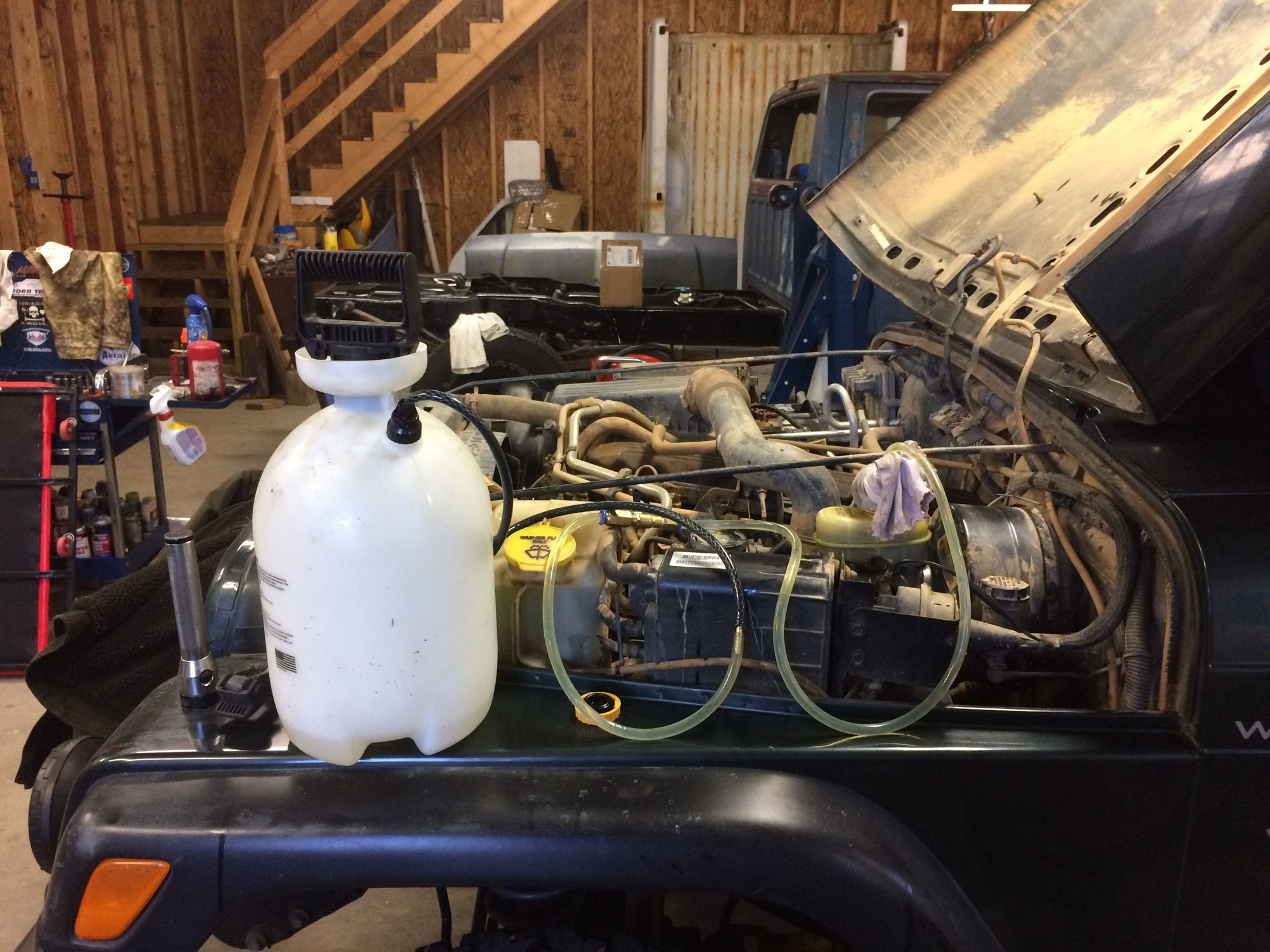

Gary,
Sorry for taking so long with getting you the pic of the system I use at home. However at this point, rather than build one, I'd probably just buy the fifty dollar one off of amazon, and then get the right adapter for my needs, or maybe even be spendy and get the whole collection of brake reservoir adapters!
Here is a link to the one we used at MB: Expensive Bleeder
http://a.co/1TdqHaY
link to a write up, as I'm too lazy to do it myself: WriteUp
Link to a pre-built manual bleeder: http://a.co/2GeYdtd

Josh - Thanks! This is very timely, oddly enough, because I just acquired a 1985 F250HD that has a working brake system but yucky-looking fluid. So, I want to flush it but am NOT going to try to suck it through with a Mityvac.
And, I fully agree - buy the one off Amazon instead of making it. But, on the adapters, is this the one you meant? https://www.amazon.com/Motive-Produc...HY8TCF1Y0NCTA9.

Worth it just for the adapters. I had not seen that one. All the adapter kits I found were 2-300 bucks, ergo why I built mine, since I planned to make all the adapters as well.
http://a.co/9ohNRCC
http://a.co/1XOUNKN
However with that setup, it looks like it would be easy to add additional adapters, just find the right AN fitting to screw in. I also don't see a shutoff valve. I would add one, in line, as close to the adapter connection as possible. to stop fluid from dripping. Remember when you disconnect, without a shutoff valve to relieve pressure. (Yes I have done it the other way, there is brake fluid on the shop roof to prove it.) Oh and don't forget your turkey baster or fluid evacuator, they will leave the system over filled, and you'll need to lower the level just slightly.
This is what I use: http://a.co/0ReL4GC
I used to use a turkey baster\suction bulb 'designed' for brake fluid, however, after ten years of being saturated with brake fluid the rubber expanded and didn't seal on the intake tube. I've not been able to find another one, as that came off the S&K\OTC\any cheap tool he could sell\specialty truck, in fact I almost bought a Taylor 6 string off that truck...
