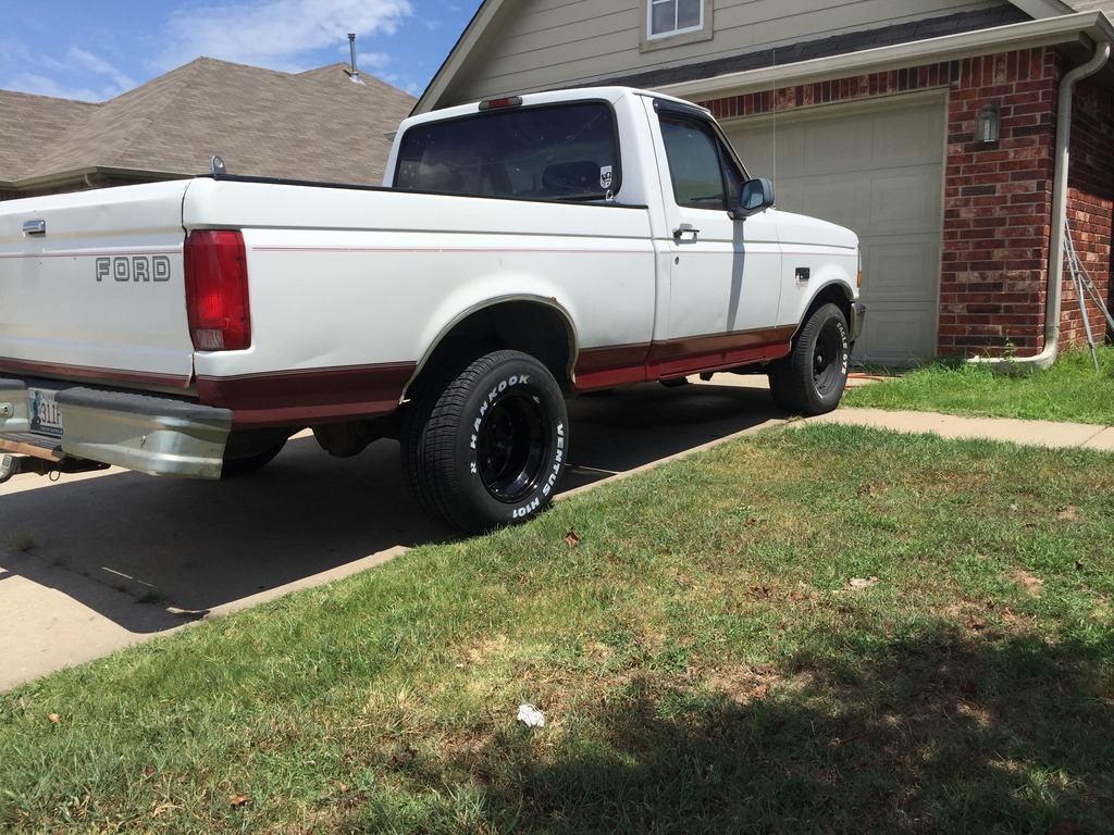

The rear wheels

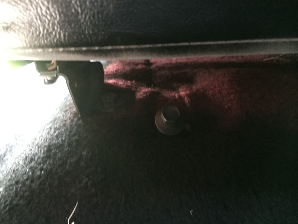

As for the seats I used the mustang rails, got the seats exactly where I wanted them and then drilled new holes and mounted them with new bolts and nuts. I wasn't able to put one bolt in the drivers seat until I remove my front gas tank because it's right where I need to drill.

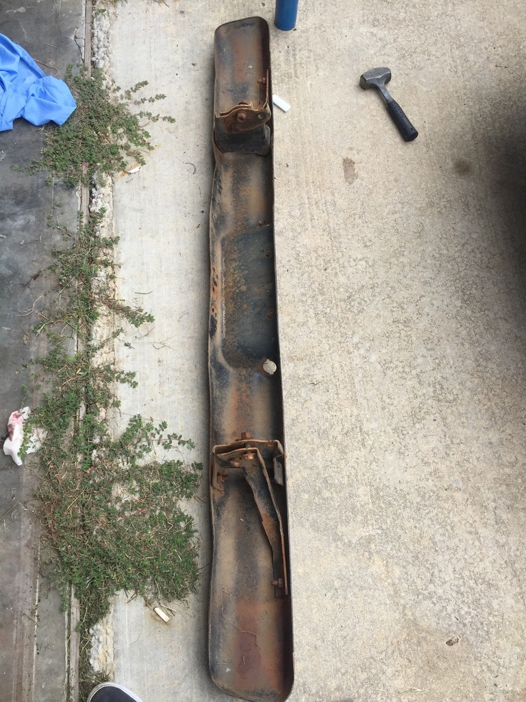

Today I finally got the rest of the old rusted bolts cut off, finish sanded the metal and got it primed. I probably should have used body filler in a few places just to get it all smoothed out but it's a bumper so it's gonna get beat up anyways. Last week I used my last quart of the ebony gloss black I've been spraying with so I will go pick more up tomorrow and get some color sprayed when I get home from work.
I'm also going to take all the mounts up to work and media blast them, I'm still not sure how I'm going to mount this thing yet so I may not even be able to use them. If I have to I will make all new mounts out of material I have laying around at work.

As for the seats, this is the drivers seat, drivers side of the seat and rear mount. Excuse the red carpet, I just dyed the carpet black until I can afford new black carpet and didn't take the seats out to do it. I don't have a pic of the mount for the drivers seat passenger side rear mount because it isn't bolted down, I will have to remove the middle gas tank before I can do that.

That is correct! I spent quite a few hours situating the seats before I drilled my holes to make sure everything was where I wanted it and level, as I was situating it I realized the fox body mounts sat perfectly flat against the floor of the truck so I just drilled my own holes and used extra large washers on the bottom.
