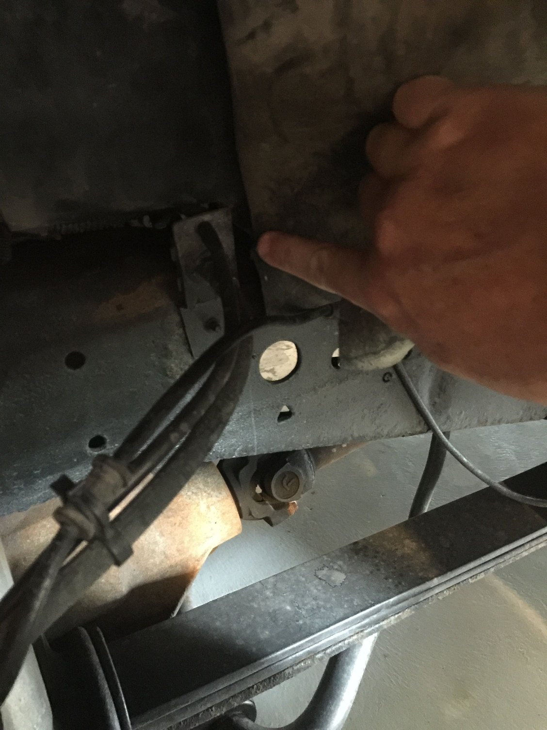

Me too mine changes the blower doors at 2k rpm: acceleration, and high hwy speeds
Does anyone care to post a pic of this thing?
I found one and see there is a red and black vac line, but there are vac lines all over the place and I'm solo testing and haven't picked up a vac pump but will soon, maybe this weekend

Pictures, gypsy

Originally Posted by HiZ
Pictures, gypsy
This is the drivers fender well just to the right of the shock. Look under the spash flap.
This is the drivers front axle looking down and to the left.
It will be the same on the passengers side.
