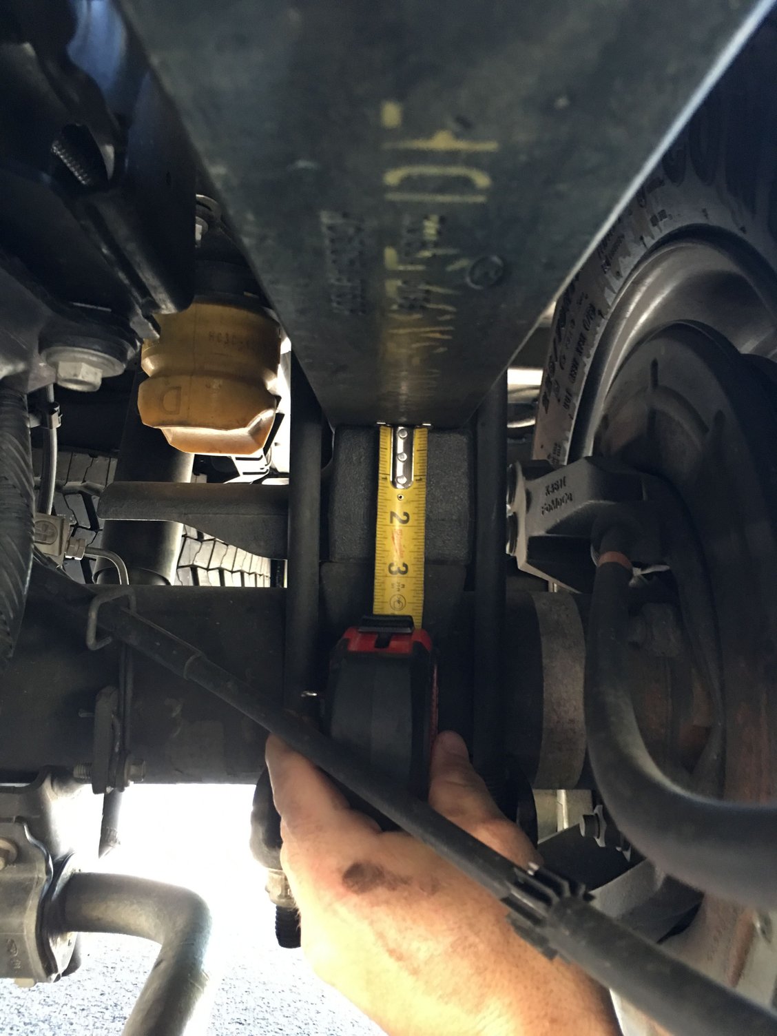

Here is block height on a 2017 F-450.

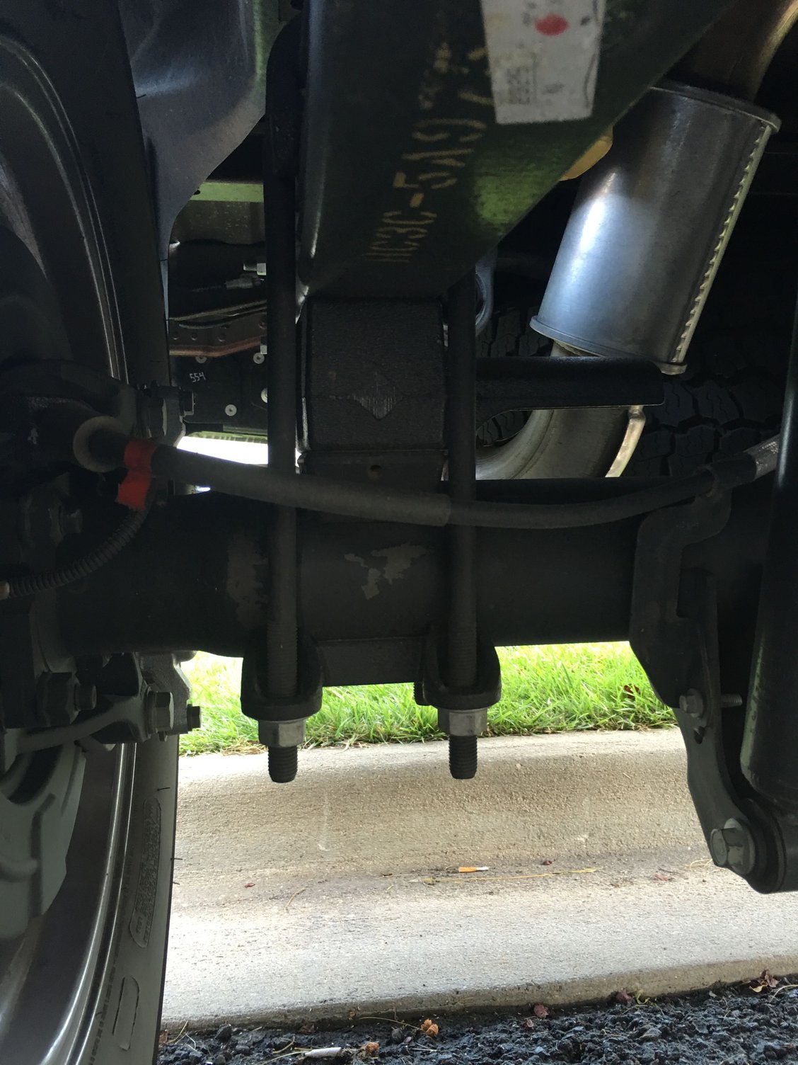

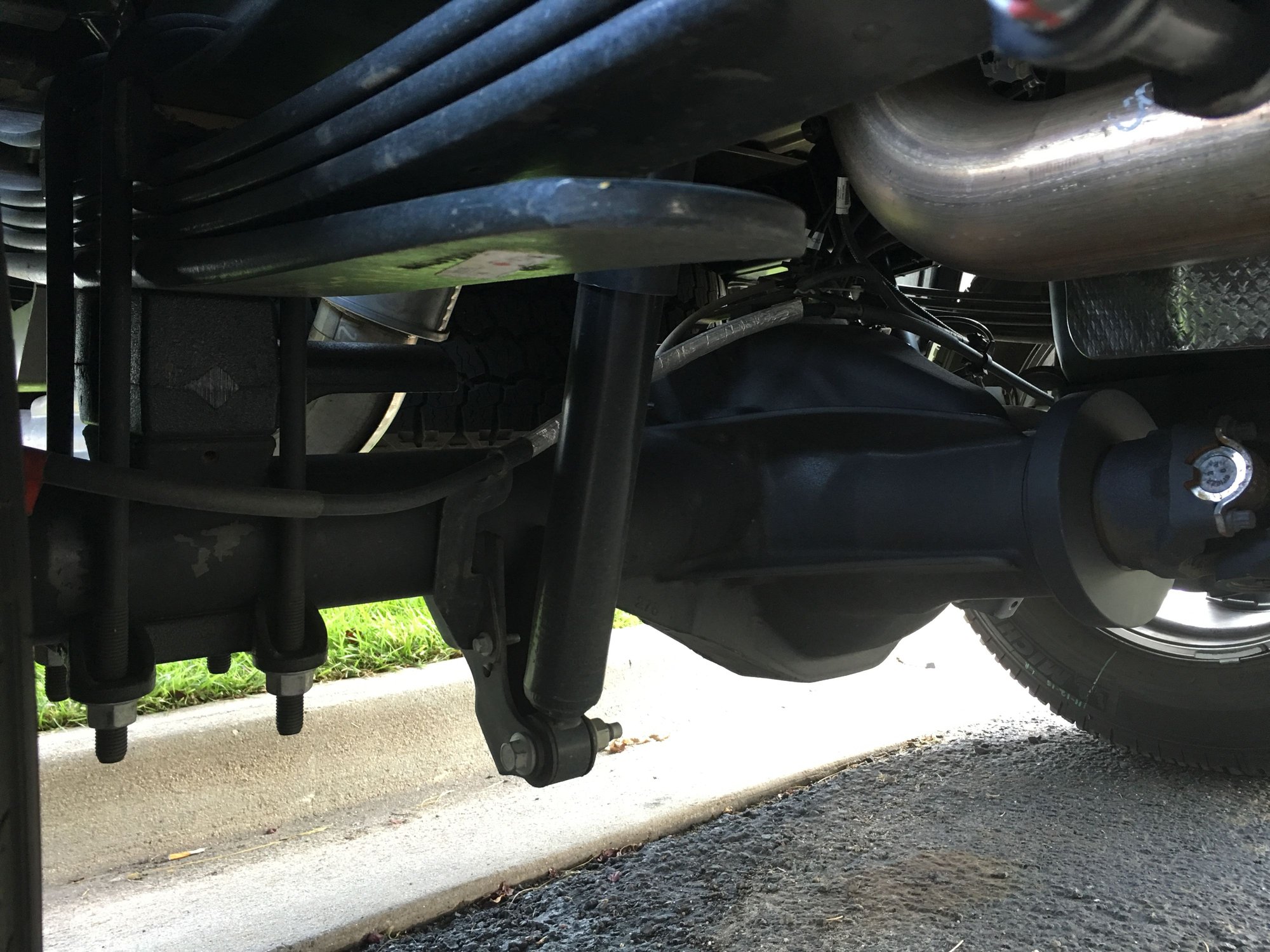

Didn't get a tape on the SRW blocks, but here are pics of them. You can see they are taller than the 450 blocks.
