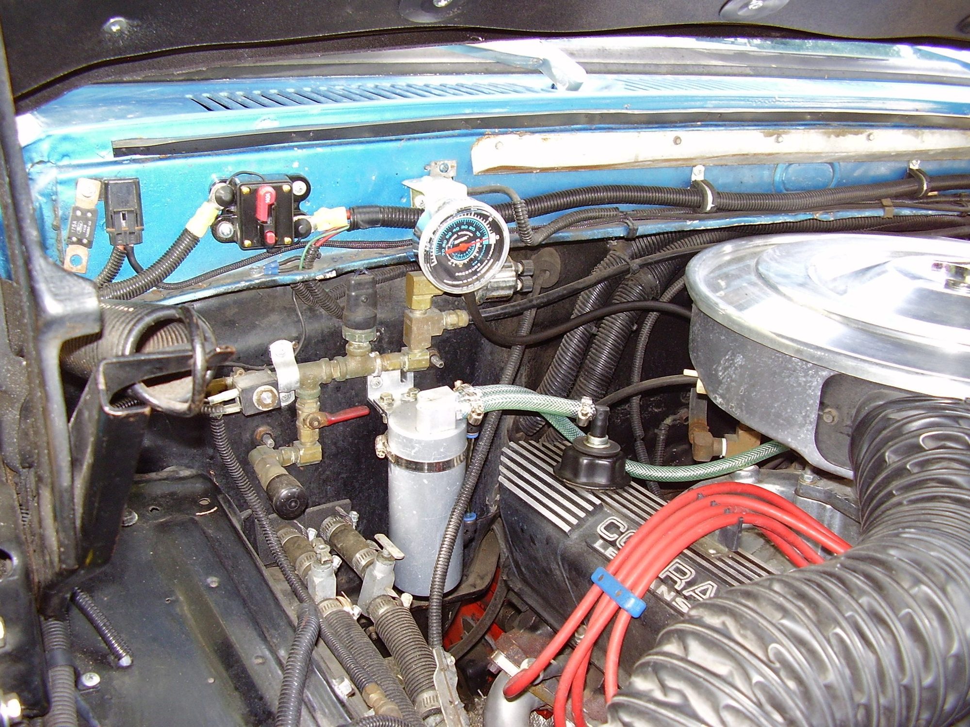

A catch can tells the story, even having a shielded PCV. Paid $17 bucks with free S&H
Drain on the bottom getting a little oil black juice after every 2-3 oil changes
Orich
Where did you buy it? Also, what is the 100Amp circuit breaker (to the left of the vacuum/pressure gauge) for?
Orich
Thank you, Orich. That catch can would keep the OP's combustion chambers nice and clean. I just can't stand looking down a spark plug hole and seeing crud...it's bad for an engine.
It feeds the 12v. aux terminal power pickup for the on board air an the 12v inverter, & the cab AC all the aux lights, these are common use on GM pickups so it makes less wire having to cross over to the Battery. Plus feeds my other Battery & alarm system so when, I shut off the main power to the main Battery any time it's parked.
Orich
Ps
Oh the catch can got it off ebay. Shipped from China free to US for a total of $17. The longer plastic hose needs to be replaced with a regular PCV type hose as the one they supply will claps after it gets warm from the vacuum. These units come in different colors.

I've never seen that much spaghetti on an older truck. Aux lights? inverter? what are you doing...driving a disco truck? I'm impressed by your git-r-done ingenuity.
