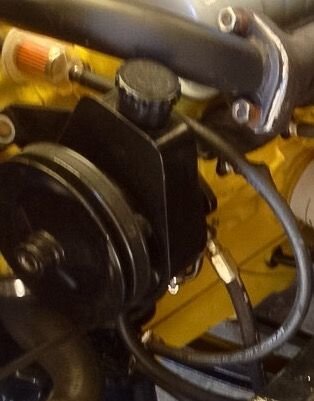

I got a power steering pump for a chevelle (I think it was for a 72). Was about 60 bucks (including core) at ORiellys. Might be cheaper at RockAuto.
I used a pulley off of a Ford pump I already had.
This is the bracket I used.
This is what it looks like assembled.
Don't forget the vibration damper pulley needs two grooves or an add on pulley. The lines are best bought from one of the vendors and the steering gear is a Toyota. You'll also need a Pitman Arm that fits the Toyota box and the F100 draglink. It wasn't a no brainier bolt in on mine. I had to do some shimming to get things to line up. After I was happy with the fit, I measured for the drive belt and went to the parts store and bought one. Nice thing about that is if it doesn't fit you can exchange it until you get one that fits.
