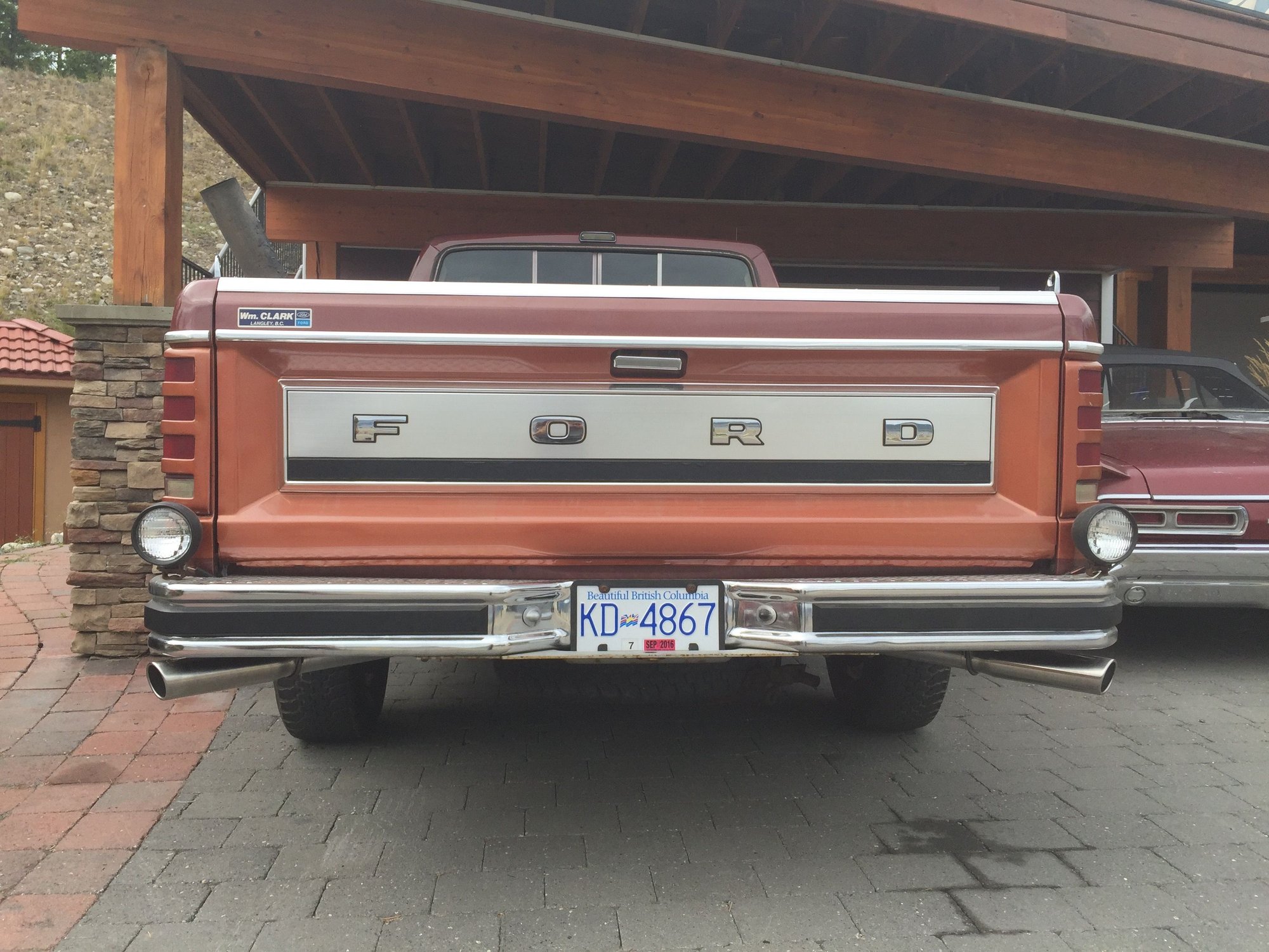

hello all!
I apologize for leaving this for so long...
I recently went ahead and did the upgrades.
The carb ran okay upon the first start. It was lean and popping in the high rpms, but we managed to almost completely tune it out. I can honestly say that i'm happy with the performance increase. There was a noticeable increase in throttle response and pull right off the line. Definitely can smoke the tires now... There was also an increase in the higher end as well when the secondaries open. Keep in mind that my kickdown isnt hooked up currently and I can imagine that would make quite the difference in terms of feeling this power. In conclusion, I can confidently say that the seat of the pants dyno was satisfied.
Does anyone have a guesstimate as to what HP and TRQ numbers my truck is putting out now?
I'll upload some pictures tomorrow at some point
Jared
