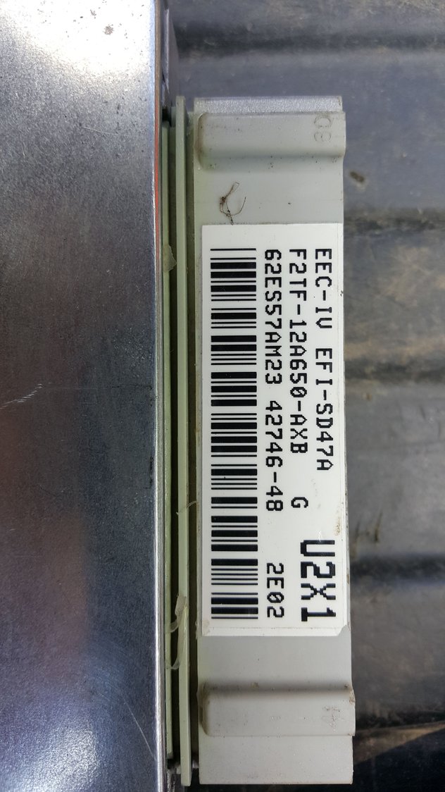

I took pics of the new computer and the letters/numbers from the old computer. Not sure exactly which ones have to coincide. I will try to get the pics uploaded.
If new computer is correct, does anyone have any ideas? Engine starts right up and idles, but when I give it a little throttle, no power.
new computer
from old computer

If they both say U2X1, then it is indeed the right computer. Did you guys remember to plug the SPOUT connector back in?

As others have said, "U2X1" is the catch-code that needs to match, so you're good there, assuming that you have an automatic transmission.
If you're still having the same problem, it's likely that your original PCM was fine. This is why "parts-swapping diagnostics" can be very costly if you're needing to buy parts to do the testing. Proper diagnostics is the better approach.
