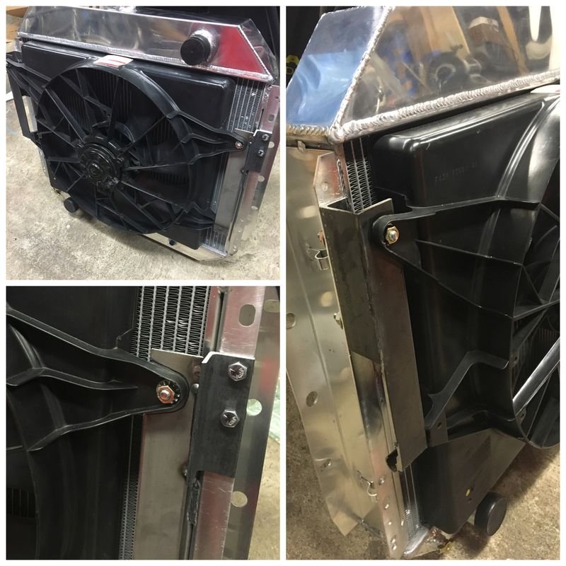

Thought I'd update the thread with what I tacked up tonight. If I continue to have cooling issues I'll go the full shroud route. But for now nothing to fancy (except for the PWM). If ever I need to swap the Lincoln shroud it will drop right in. I semi-boxed the left side and plan to mount the over flow tank there...one of those eBay stainless tanks like Champion sells. Cheers and thanks for the neat ideas.

Look good!
