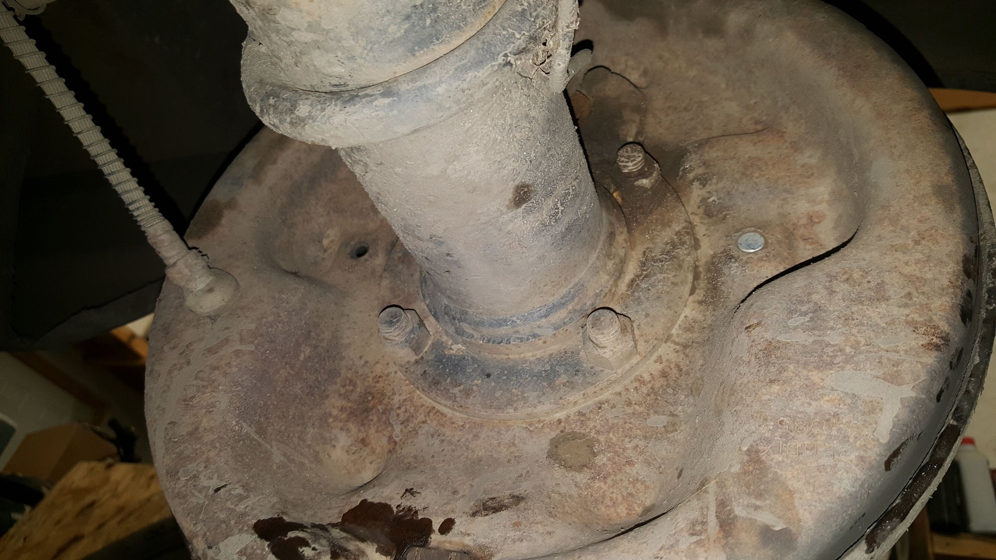

Let's play a game called let's spot the missing part
Old Jul 28, 2016 | 11:28 AM
70FE250's Avatar
70FE250
Joined: Oct 2015
Posts: 445
From: Bismarck, ND
Well that's not good.
Heading into town now for drum resurfacing and new hold down pins
Please note that I DID have both pins in there

0.30 Hell it should be marked on the outer lip of the drum how far they will go.
F250 most are 0.125. A lot of places try to sell you drums when ya don't need them.
And both rear drums should be turned out the same size. Best to replace both at the same time.
Those brake parts look pretty old for being near new like you said, or maybe you did not clean those parts up when putting it back together. Looks about like 5 yrs of build up on them.
It's sometimes hard to know when to replacing all the brake hardware but a good inspection is always important so the little parts don't fail.
I try to make sure all the brake hardware is replaced as needed at the first since it's so hard to service the rears.
And when you have a bad back it's not easy to R & R the drums on with out damaging the oil seal.
Man, I have not weighed the rear drum & hub but it's not so easy when your in the age group of 70 74 but ya do run out of cuss words to ya make new one up if it don't go on right the you have to pull it off cause ya F up the seal or it came out.
Orich

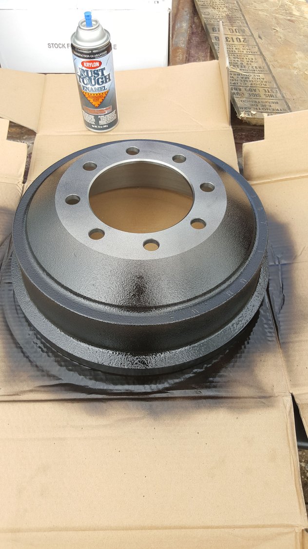

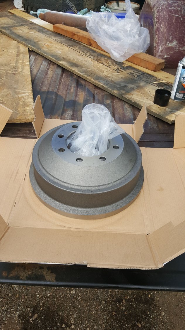

Got the new drums and prepped for painting
Now painted, one less ugly rusty contraption on my truck
Waiting till tomorrow morning to press out the hubs and put them into these, pretty happy to have less to worry about
