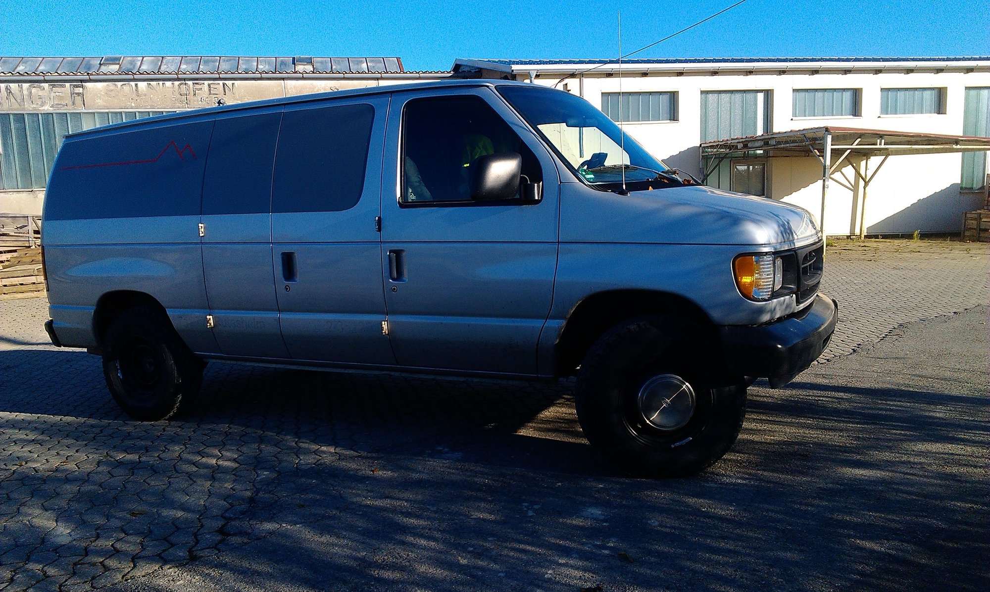

Yesterday I ordered 265x75x16". Hope they will fit ^^ seems to be a lil tight in the tirehousing...
irrelevant if they will fit, i want to lift the Chassis about 2-3".
rearaxle will be simple, sure. but on a 2wd e250 97' Im sure the wheel rake will Change by placing some discs under the coilspring.
anybody experienced by Lifting 2wd's? Maximum Level?
They won't!
This is a 235/85R16, same diameter (32") but skinnier, and it's already a tight fit in the rear of the front wheelwell while turning left or right.
The front of the front wheelwell is no problem, if it's too tight you can place a 1/2" spacer between the bumper brackets and the frame.
Levelling is possible with stock springs of a Diesel ambulance for example, but make sure you get the correct camber bushings to correct camber.

265/75R16's do fit! they rub a tiny bit on the back of the fender liner and lower corner of the bumper valance both of which can be trimmed and massaged with a hammer accordingly.
