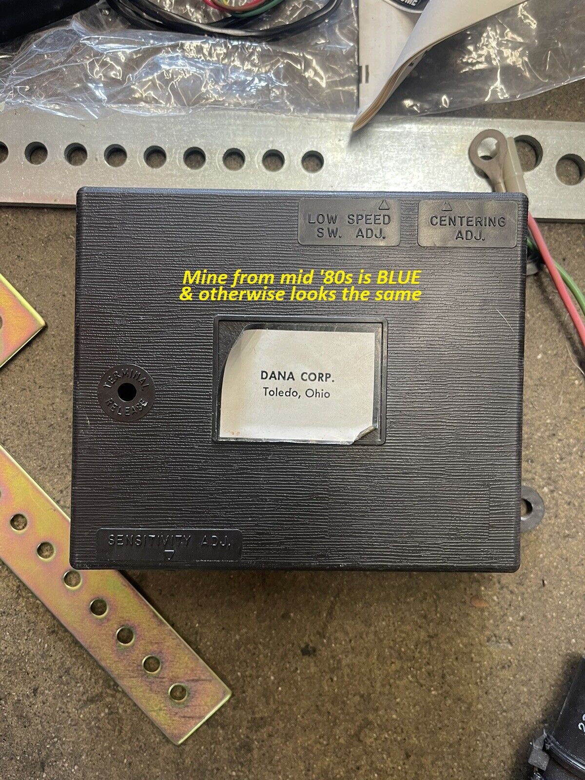

Mine on my '77 is an aftermarket I bought and put on in 1986, I had put one on a Chevelle before that. Local Sears surplus store offered them then for $25, I had bought a couple. Dana made it, but was sold by Sears/Allstate # 318.20302. I've seen a few OEMs years ago, looked like Ford used the same or very similar one with slight changes to incorporate them on an assembly line. A few short years ago I bought a new never opened on off Ebay just to have for spare parts if ever needed. Might be they way?
The "brain" is referred to as "the regulator", it is like a flat box. Mine is blue, but some are black. Here is another thread. https://www.ford-trucks.com/forums/1...l#post20964227

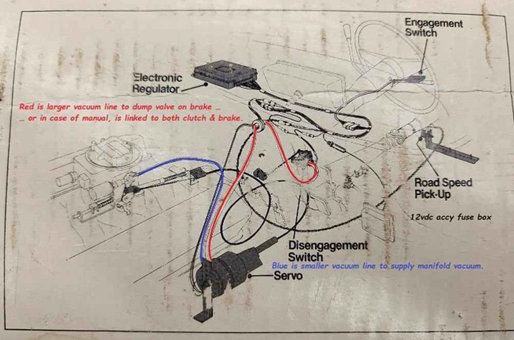

Somewhere, I'm not sure where ..... even on a factory install, there is a brake pedal mounted or controlled deactivation switch that both electrically deactivates the CC .... AND .... dumps vacuum.
Might be an adjustment is letting it dump or deactivate as if the pedal was depressed. Mine is a switch with spring loaded arm mounted to the brake pedal arm, and a ball chain runs to the anchor on the firewall. I have it adjust so I just depress or tap the pedal, it deactivates and dumps vacuum.
My truck is an automatic, but on my Chevelle was a 4 speed, the ball chain ran through a pulley like anchor and then to a real anchor point on the clutch pedal arm, so depressing either clutch or brake pedal deactivated the CC.
