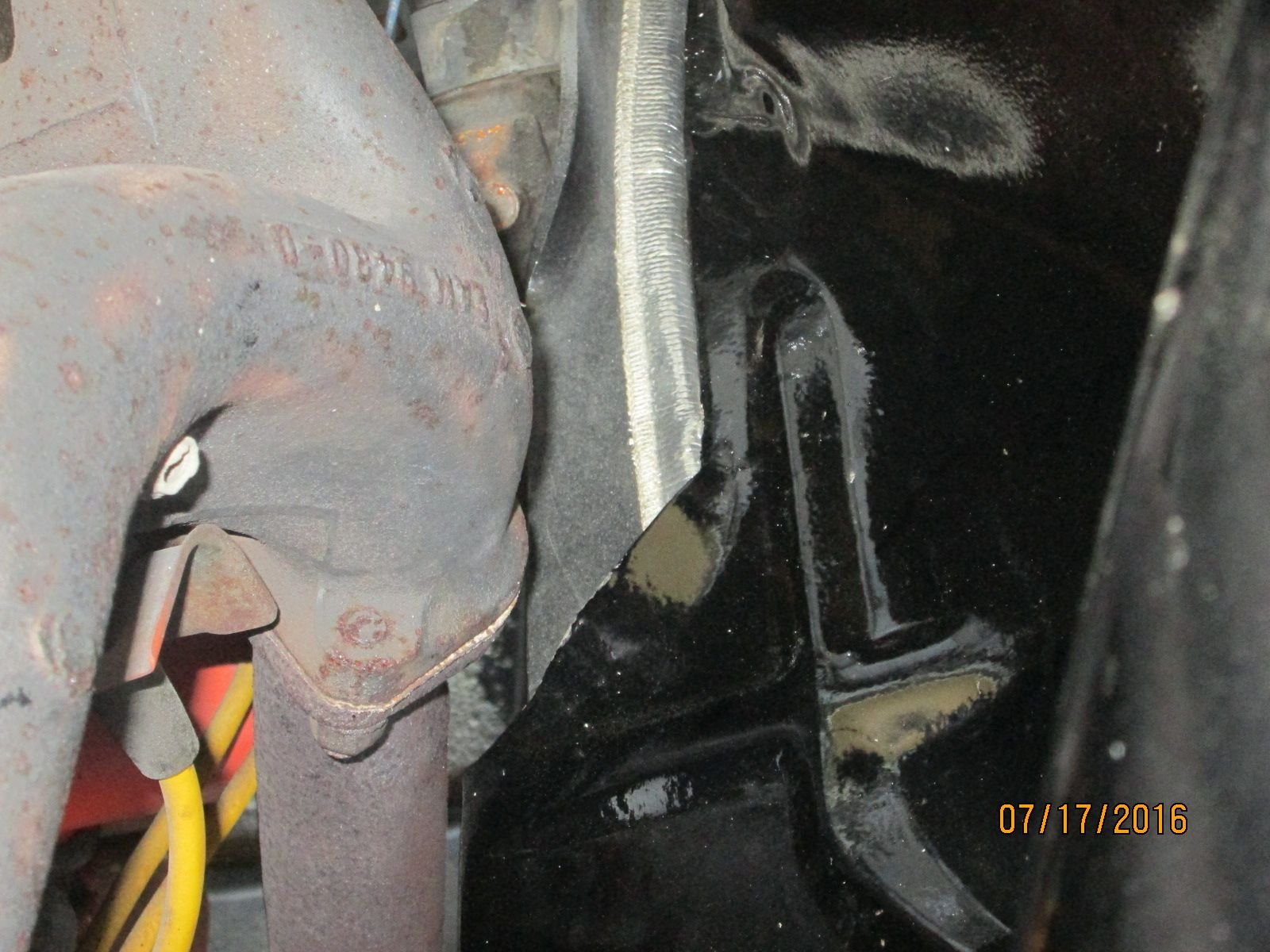

Hi gang. Beautiful day here on the Delmarva Peninsula.
Went to a small cruise in last night and developed a fuel issue on the way home. I'll give you the rundown.
Cruise in was about 14 miles away. On the way there , Truck just did not seem to have that much power. Took a lot to get it up to speed. There was no increase in RPM's if I put accelerator to the floor. Was at the event for about two hours.On the way home, truck lost all power. Engine ran, but could not accelerate. Changed fuel filter. See thru filter would not fill up. Limped home. This morning, truck started right up, fuel filter full. Ran for about half hour. Fuel filter not filling up.
Background. New gas tank, new fuel lines. Rebuilt fuel pump.
!. Am I chasing a vapor lock?
2. Am I chasing something floating around in the new tank.
3. Am I chasing some sort of a fuel pump problem.
Truck is idling great. RPM's not consistent when Accelerator is pushed.

Fuel line is covered in reflective covering. Made sure. gas tank was venting. opened gas cap to be sure. Fuel bowl on fuel pump clear.

The reflective material may just be trapping heat in the line. Can you remove the shield easily?
Usually vapor lock is worst at idle (no fuel flow, no air flow over the lines). I foresee an electric pump in your future....
