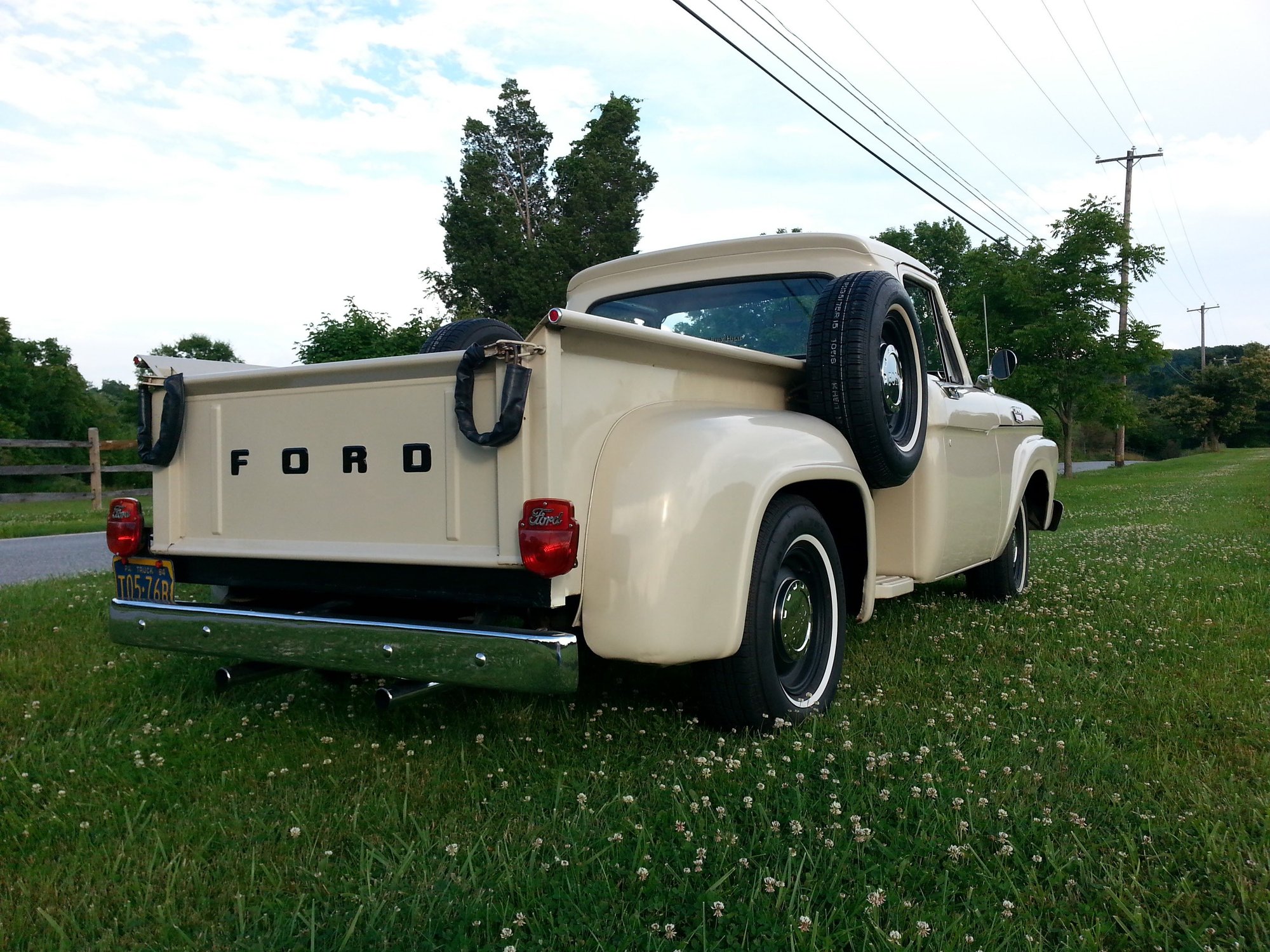

I'm actually planning on doing the leaf flip from the HAMB, can you give me any more information on how rides now compared to before? Any obstacles you had to overcome in order to make it happen?

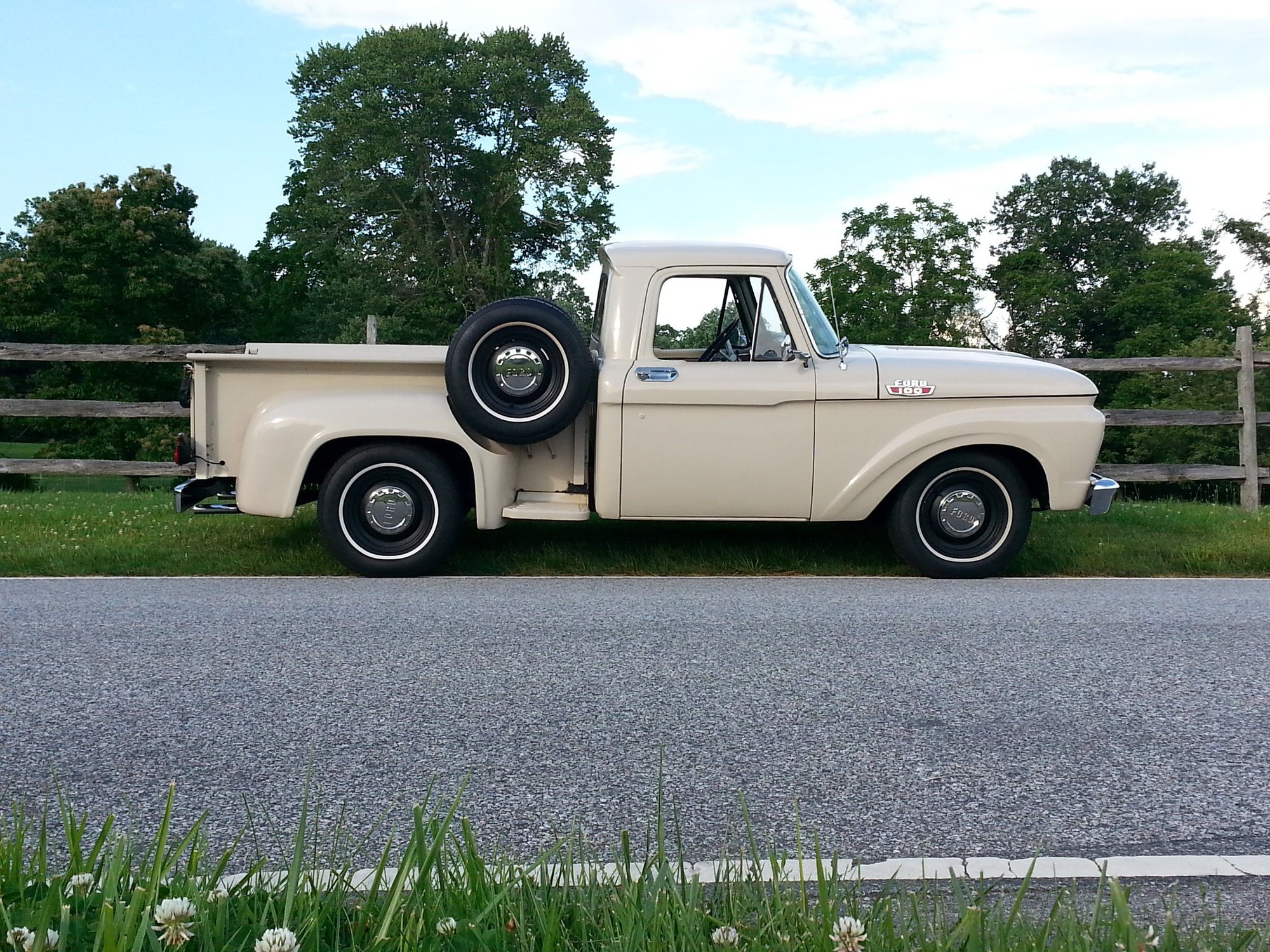

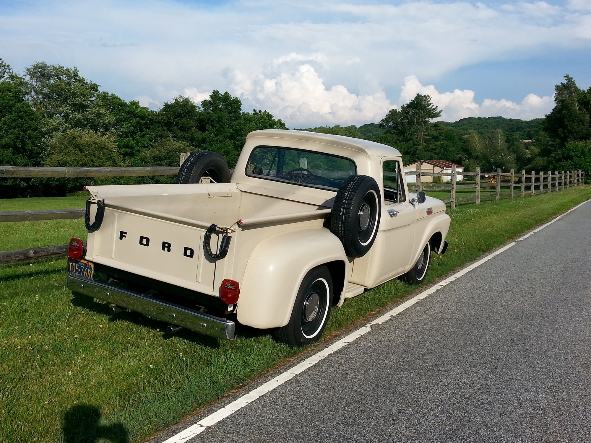

The ride is ok, the 1st, issue in my opinion is you now have two reversed arched leafs fighting each other for flex. That makes it a harsh ride, I don't mind that so much. The 2nd issue is the steering wheel is off which is an easy fix as to just loosen the bolt on the pitman arm and straighten the wheel and reattach. If I were to do it again, which I might depending on my money situation; I would do the next shorter one vs the one the HAMB says to do. My stepside sits so even that my 3rd issue is with anything in the bed or just being parked on a hill the rear looks lower than the front. 4th and not really an issue but you have to work around it, on my rear leafs of my stepside I was not able to get the bolt out of the front eyelet. The fenders are in the way completely. It is doable still on the truck, I used a three foot long threaded section to run down a nut then used a big C clamp to hold it to put in a new bolt and nut. I did have to round the head off and run an extra nut down so it would sit good in the purch. I like the raked look better so I will either take it apart again and just reverse the next shorter one unless money free's up to do a mono leaf in the rear. I never had an issue above 60 mph but now I have a front end shimmy sense I did the flip. I mostly drive this locally but when I end up on the highway I end up only doing 60 =(. One last little thing, mny exhaust does tend to hit my rear on rare occasions. It sitts so much better, I can't go back to stock. Especially with a 2wd or I would raise it. Hope this helps.

My best advise, do as much research as you can before you go getting in to far. It is a pain if you are in your driveway, which I was! If you have the money, do a sid's dropped I beam or the mono leafs. This is mostly for the empty pocket people such as myself. Everyone's situation is different. My truck is family owned, I can't do too much to alter the originality of it. The best mod to do for the front end would be a doner crown vic and add the power steering rack. Just my two cents.

Thanks so much for the information! Also just my opinion, your truck my favorites that I have seen on this forum! My truck is my daily driver so do you think I should look at alternative methods of lowering it?

It truly depends on your budget... If I had the funds, I would do a mono leaf rear 4" drop and a sid's dropped 3" I beam in the front with new shocks. I get most of my stuff from Obsoleteclassicparts.com located in OK. Most orders are two days to PA where I am located. Napa surprising had most of the engine stuff, generator, belt and voltage regulator. ext... I have hopes to do that setup next year when I have the funds but if I really had not holds bar plus all the time in world to weld mock up and time, then the crown vic setup would ideal. That's not gonna happen LOL
Good Luck with it, keep me posted on what you do. I would love to see the outcome. Like I said, this was my third go around. \
