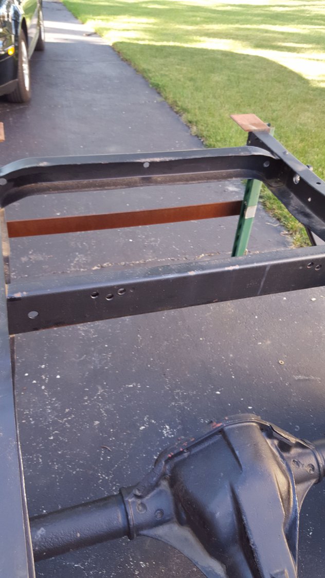

Hey guys going to start on the shocks and am puzzled. I have the shock mounts all cleaned up and set them up to the cross member but the holes don't lineed up...is there something I'm missing here are some pictures..it's a 1956 f100
Rear cross member
Thanks dan

the upper mounts you have pictured are uppers for the front

Thanks Kevin do u have a picture of the back mounts.

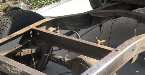

http://images.craigslist.org/00w0w_k...QY_600x450.jpg
But now I'm not sure,,,,, I know the 53-55 are like the link I posted, but, I just cant remember the 56. I will look tomorrow for you

Thanks buddy that's looks like all I need is to get some shock bolts..

This is how 56 rear shocks mount on top.
