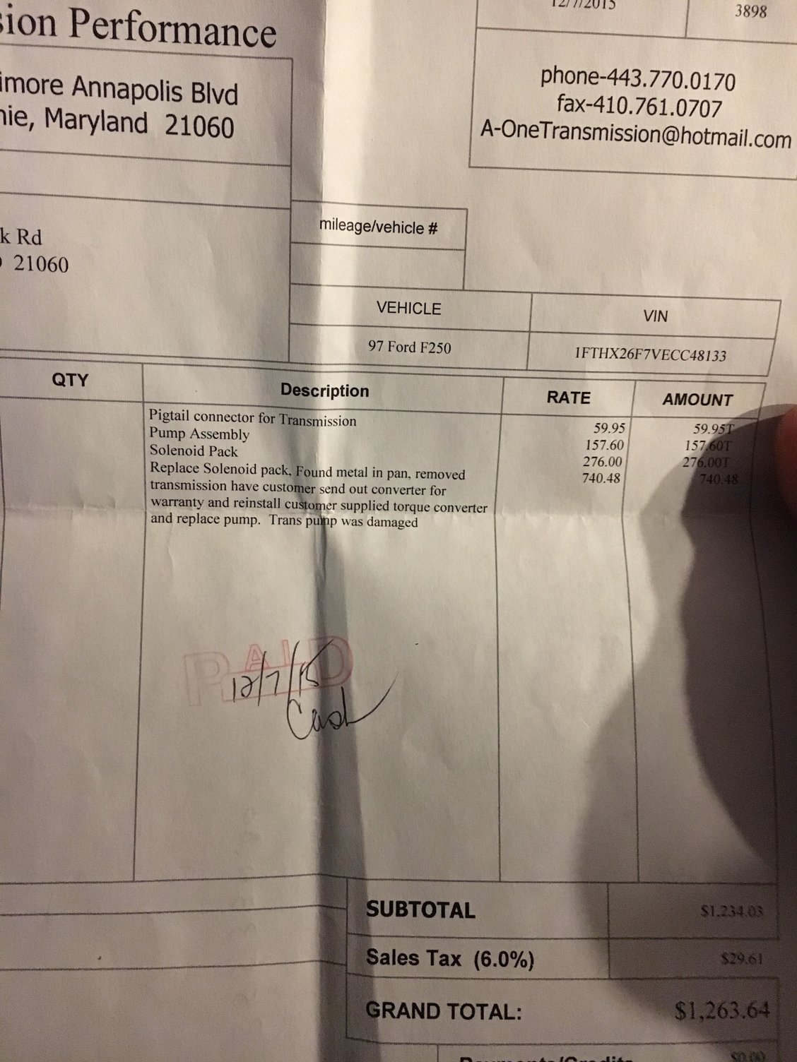

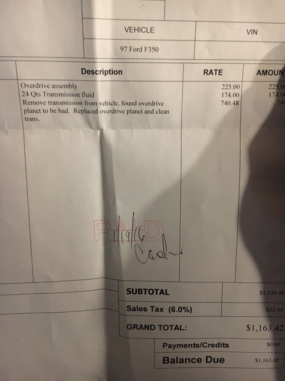

I had 4500$ worth of work done last fall to the trans new pig tail connector new pump assembly new solenoid pack new trans pump new overdrive assembly new overdrive planet trans xleaned and brand new BD converter was 1100$

When the last TC went was the trans and cooling system properly flushed ? Lots of debris comes out of a TC when they go bad

I don't see where it says cleaned lines or coolers(flush). If metal was left in any of the system that could cause premature failure
