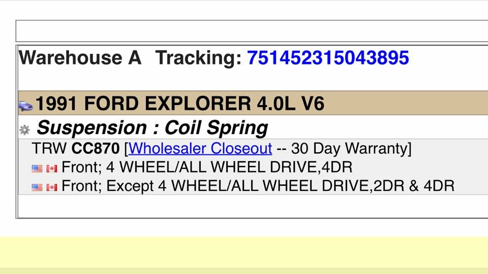

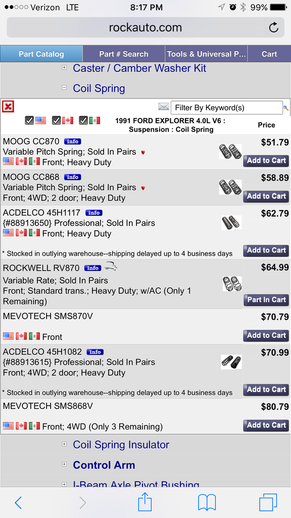

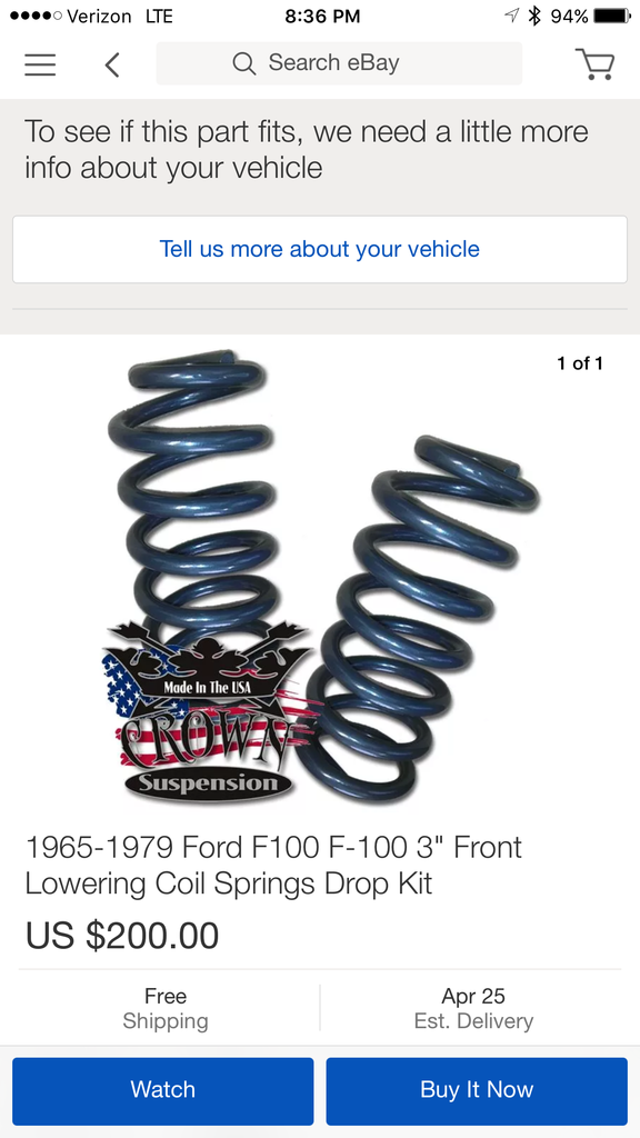

Originally Posted by CraigerF100
I haven't been out to check it with the level.
Here's the part I used
Attachment 218307
Here's what's available now
Attachment 218308
It would work well with drop beams. Cheaper then these
Attachment 218309
i. If any one is interested I have these springs brand new only use for mock up they were too low to use with Drop I Beams 3 " springs alone you should be fine let em.go way cheaper my loss your gain ..
