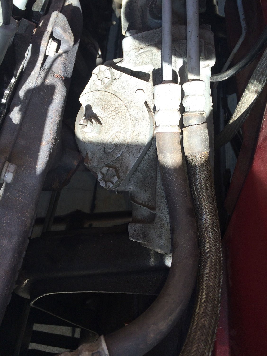

Power steering was not original to the truck and I saw this picture and its what made me think it was a Saginaw but according to your diag it looks more like a Bendix so I am not sure. Below is a photo, I know its not the best but maybe you can tell. I appreciate the info, I am only going to replace the pump but I was curious on the differences in lost power steering and manual.

You have a Saginaw.
