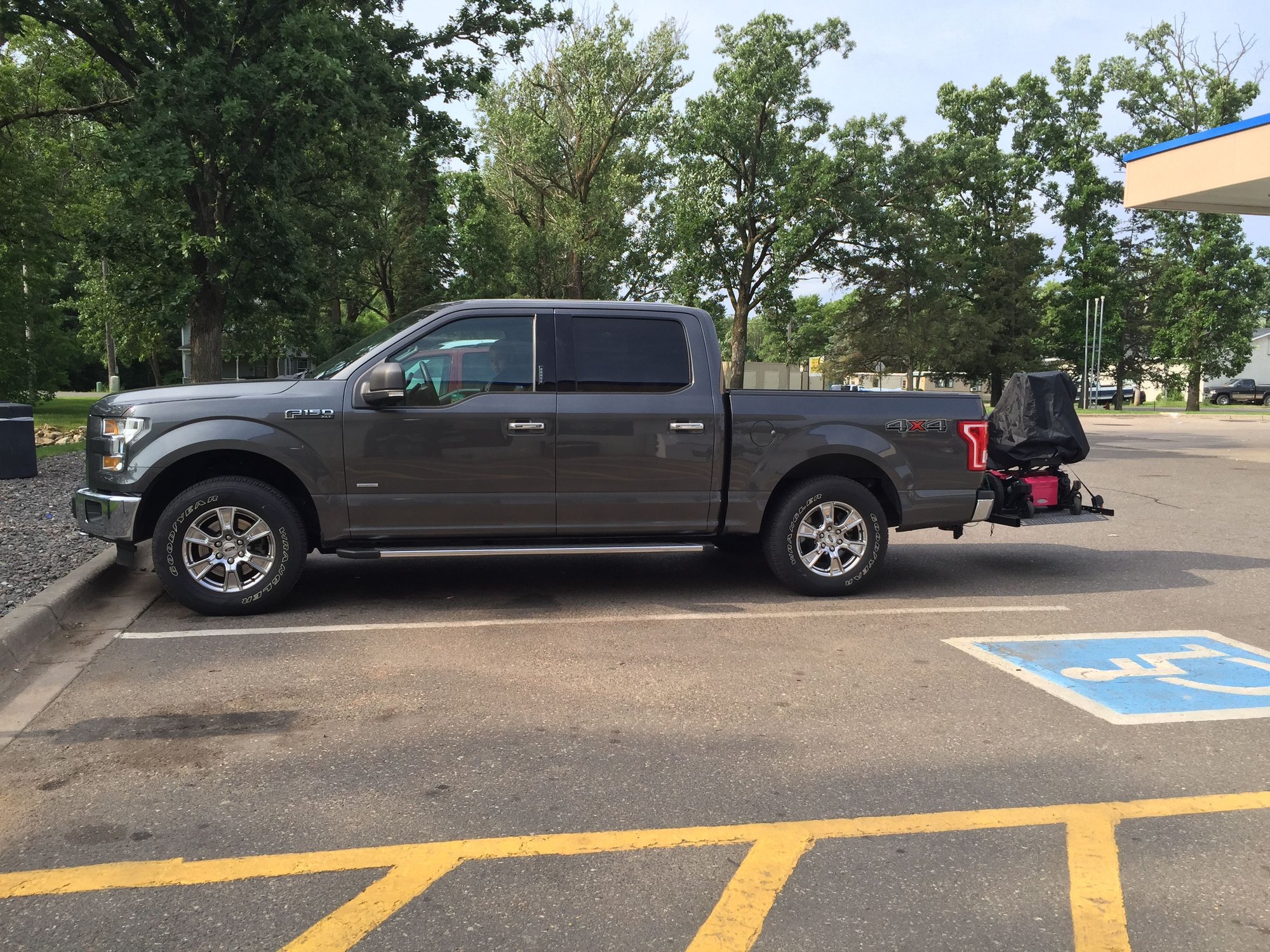

On Friday our van went into the shop, and my F150 suddenly needed to be able to carry our daughter's wheelchair around. Problem is the hitch was too high for the lift without an adapter, so I installed a poor-man's leveling kit. 8 bags of tube sand is 560 lbs, and it lowered the hitch almost two inches.
Add to that 480 lbs of lift and power wheelchair on the hitch, and you have a pretty decent load on the rear axle. Still had between 3-4" before hitting the stops, and of course it rode considerably better with that much weight over the axle.
Lots of folks talk about suspension sag, but not often are there hard numbers behind it. Thought you guys may find this interesting, I'm quite happy with how it rode and handled.

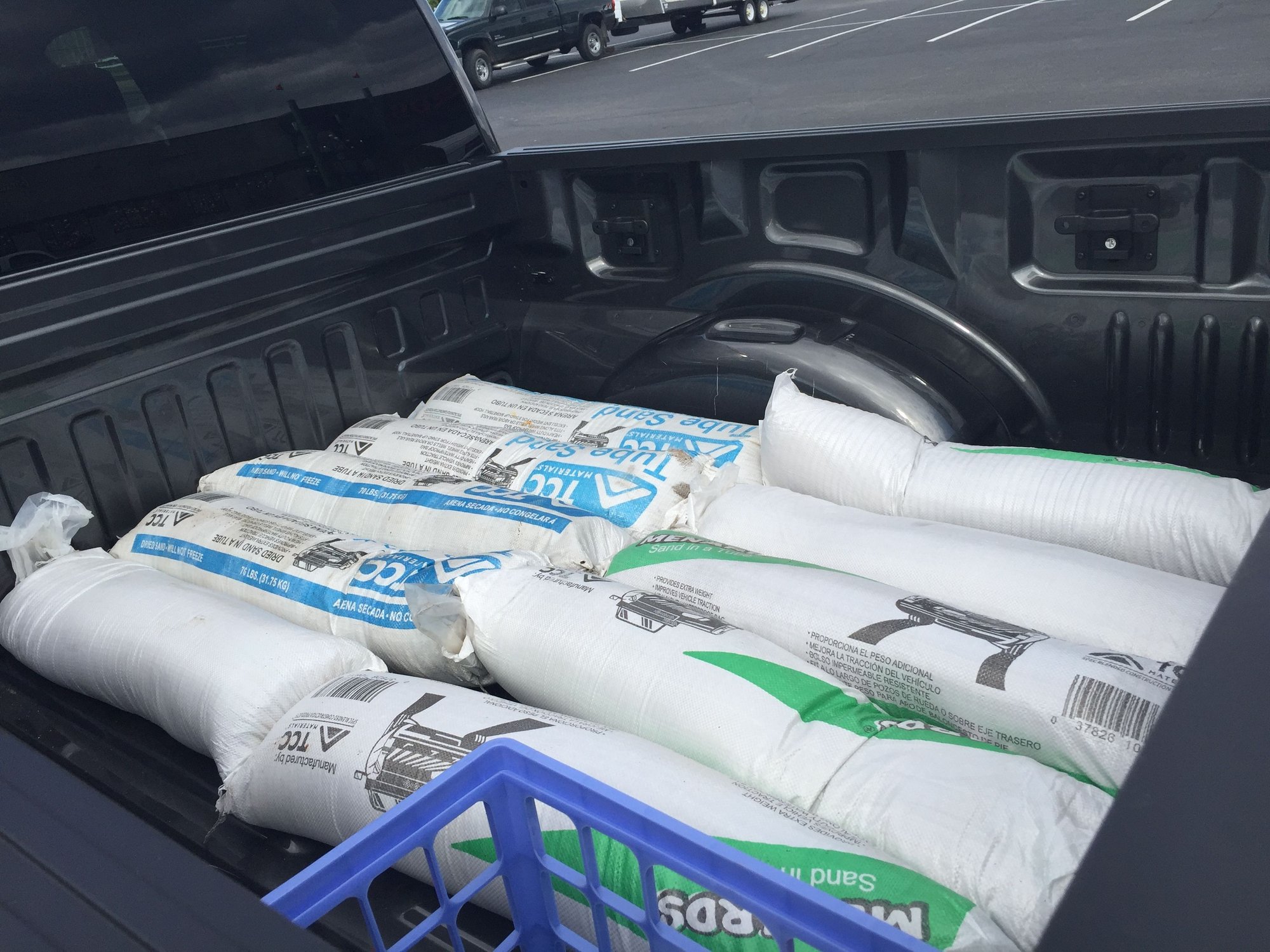

Thanks Tom for providing numbers, now I'm going to ask for a photo from above showing the placement of the sand in the bed. Was it up against the tailgate?

Hard for me to tell from the photo - did you end up with the truck being level overall, or is the rear now lower than the nose?
Just got to work, and I don't have the truck with me at the moment. Here's a photo just after I got the sand. I removed two of the rear bags after loading the chair and realizing I didn't need the hitch that low. So the photo in the OP is with the following configuration minus the two closest to the battery in the milk crate.
If that makes sense. Think I confused myself!
Tough to say for sure. I believe the rear is now slightly lower.
