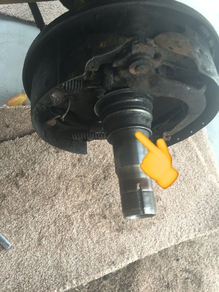

I was wondering if anyone know where to locate a part for my 86 f250 xl 4x4 7.5 10.25 rear ended
I have not found a place to get a new spindle or I may be wording it wrong I'll add a picture of the part

It's not a spindle and you aren't going to find it, as it's made as part of the axle housing.
Pic: WDD/WFD Sterling 10.25" rear axle.

Check your brake drum. See if the inner bearing came apart. In your picture it looks like the inner oil seal came out of the brake drum. That would be the part closest to the backing. The other part to the outside looks like the inner race for the rear bearing. If that is the case those parts should slide off. You might have to use pry bars or a puller. Check the diagram number dummy posted. # 1177 and 1244

Pic in post #2: 1177 is the axle seal .. 1243 is the inner bearing cup .. 1244 is the inner bearing.

No luck cutting off the inner bearing race? I remember the other post with the same pic.
