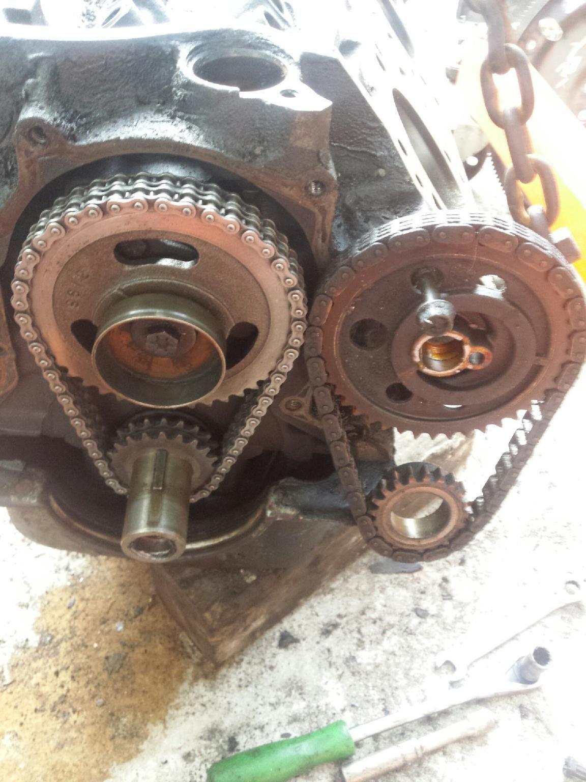

Was there a possibility of a nylon gear in '84 ? Both my original 302 and the replacement '87 had steel, so i'm not sure.
87 left...84 right
87 left...84 right
I'd have to think they quit using nylon long ago, but who knows. Until I open it up I won't know for sure. I remember taking apart the 460 on my '69 Mark III and saw nylon gears and I was amazed that they were still in perfect condition but still wondered how they could ever be so (and I hate to use this word) DUMB and think that would ever last.
