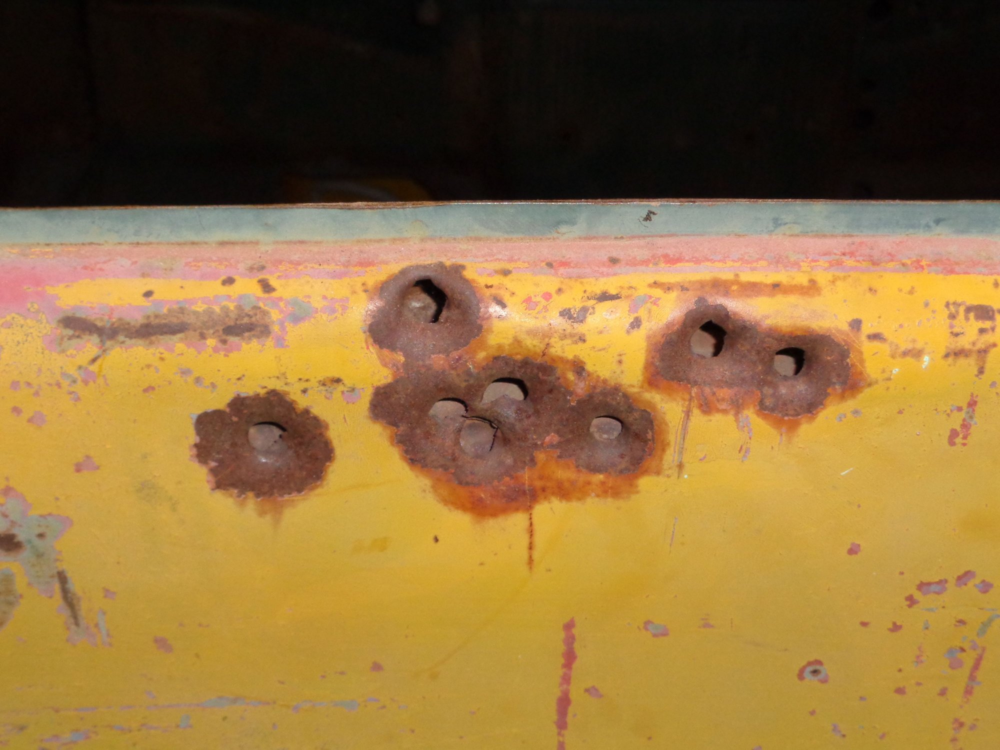

I'm starting to do some sanding and patching and whatnot on my new to me cab. Got these bullet holes to deal with. The rotten floor is good to go, Dash and doors are OK. But .... Wondering if I should sandblast these bullet holes then weld them shut. Body filler later to make smooth or just blast and body filler. Not looking to win any shows but don't want to go to all the trouble fixin' just to do it again later. Any advice is most appreciated.

thats a nice tight group, I would prefer to patch it up but might be lazy and just weld it up. I wouldn't just bondo them.
Old May 23, 2016 | 10:37 PM
tinman52's Avatar
tinman52
Welder User
Joined: Feb 2009
Posts: 5,269
Likes: 50
From: northwest MT
Bullet holes are difficult to fix because the metal stretches as the bullet goes through......Correct fix would be to cut the entire area out and replace. I may have a patch panel if you want to go that route.
Even welding up the holes will be a band aid repair, as the metal around them is distorted. Still better than just mud I suppose....

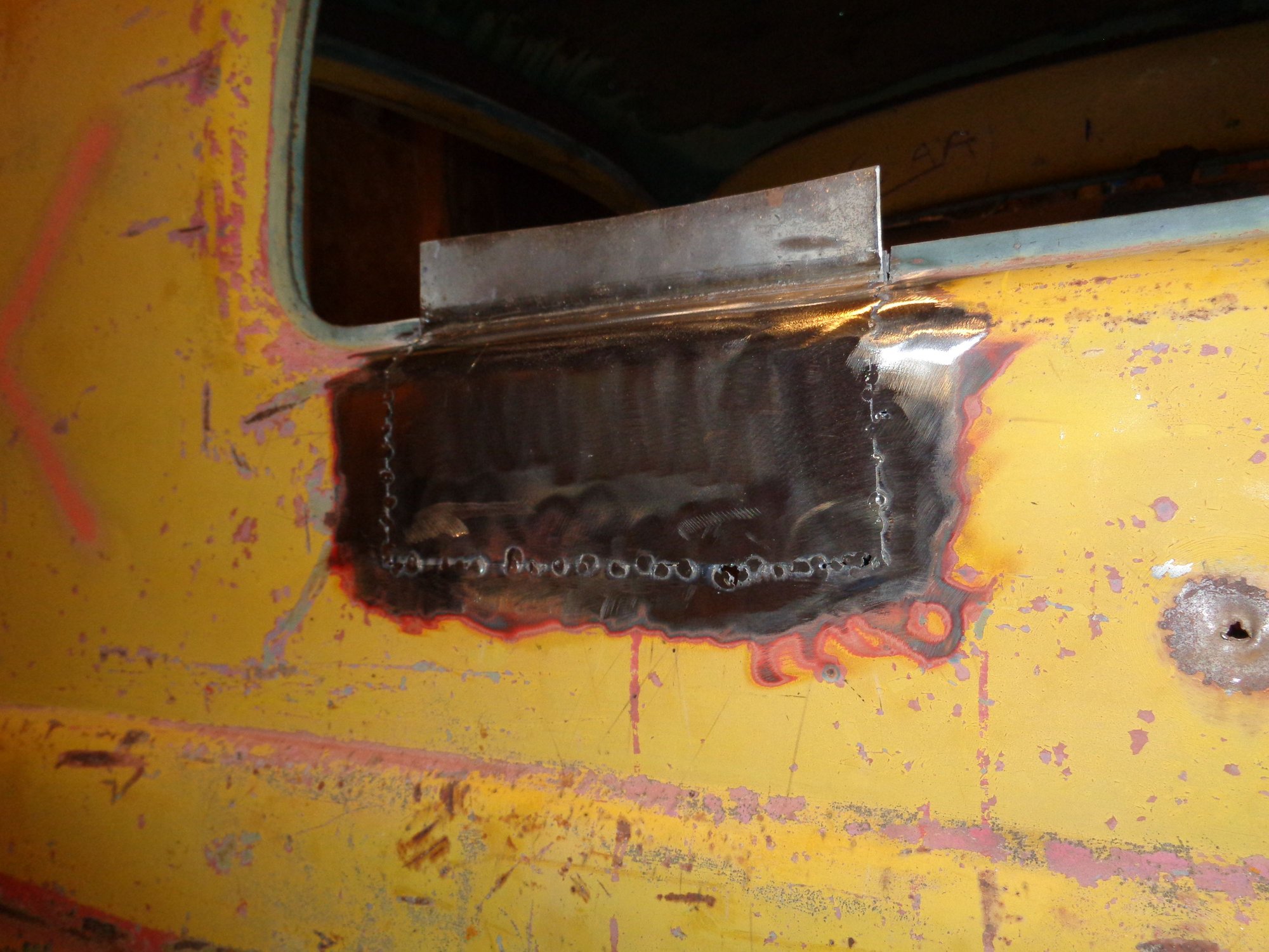

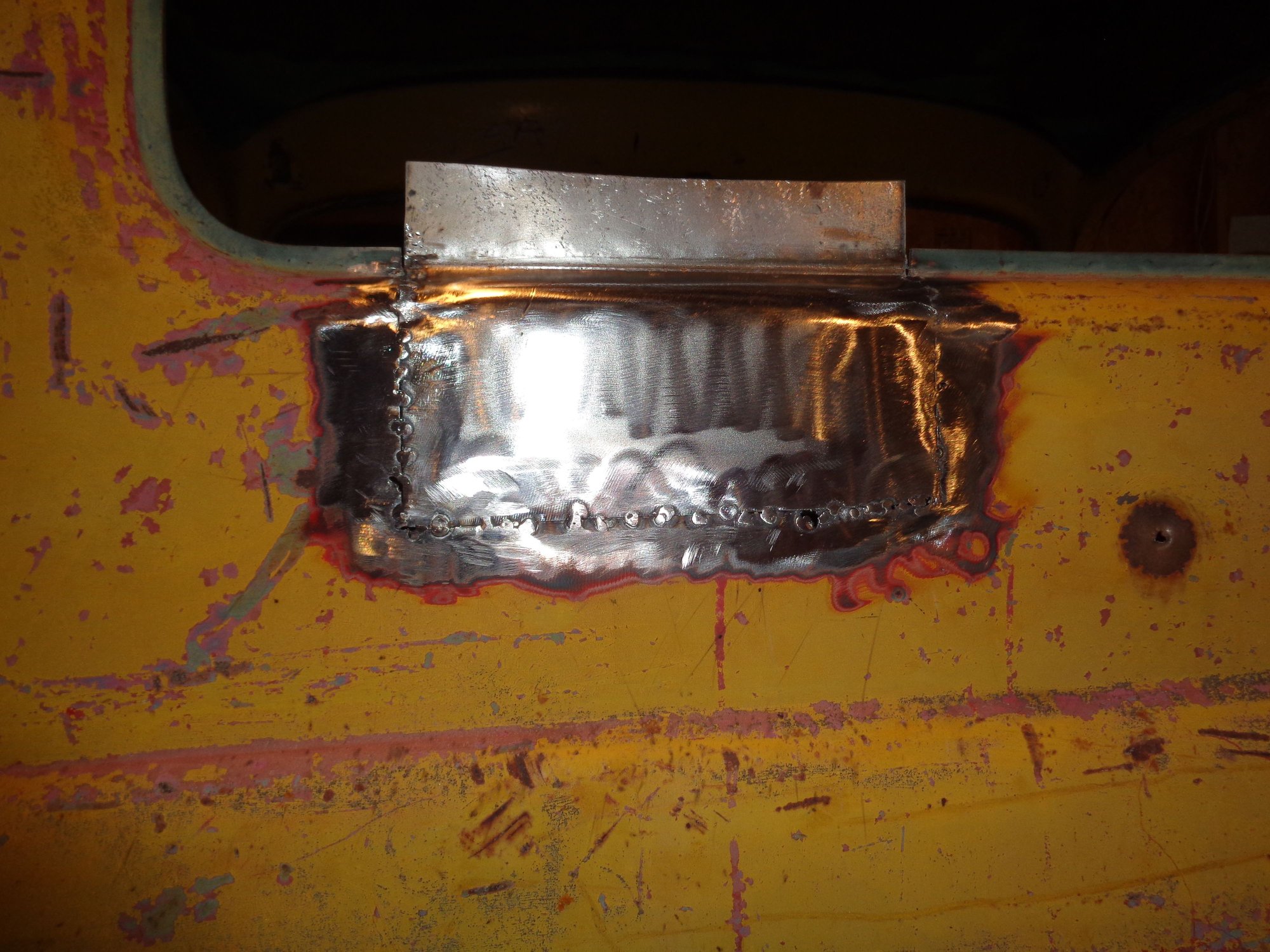

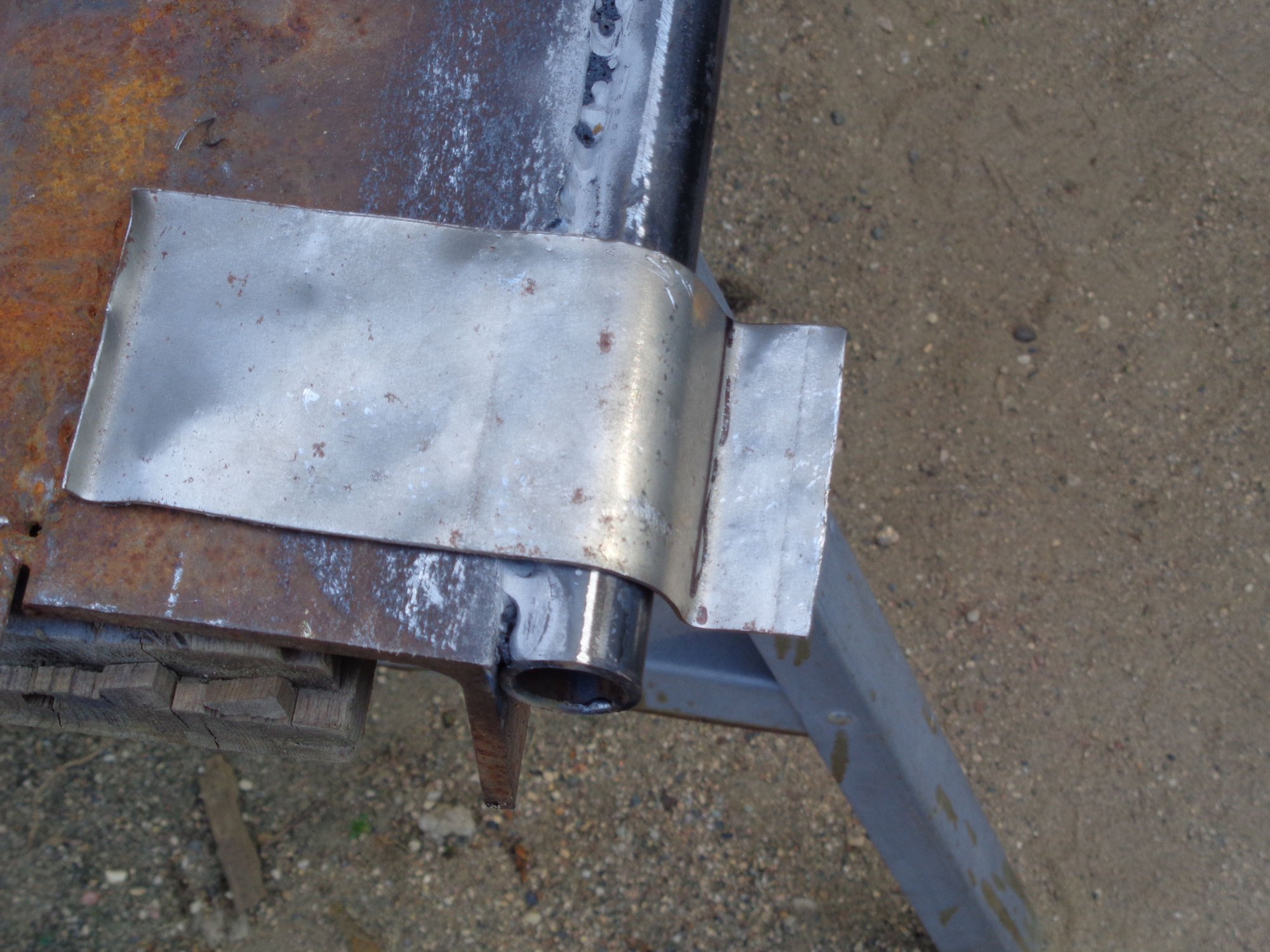

Well fellas, taking your advice I patched the holes instead of filling them. Made a homemade radius banger onner thing that worked pretty good.
banger onner thing. Kinda proud of this for some reason.

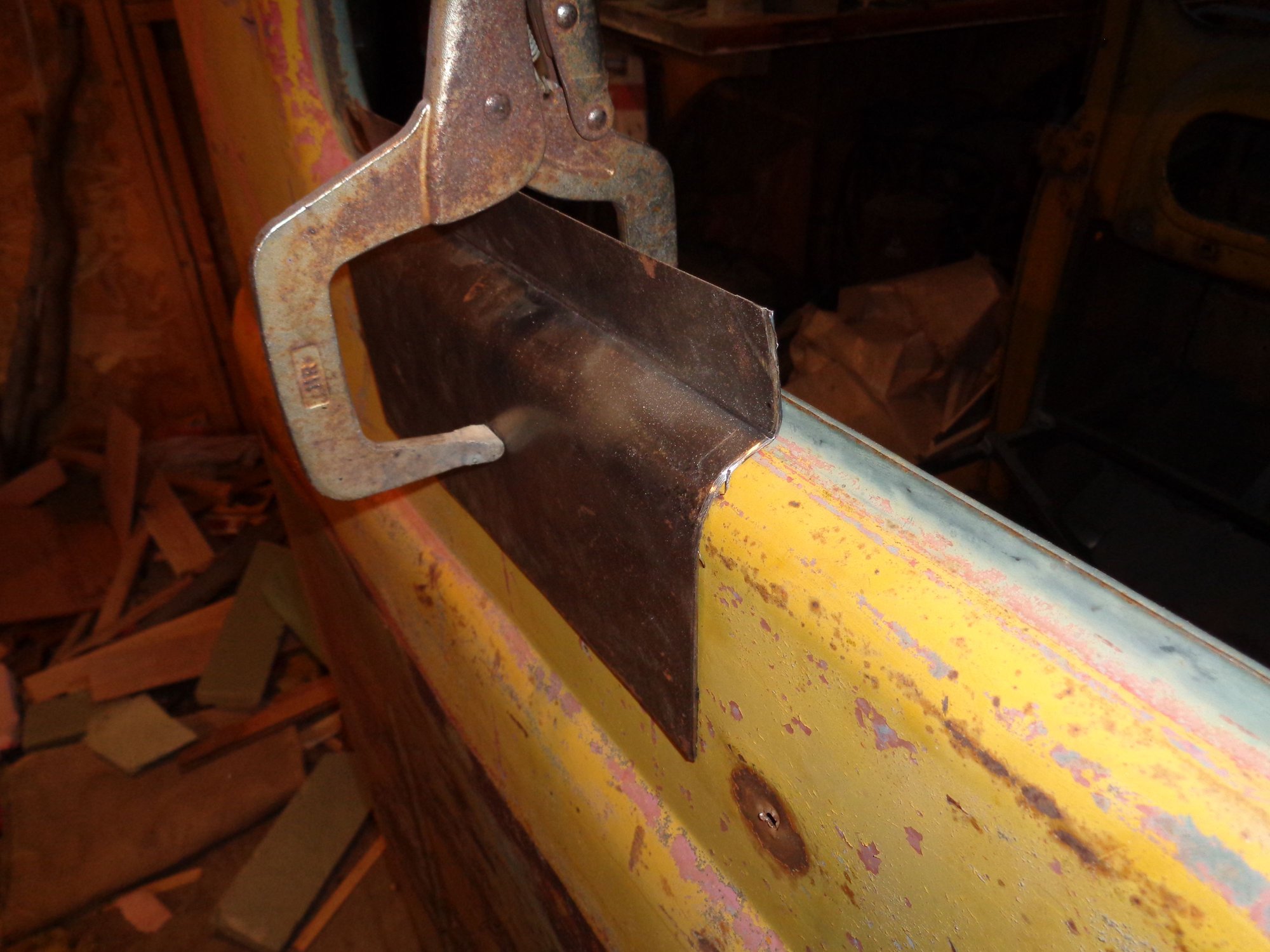

Test piece fitment. Excuse the grubby thumb, the other one wasn't much better.
Test fit for the real one.
Ready to receive.
9 down, 3 to go
Had the welder turned up too high and burned through in a couple spots. Spose I'll have to fix those too. Did I mention spot welds suck? Once again Thanks for the help guys.

Great radius bender. Use what you have, no need for expensive do-dads.
A suggestion.....
I used a piece of 1/4" copper bar I scrounged from an electricians pile of buss bars. I welded from the inside and backed up the other side with the copper bar. Makes a smoother weld on the outside and the bar absorbes a lot of heat and fewer burn thrus. Also a backer to hammer the welds.
Very little distortion and a paper thin coat of filler to smooth it out.
