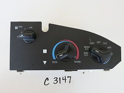

On our vans, the blower runs on low speed when the switch is on the first position, so it only stops when you put the right vent dial to completely off:
