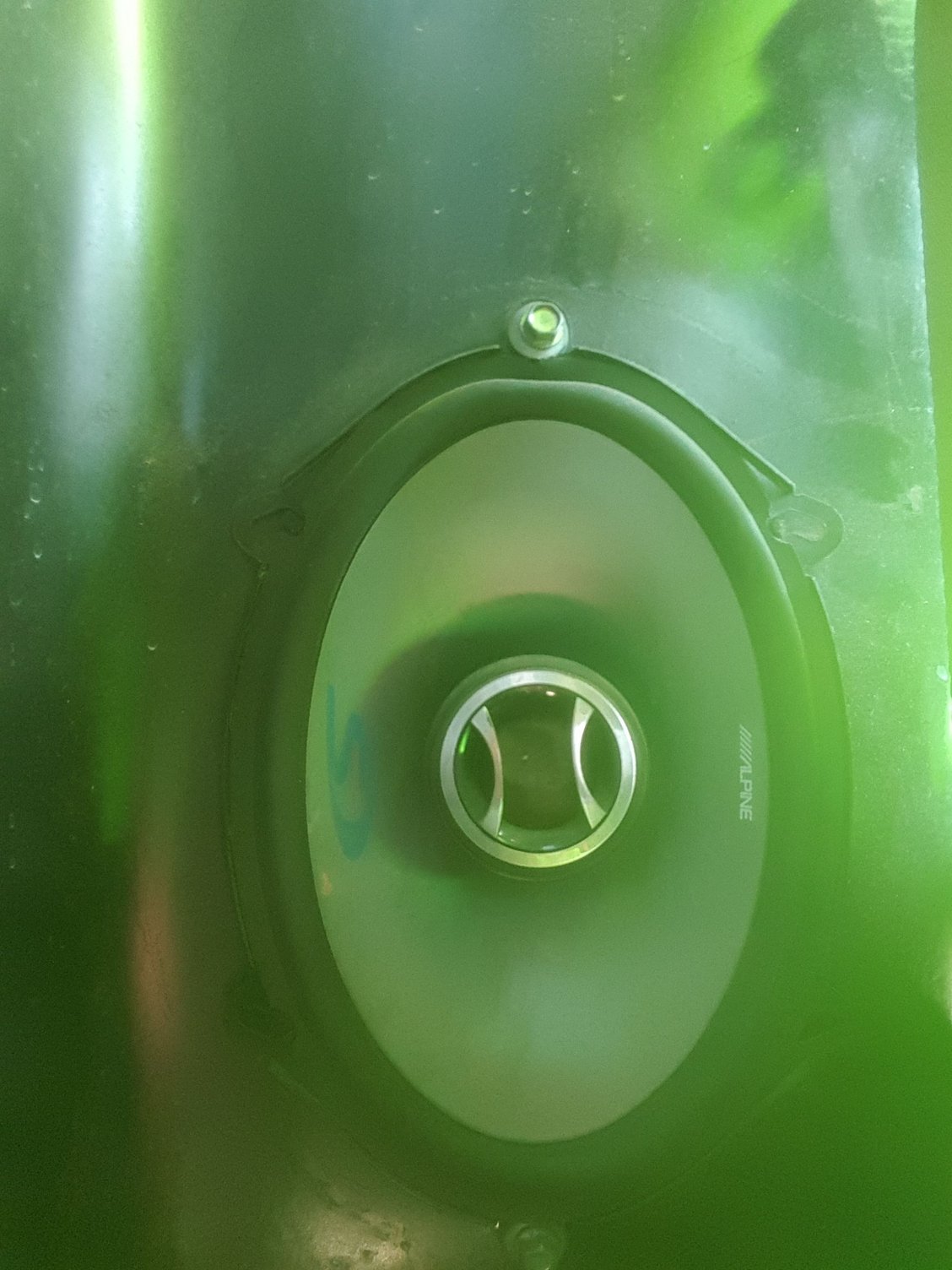

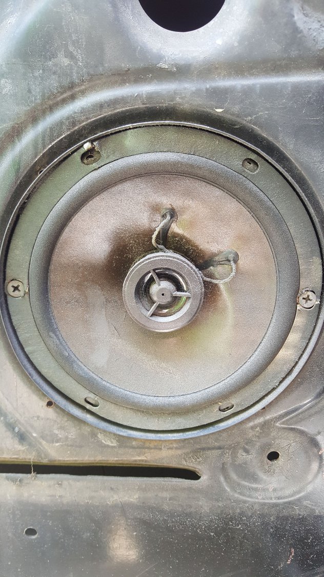

I have a 1979 f150 ranger lariat. I've only owned a short time, so I keep finding questions to ask. I took the door panels off and thereally is a speaker in each door. There's a 8 inch speaker wire hanging in door cut off smooth. There is no hole in front of door. Would this truck came from factory with speakers not hooked up? There is no speaker under dash, however there are 2 speakers mounted behind the seat into the wall of cab, flush mounted. Are these factory? It has an aftermarket Alpine stereo. Looking to replace with 79 original am/fm.

I've taken apart several 78/79's and I've never seen a set of factory door speakers until Friday when I saw a pair in a high end (Lariat or Ranger can't remember) cab I pulled door panels off of. Most trucks the screw holes have never had anything in them. You can verify they are factory as they have a Ford # on the back.
It's unlikely they were installed but not hooked up (but I can't rule it out).

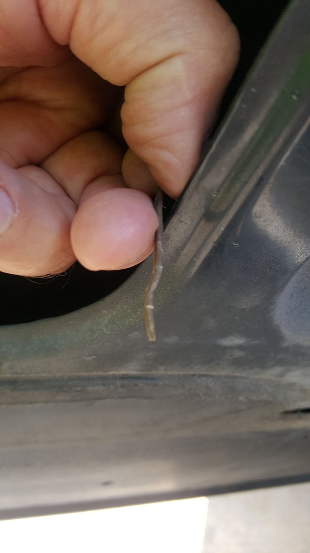

Door speaker
End of wire. Its a lot more than 8 inches
I answered my own question, the speakers are not factory.

Nope those are aftermarket coaxials! . Not sure why they weren't hooked up. Should sound a lot better than thirty five year old paper dual cones.

Okay thanks. There's no hole in the door for speaker wire to exit to the cab.
