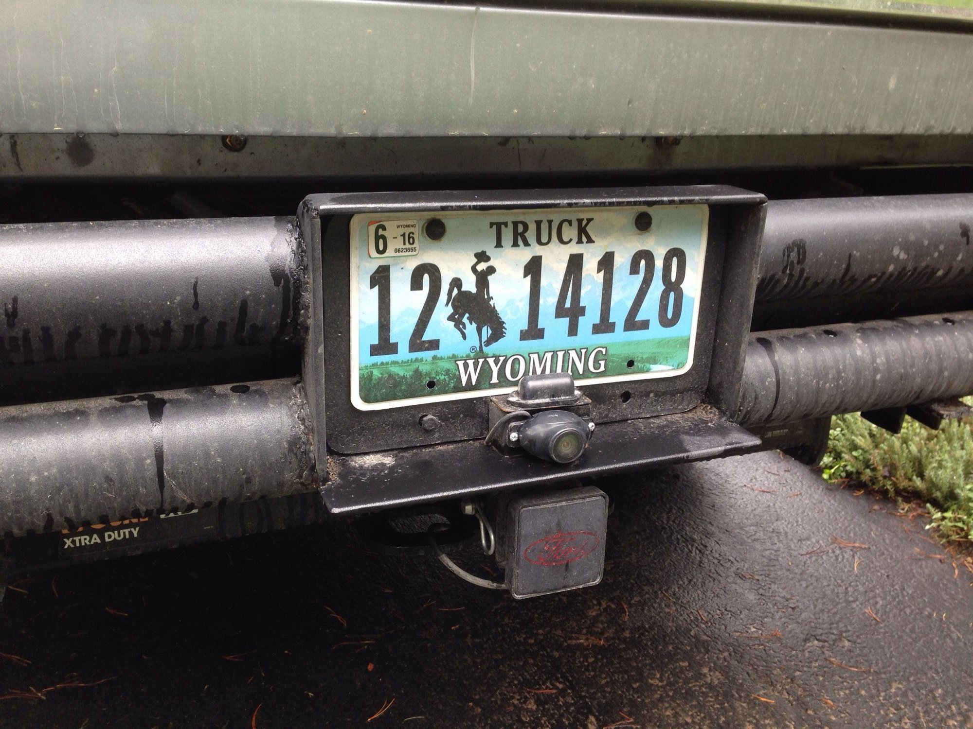

Here's a shot of the center section:
Backup camera and LED plate light

The only non-recycled materials in this build were the LED lights, and few bolts and nuts for the plate mount, the paint, the side steps, and a large quantity of welding rod. Everything else was leftover scrap from old projects (all flat stock) or salvaged from our home remodel (1/4" wall round tube). I tried to incorporate things I wanted from using trucks for work and play for years like the fold-down side steps, high-lift jack points, hidden 7-way trailer wiring and backup lights that actually illuminate what's behind the truck. I'm also pretty sure it won't dent if something hits it, unlike the factory bumpers. I still have one more piece of tube and some scrap left. My wife thinks I should fab up a front with a winch mount or 2" receiver. She is a bad influence.
