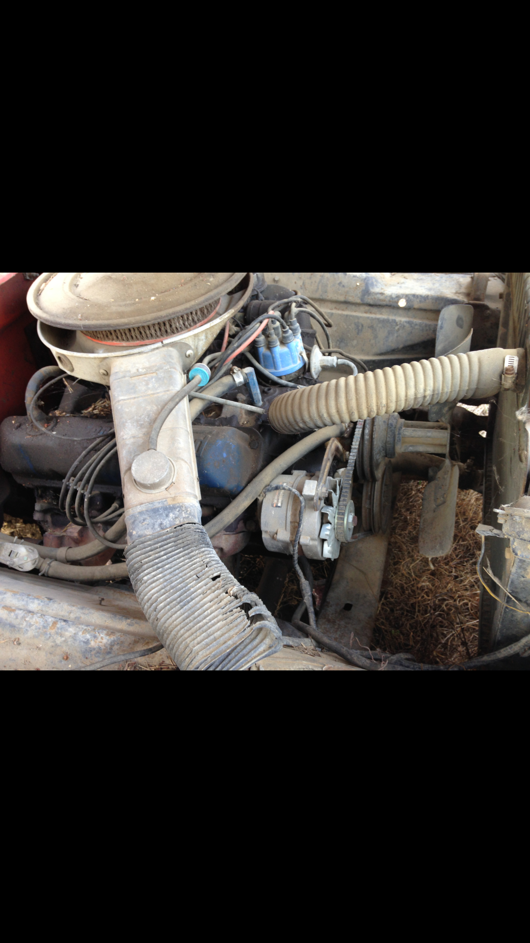

Here are some pictures If any of you were wondering

I t looks like the upper radiator hose goes into the top of the block so it definitely is a 351M/400 from the outside. The color is #1, Calypso Coral.

Look at the plugs. Look just under the valve covers. It's an FE motor.
Plugs are //\\. FE ONLY.
Intake extends under the valve cover. FE ONLY.
Exhaust ports are extended, 335 series don't gave that design.
Exhaust manifold is FE.

What does the FE mean? Is it better or something? My knowledge is pretty vague just started researching.

FE motors are more expensive to work on than certain other motors, but are reliable, capable of long life, or high performance, or something in the middle. The FE was intro'd in 1958, and the HP 427 version won Le Mans for Ford. So, the (probably) 360 or (if you are lucky)390 in that truck can be built (if needed) into a low speed slogger or a 500 horse monster.
What it can't be made to do is sip gas. But then a 400 has pretty much the same drinking habit, so don't worry about that.
Going back to your original thread I see it's an oil burner and not the good kind. As OEM, it would have been a 360. There were billions of these served, but they are getting on in years. You would have to do a tear down to see what the issue is with yours. It could be valve seals, but they usually don't cause massive oil use. Worn rings can be replaced, but a broken ring might have taken the block out of play.
Any year from '65 up, 352, 360, 390, will bolt right in and use all your existing accessories, clutch, flywheel etc. 410s and 428s would have a flywheel issue due to balance. (short version explanation)
