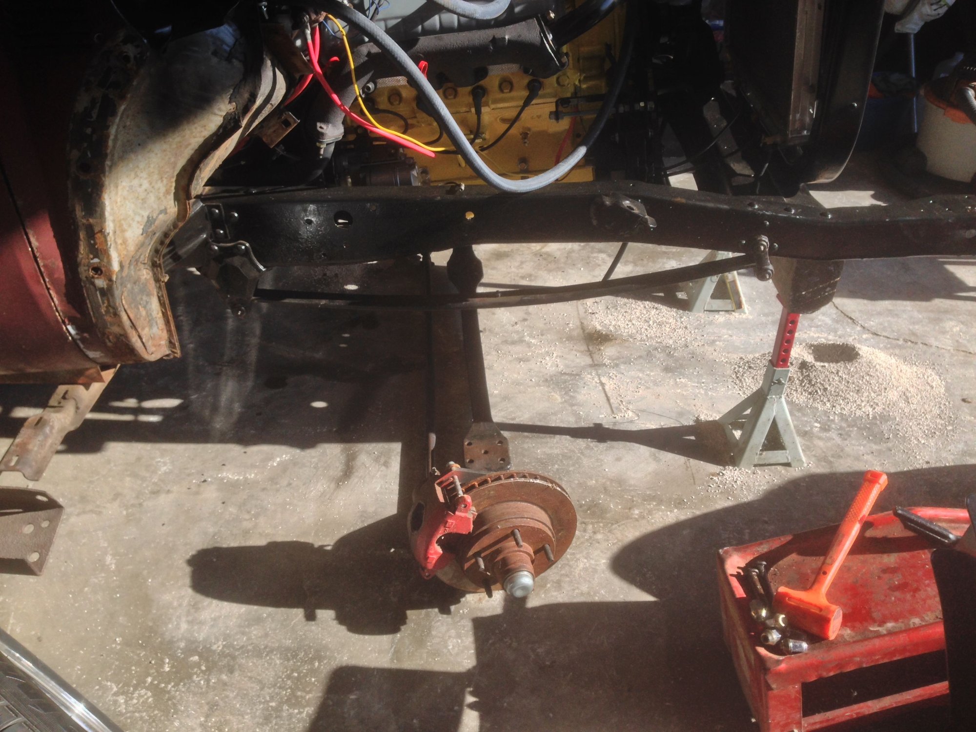

Thought since I was installing the rebuilt engine, C4, power brakes & power steering I might as well install the front axle and disk brake set up I bought a few years back.
Removing the old axle was a breeze.

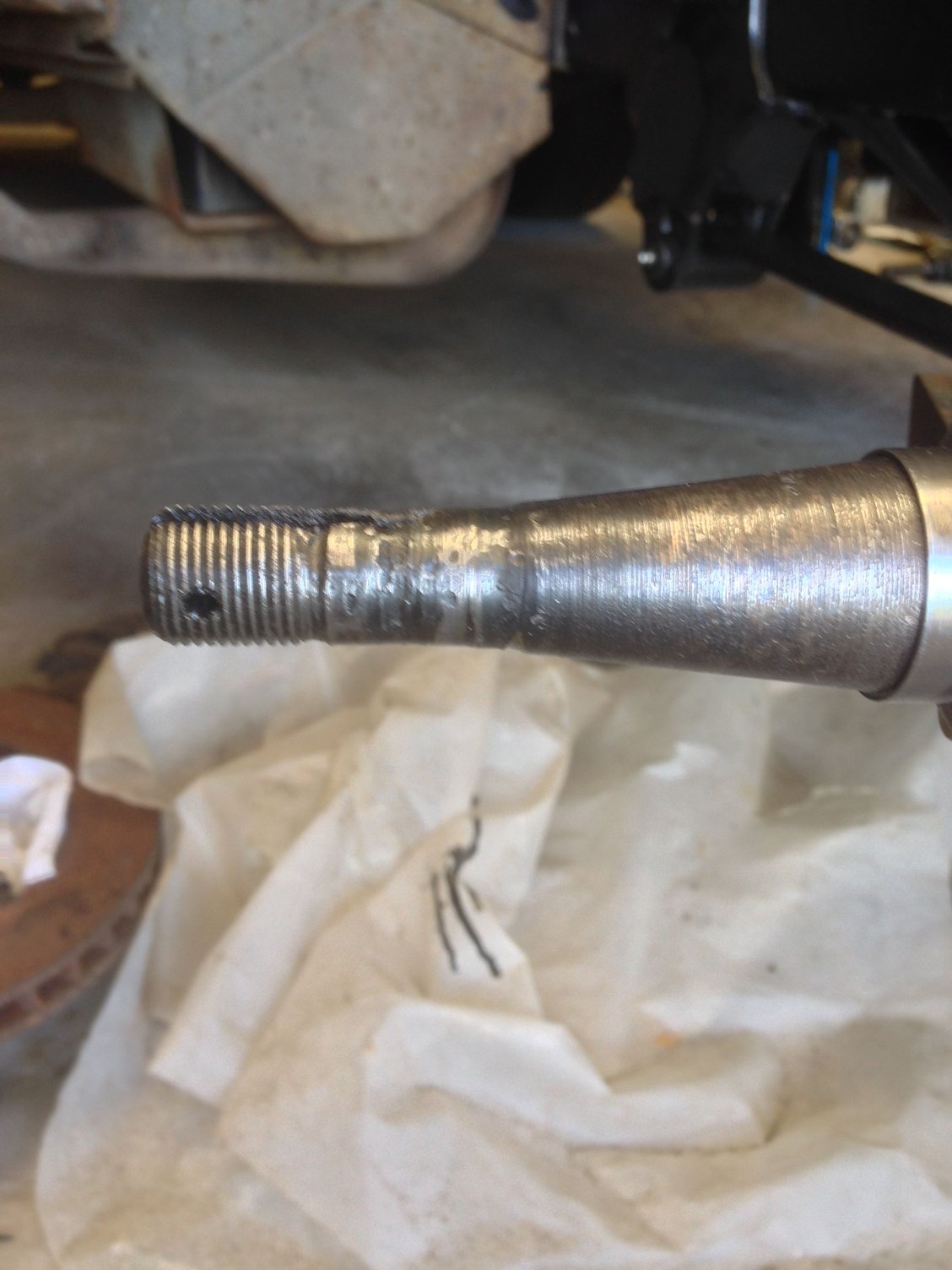

installed the axle with the disc brakes. Installation went well. Then I decided to pack the wheel bearings.
Soooo I'll be reinstalling the old axle that I had already installed new kingpins in.

That sucks on the spindle!
You can just transfer the disk brake kit over to the old axle right?

Yes I'm in the process of removing the inner bearing adapters from the bad spindle and installing on my old spindle. Just sucks to have installed the other axle before I realized the spindle was bad. Guess I ought to be glad I decided to repackage the wheel bearings now. I could have been out on the road when the spindle messed up on me.

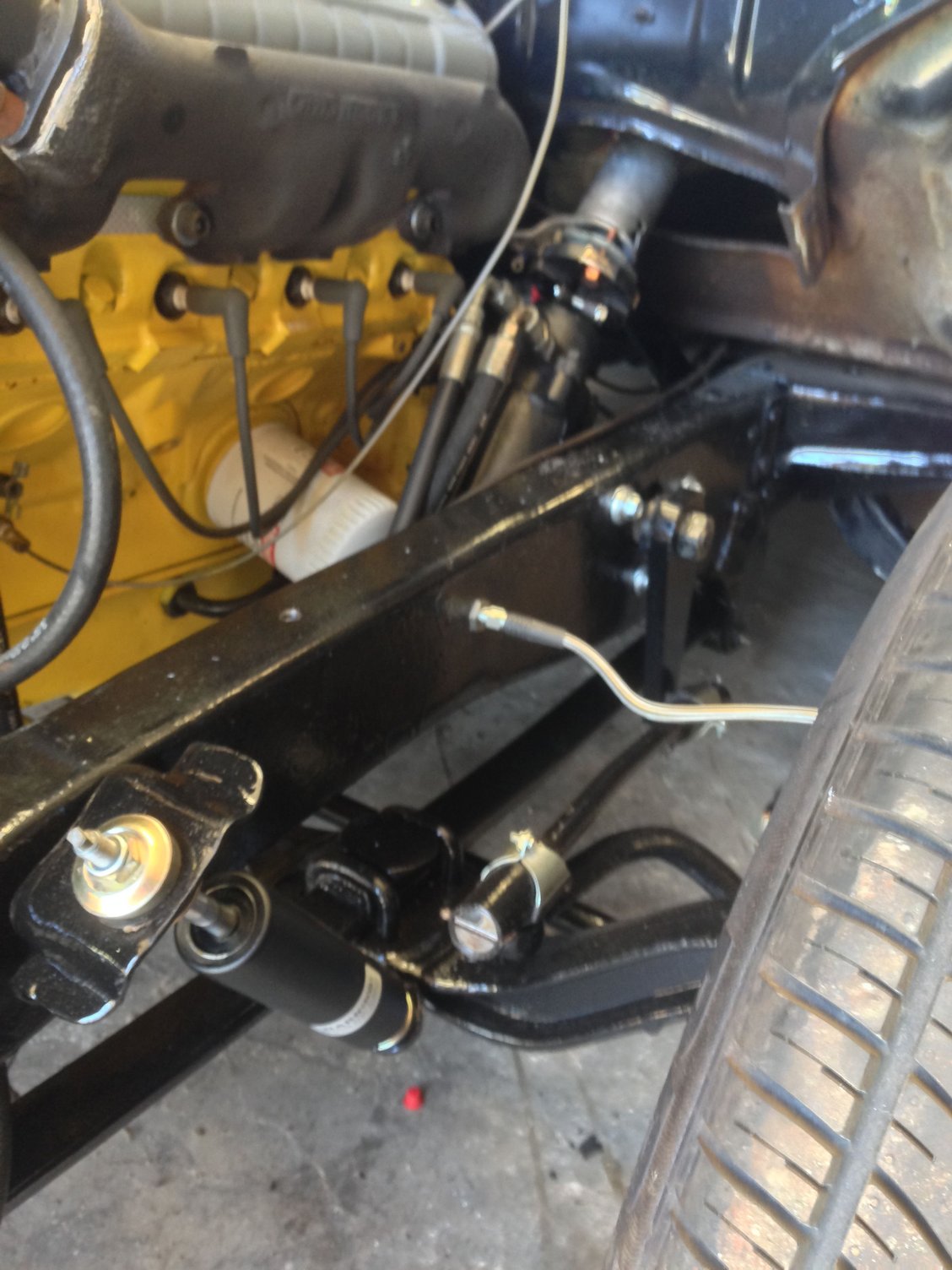

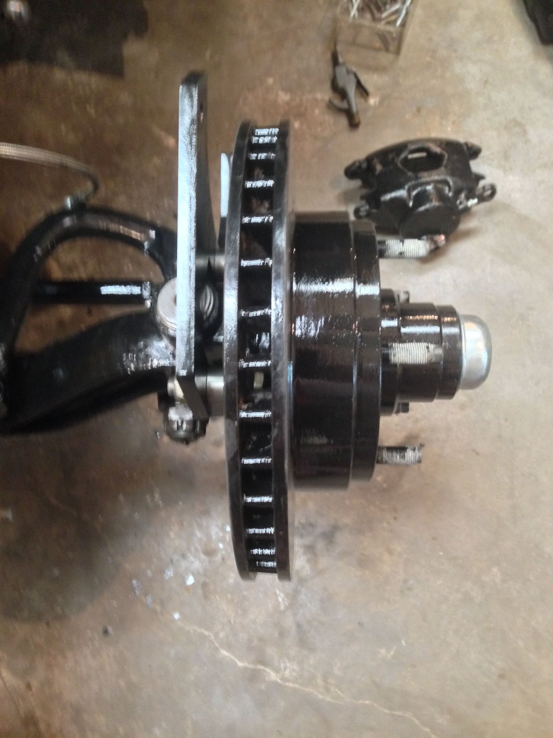

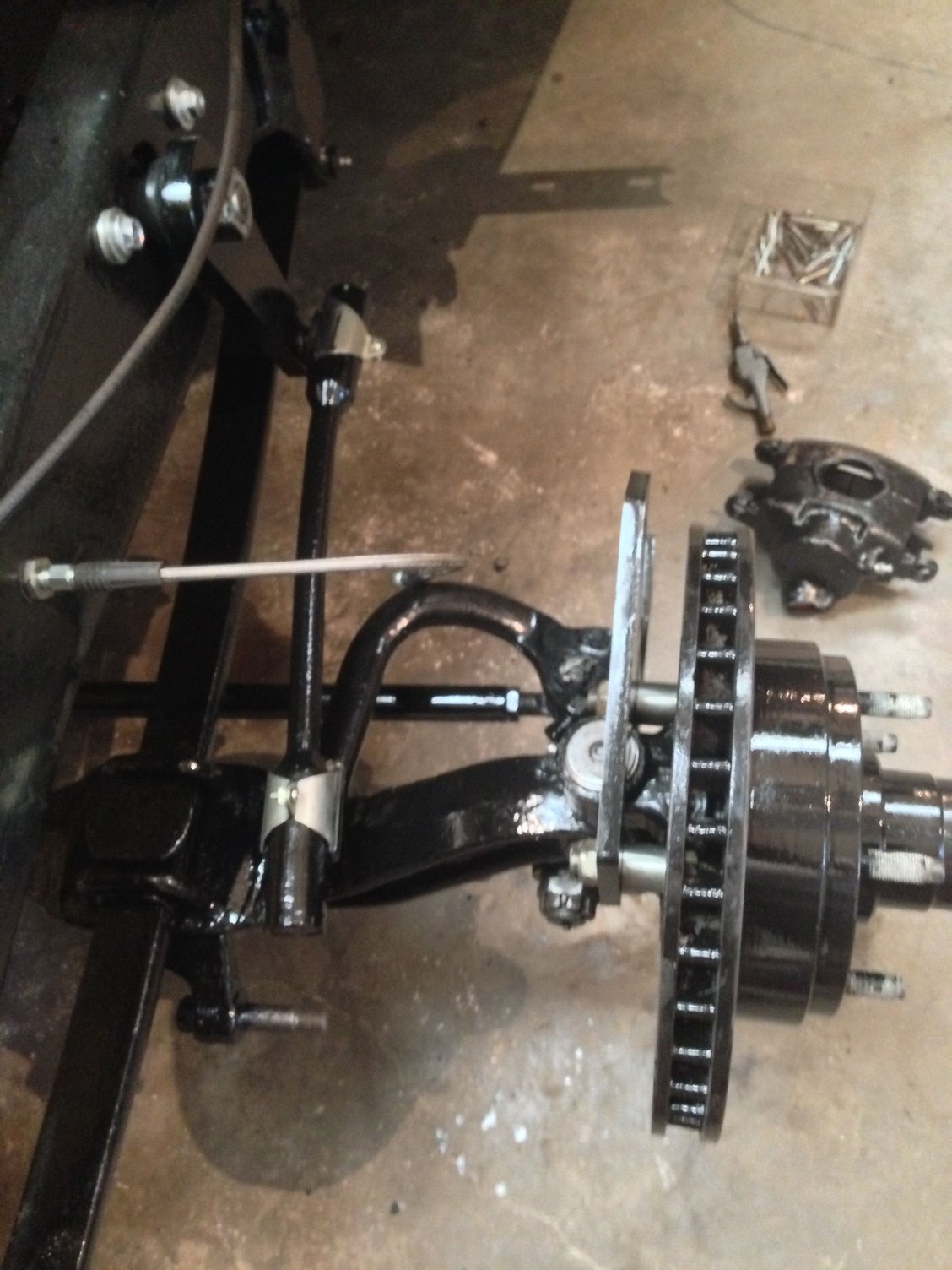

Got the ole trucks front end back together with new disk brakes. Rebuilt the drag link and replaced the boots. Also replaced the front chassis bushings for the leaf springs.
[I]Rotor & caliper bracket installed.[/I
Draglink installed with new boots.

Nice, looks good (and clean)!

Yes since I had down time waiting for parts I cleaned it and painted it with POR15.

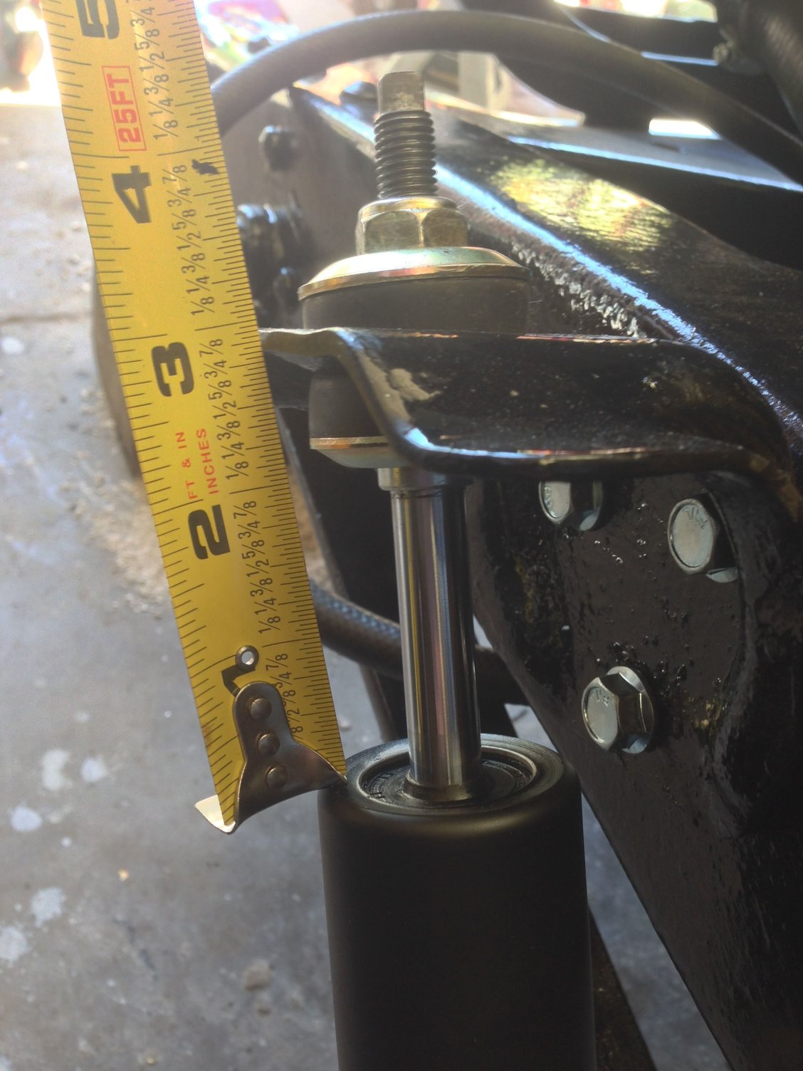

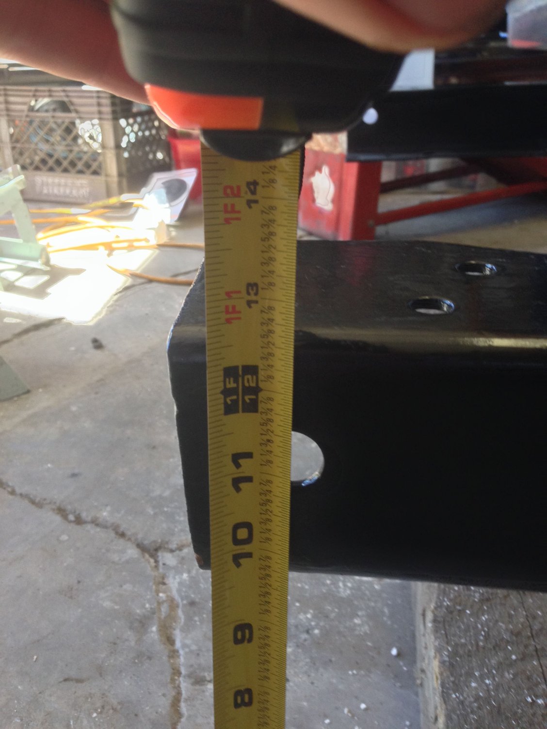

Got a little more done today and ran across something a bit puzzling. According to Midfifty's ride height calculator Lowering Calculator - Mid Fifty F-100 Parts I should be at 16 1/2" to the top of my frame. I'm barely pushing 12 3/4". The only change I made was changing to the mono front spring
This leaves me with a little less than 2" upward travel.

Is it possible to move the upper shock bracket higher on the frame to get more travel?
