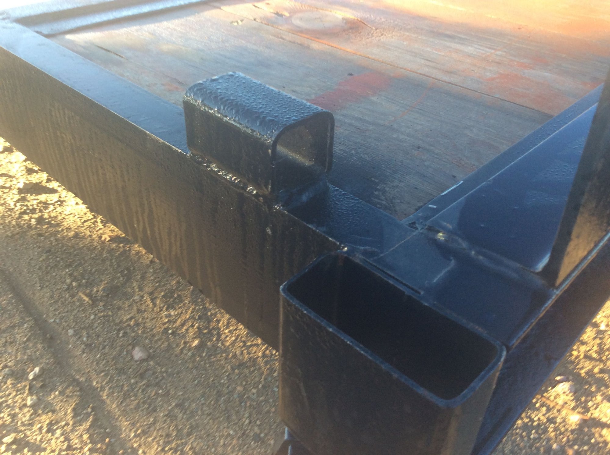

With stake pockets and no D rings, I welded some short pieces of 1/4 wall 2" square tubing right to the frame rail on each corner of my trailer like shown in the picture. That way one can use ratchet straps with regular ends without chafing the straps.
That looks like a pretty solid mount to strap to. I like it. Might have to do something similar.

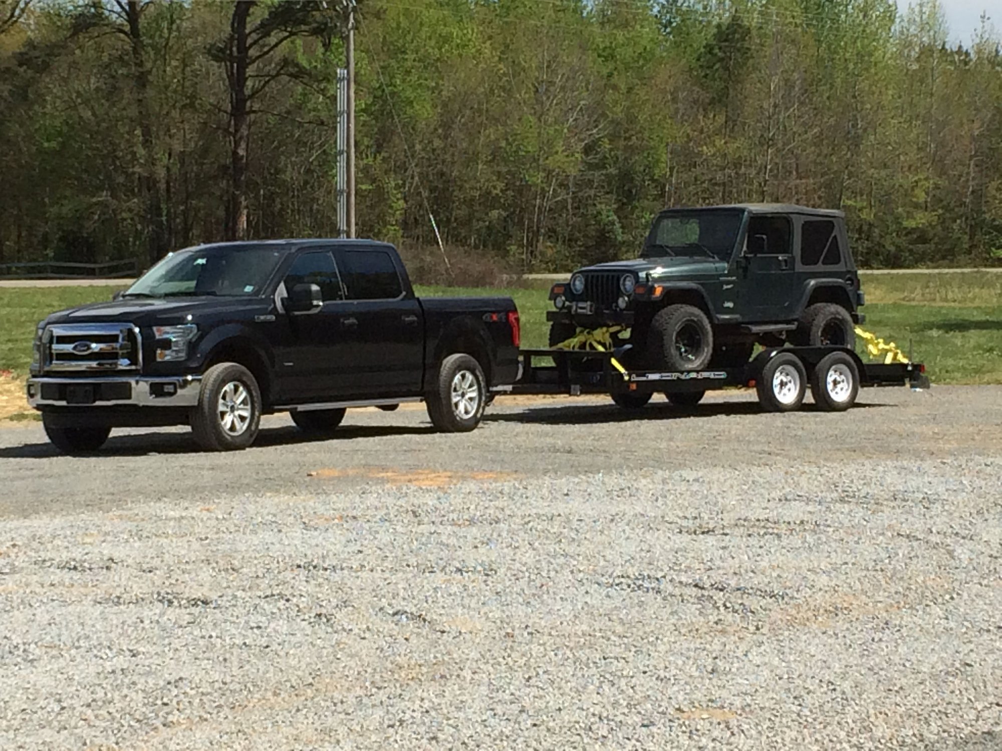

So time was running short, and i didn't find any axle straps in the small little town that I live in, so I grabbed some 3300 lb ratchet straps from Tractor Supply. They had them miss priced I think 14$ for 4. I also found tie down holes in the frame of the jeep. Ran the ratchet straps from the holes through the stake pockets up and around. It held great.
Marty (FordXFour) from FTE went with us, and being a retired truck driver, had plenty of knowledge to share. The way down the jeep and trailer handled pretty well, except for when I went to pass a rig in a curve doing 70, then she decided to get squirrelly on me.
On the way back, the trailer was doing a lot of nose dives when I braked, so we stopped and bumped the jeep back about 6 inches or so, which cured that and it drove smooth.

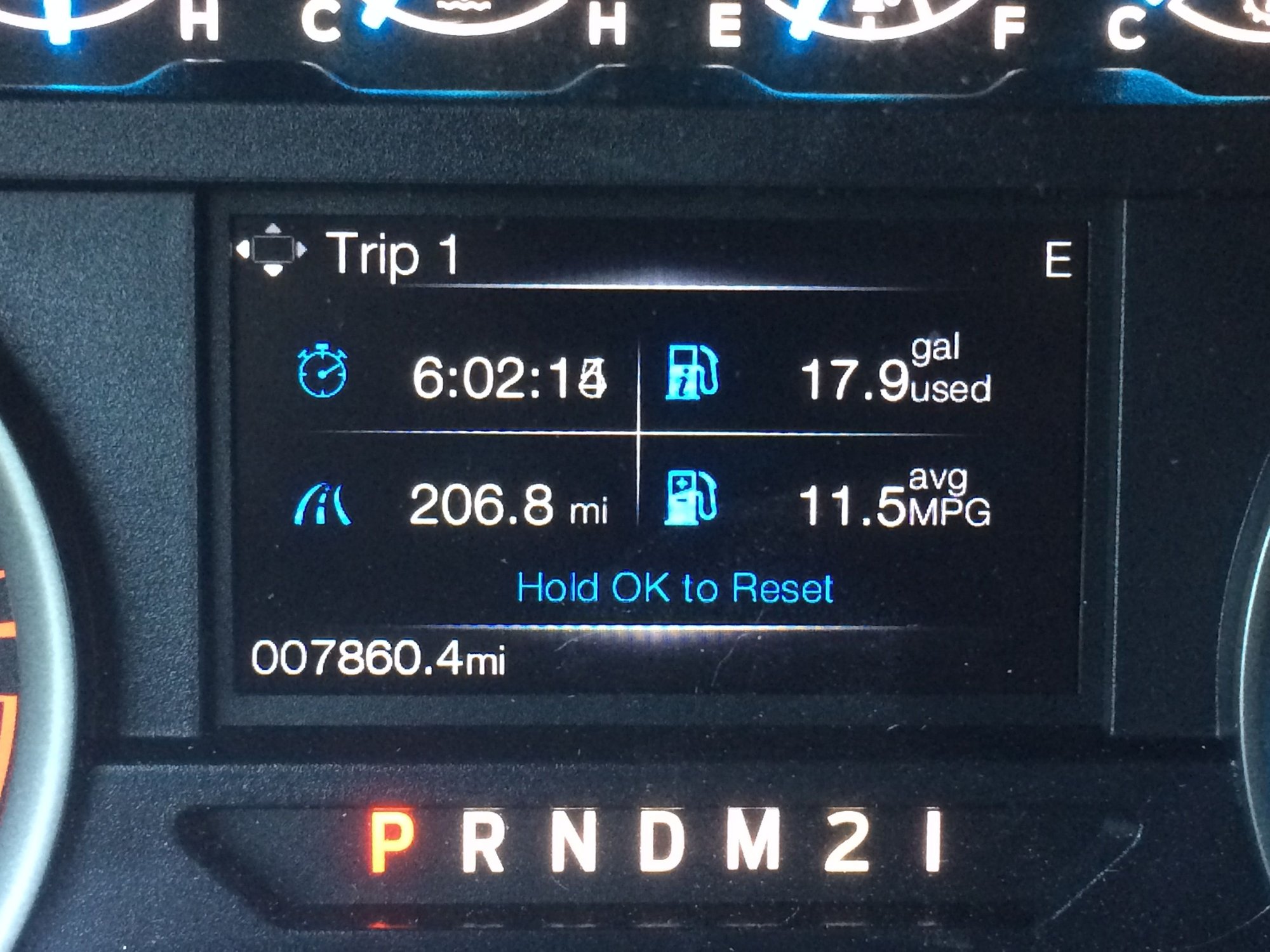

Kept 12 mpg until I tried to see how the setup would do running 75. It got real loose, and gas mileage went down a bit, so I dropped it back to 70 and it smoothed right on out.
Marty also suggested slightly less of a drop on the hitch, maybe 2 inches instead of 4.
