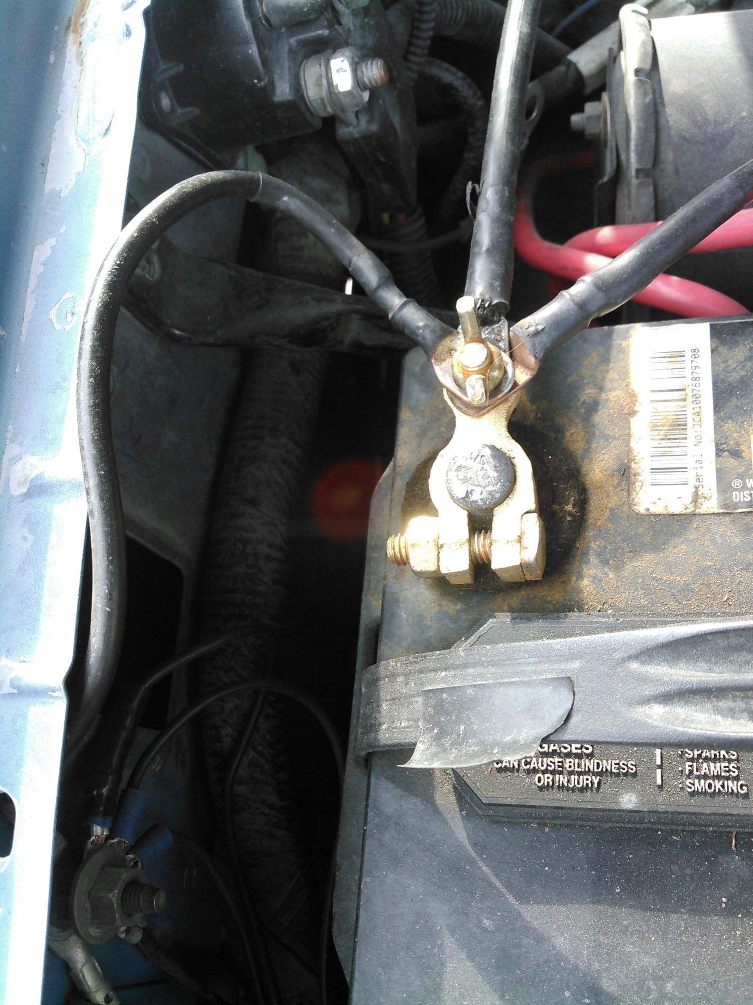

I made an entire new cable at a Big Rig shop with soldered ends.
Next I took the spare cable from the truck and added it to the other truck.
I will post pics a little later to give you an idea.

Here's a few pics
I have 2/0 running to the starter
4 ga. To the fender-mounted relay
2 ga. To the 3G alternator

That looks like exactly what I'm trying for, do you remember the lengths off hand?
You said 48" up above but I think that would only cover one of the cables.
