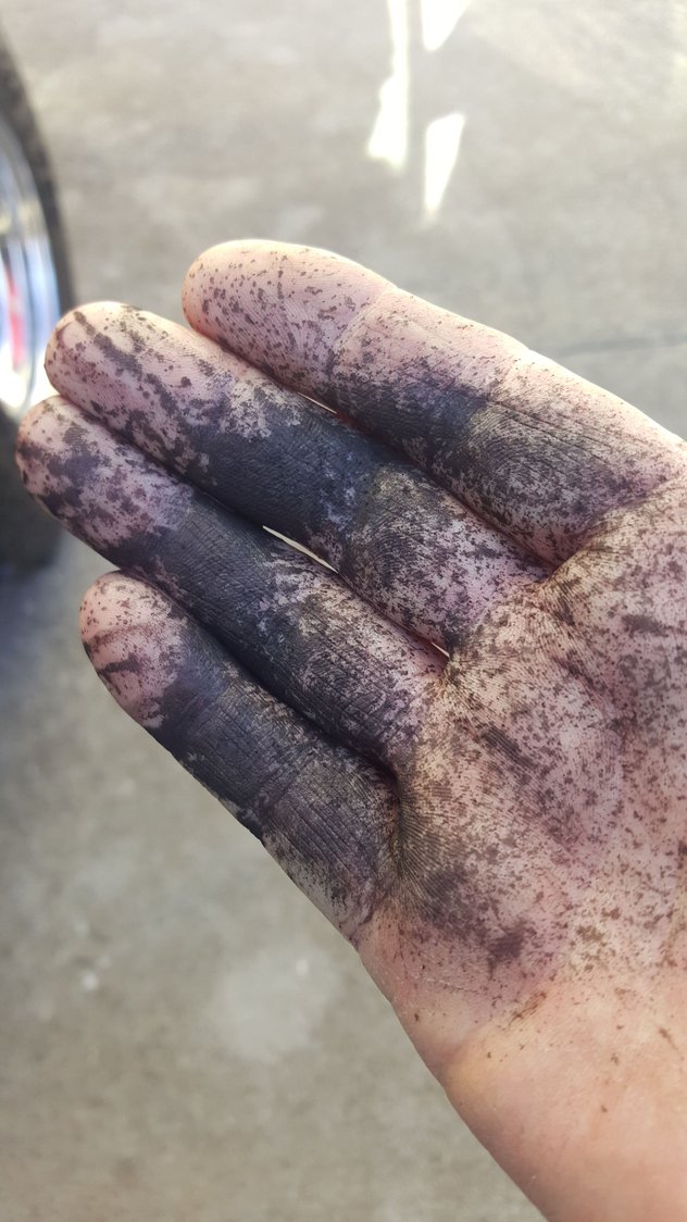

OK I will check plugs tomorrow. I'm glad to hear of air pockets. When truck starts in morning it's like most vehicles in mornings. The smoke did not go away after a short drive (5 miles). I do not notice any smoke going down the road, only while idling. No sweet smell. Just smells like exhaust if you were inside a closed garage. This come out of exhaust for about 3 minutes when first started this evening. I had driven approximately 8 miles 7 hours earlier. That's black water. No smell.
