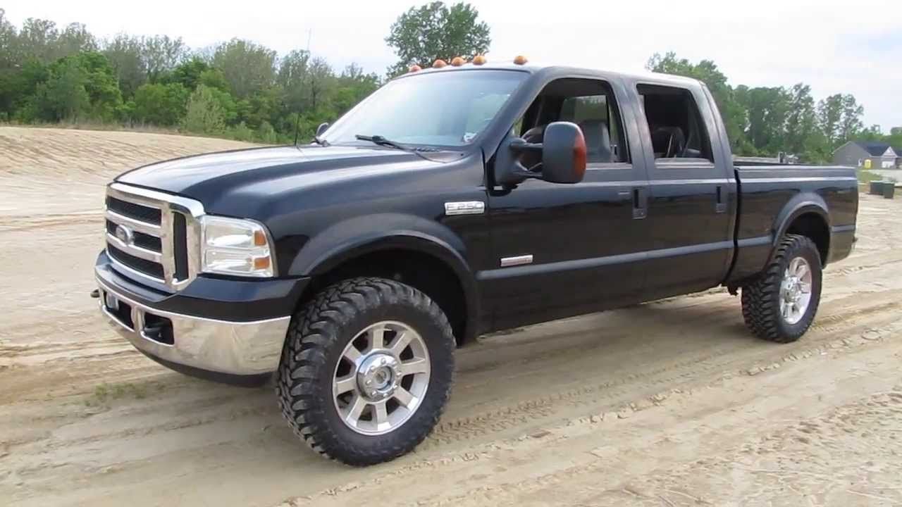

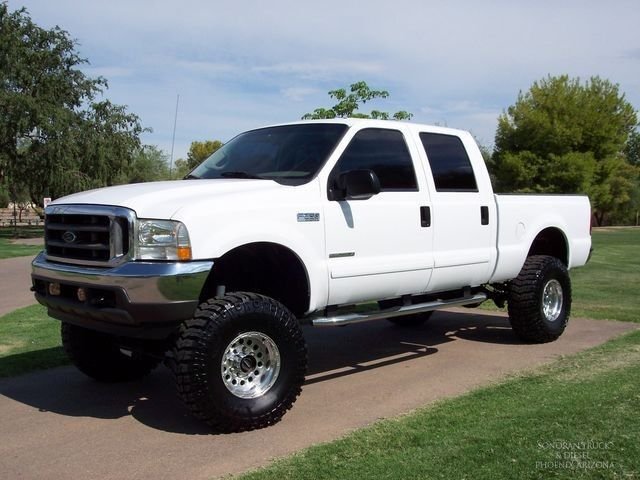

I've asked this question before, but I think I got the wrong answer. Are the headlights of a 2007 superduty and a 2002 ford superduty the same? They look the same except the 2007 one is more shiny.
