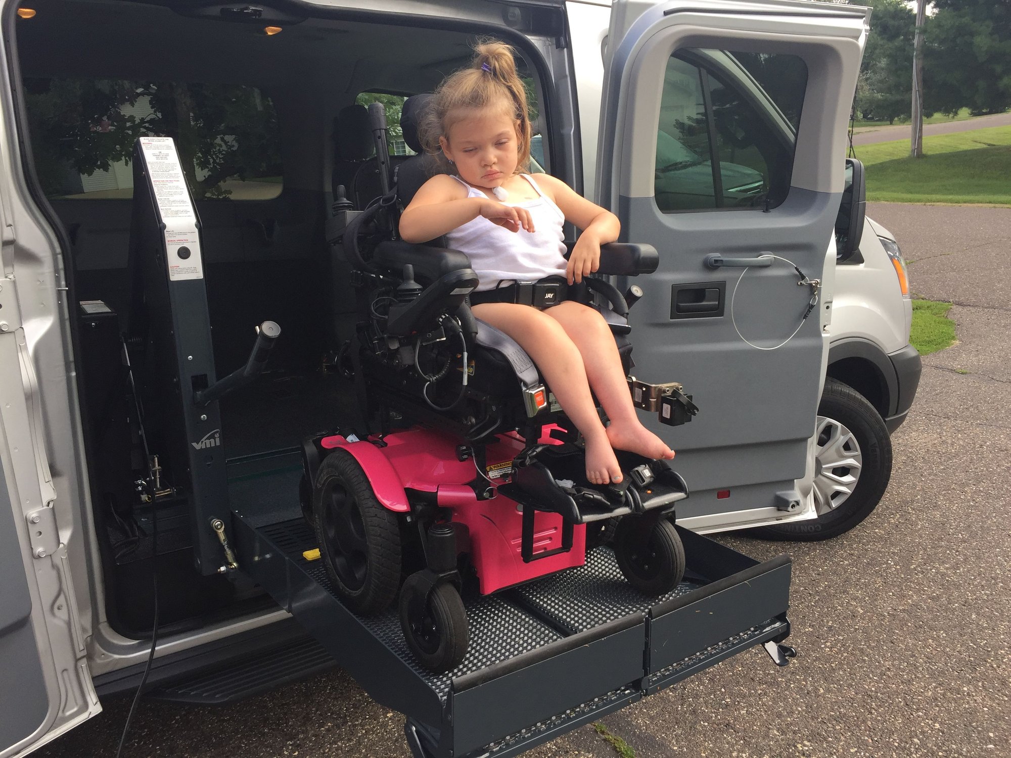

Lift is installed!
Picked up our van yesterday and couldn't be happier with it. Looks like they did a great job, and my time with that loaner minivan made me feel a lot better about our decision to get the full-size van.
Have to say that Rollx is a classy outfit; they didn't seem to cut any corners despite shaving $4,000 off their bid to win the contract. They detailed the entire van, weighed it, replaced the payload sticker to account for the extra weight, and performed a 4-wheel alignment. Extremely pleased with how this all turned out!

What's the cables on the doors for?
Old Aug 13, 2016 | 10:07 PM
  #50
Tom's Avatar
Tom
Joined: Aug 2003
Posts: 25,479
Likes: 742
From: Isanti, MN
They installed those to hold the doors open for windy days or when parking on grades. They hook onto metal loops in the wheel wells.

Yea, power doors are another $1500 and something i really need, had to cut a hole in the floor of the lift so i can reach through and open the doors and i use a couple shoelaces to pull them shut..

Very interesting Gman, that's a clever solution. We were fortunate enough to have a state program that paid for what we were asking for, and the sliding lift stows out of the way of the front door. We didn't want to have to bring the lift down every time we opened the door, and so far this works well for our situation.
Stuff is pricey though. Total conversion cost was around $10,860 if I remember right. Two out of the three bids were initially $14,000, and the place we chose cut their bid to get the contract.

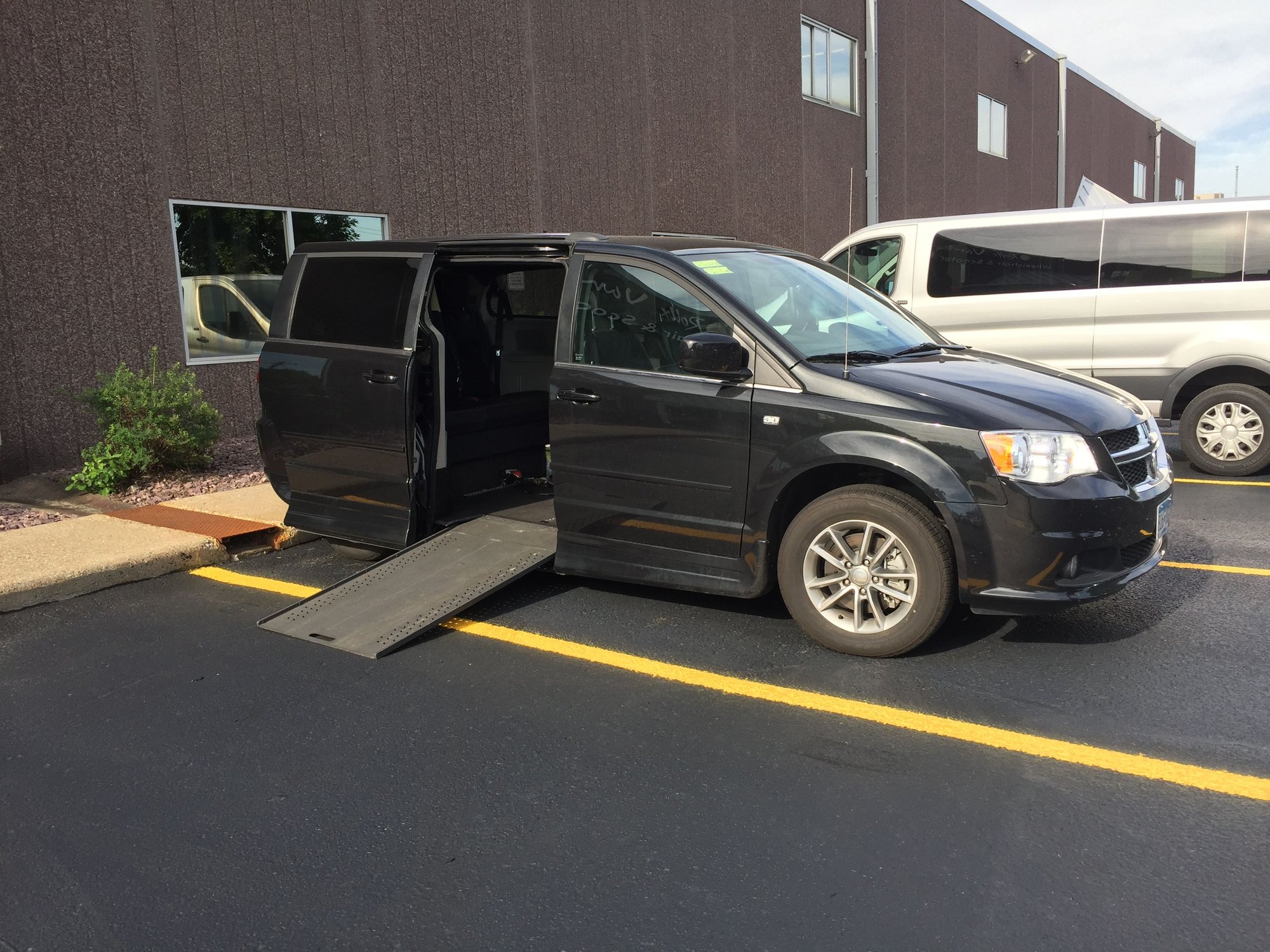

You're not kidding. They gave us a loaner minivan for the time they had our van in the shop, and it was enough to knock that idea out of my head for good. Payload was 950 lbs, so with three adults and Hannah we were overweight. With just Hannah, her chair, and her two siblings the rear axle was riding on the stops which made for the worst riding van I've ever driven. Handling was also kind of scary when loaded up...I had to swerve when someone almost pulled out in front of us. Had he gone for it we would have rolled a dozen times. I appreciate the convenience, but a converted minivan sure isn't for us! Here's the one we were driving...it was almost brand-new with 8,500 miles on the clock.
