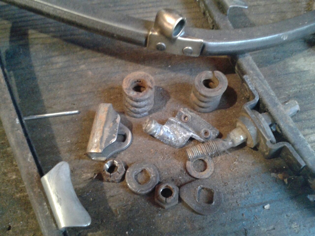

Here is a pic of what I have left over. I have enough parts to build one bottom, but I dont have the "T" looking piece that attaches to the vent window then goes down through the frame that the spring and stuff assembles on. I'll clean this stuff up and send it to you if you need it.
Mike

Man that old truck looks good Billy. Very nice. I'm working on a 49 f1. I know what you mean about fun and frustrating. I'm learning as I go on a lot of this stuff. Glad FTE is here for the help.

It looks like I could make something happen with those parts. That lower pin is the key. Let me know what ya need. Thanks ahead of time. I can already see I'm gonna spend way too much time on these forums!
