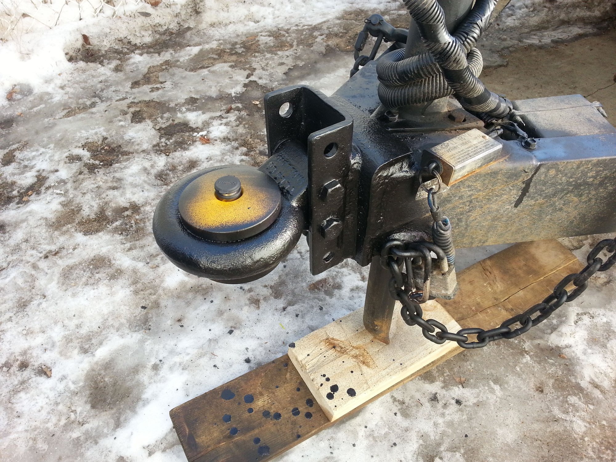

To "troverman"There is a very reputable lock & hitch lock company named Trimax and they make a very well made and very secure Pintle Lunette Ring lock which doesn't have a weakness such as a padlock being cut. This is a photo of mine on my pintle hitch trailer. What's really nice is it's solid steel, a 2 piece unit with a center pin and takes a square mouth key so a screw driver can't suffice in picking it open. And I totally agree with "speakerfritz" with the strength and integrity of the dual style pintle hitch. It literally doubles as two hitch styles in one, is rated for insane amounts of weight, can be adjusted to a proper ride height for different applications, as well as works great for a secure hook on point for a tow strap without the risk of it coming off during a pull out. It's the only hitch I have used and will probably ever use (unless I require stabilizer bars)
