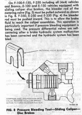

Okay.. I held the bleeder rod out and had my son-in-law hold the brake pedal in. I definitely got a few air bubbles out and took it for a test drive. The brakes are way better than they were, but it seems like the rear is still engaging before the front brakes. The brake light is still on also.
I read somewhere that if the rear drums are too loose (shoes are further away from the drums), it can actually cause the rears to engage before the fronts. Not sure if that's what I'm experiencing now. Especially since the brake light is still on.
Going to try and have my son-in-law help to bleed all 4 corners to see if I can get this thing going!

Yes bleed all 4 wheels with 2 people.
Also do it with the rod pulled out.
As for resetting the light, that valve moved to one side because lack of psi on one side. If you know what side it moved to take psi off the other,open bleeder, and hit the pedal using p s I to push it back to center.

Have you looked at the rear shoes? The should be perfectly dry and a little dusty if anything. If they have had any rearend oil or brake fluid touch them, even though you cleaned them up they will tend to lock up when you apply the brakes.
Reading between the lines about the bleeder pin, it looks to me they are saying if you get a bunch of air in ahead of the proportioning valve, there is a chance you will not be able to overcome the spring and bleed the front brakes. Never had that problem though. Obviously if you are getting fluid out of the front brakes while bleeding, you don't need the "tool".
