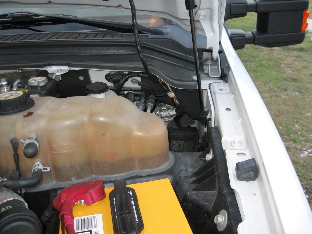

So installing some lights on my truck and went to wire up to the upfitter switch from under the hood. I found behind the fuse panel under the hood drivers side what I believe is the 4 wires. But they don't have the same color as what's in the manual as well as on their site. Figures, maybe they had a change and didn't update the manual. So I go and test for power to find non any info would be appreciated

Those wires only go through the firewall to be used for accessories as you noted. THEY are NOT connected to the fuse box under your driver's side dash. They too need to be connected to power up accesories.

So these wires go to the switch but the switch isn't powered? Or these are just a pass threw to get wire threw the firewall

From: Southern Cal
Yes.
Get under your dash and complete the circuit from the switch to the pass thru wires.

Thankyou r2millers this may be just what i needed. Either its not mentioned in the manual or i am blind as a bat and didnt see it. More likely the later of the two.. I'll post back when I get if together. Thanks again

The wires are near the steering column on my truck, not near the switch. They are also hard to get to, and are in a bundle with other wires. You may need to lie down and look up into the area above the steering column and find the 4 wires that are the same color as under the hood. For some reason, they made the wires short and hard to get to both inside the cabin and under the hood.
Some folks just run new wires through the rubber boot on the firewall to the engine compartment, which makes connecting them a lot easier.
4 wires under the dash near steering column - note the rubber tips
Driver's side of engine compartment near the firewall.
